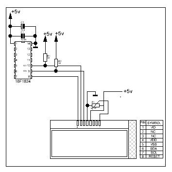

    I'm back with another problem. Its first time when I work with I2C .
    I have a 1x LCD with 8 pins, I suppose that have a controller ST7036i or ST7032i (pin2, pin3 = NC) and also I have a LCD with 7 pins , TM202SIFSUGWA with ST7036i controller(pin2 = NC) . I tried to display a text but I have nothing on LCD.
    I used this schematic:

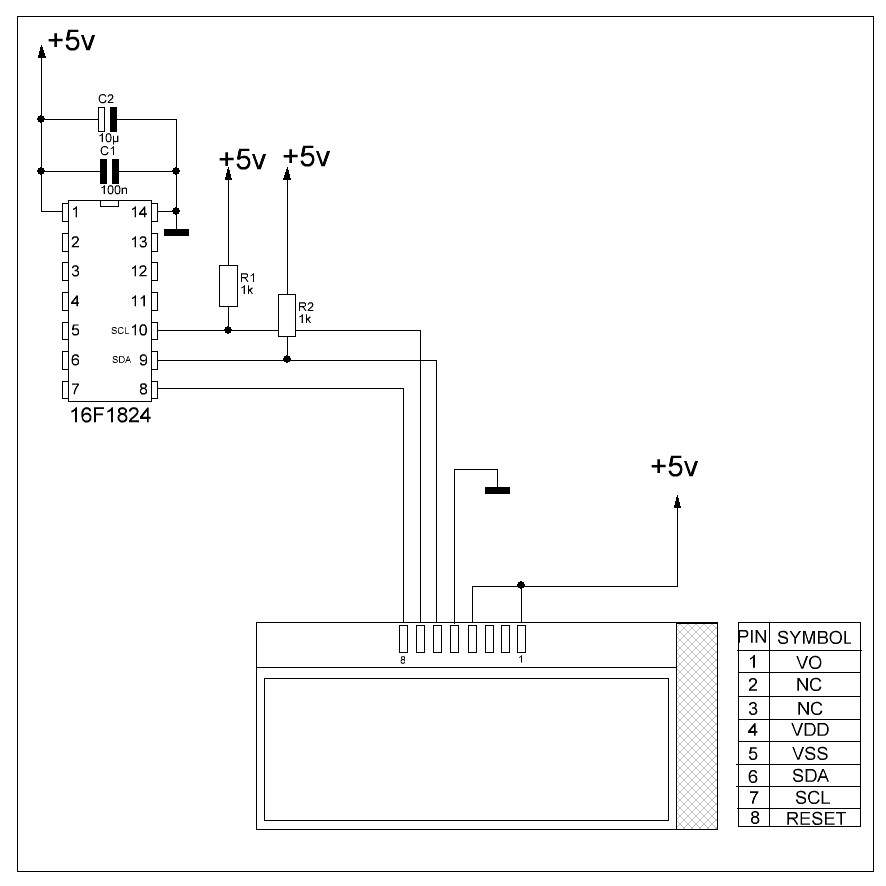

    Thx Robert for suggestion ..I tried like schematic, but nothing...
    A question : on this LCD type I must see a dots when I play cu variable resistor ? Or first time ,lcd must be initialized ?

    You can start by seeing the "squares" where the characters will appear darken. Once you get something going - adjust to taste.

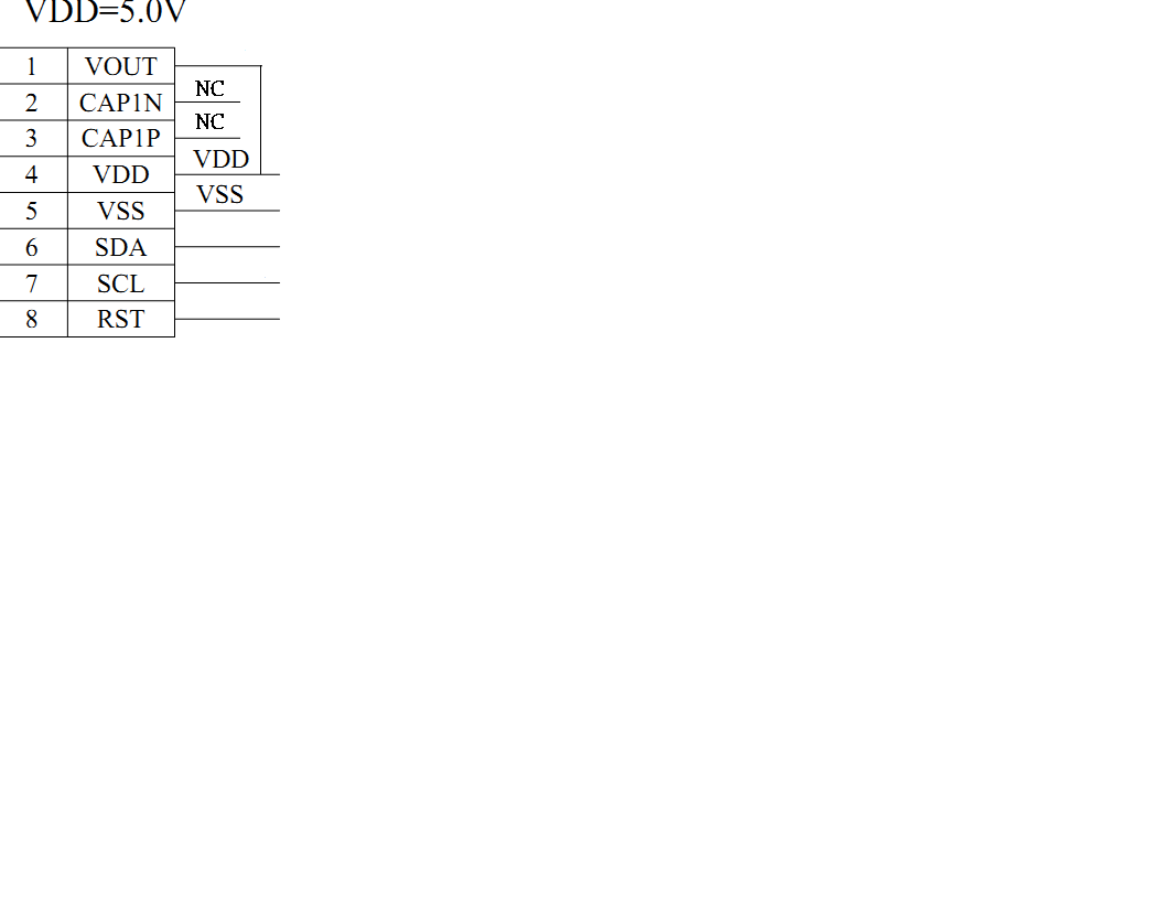

    Recently I found some information about ST7032, see atach. ST7032i_10.zip
    Here is a link with the same LCD ( I guess) http://www.farnell.com/datasheets/1669635.pdf

    I measured on working original board with ST7036i controller , 5V Vdd :
    V0 pin = 3,82V (voltage from a divider with 2 resistors)
    SDA = 150 ohm resistor between PIC pin and SDA LCD pin
    SCL = to PIC pin
    SDA and SCL = 1k to 5V
    RESET = to PIC pin and 1nF capacitor to GND
    RESET pin is all time to HIGH
    A question : SDA and SCL pins from LCD must connect with SDA and SCL pins from PIC or I can connect to any pins pic ?

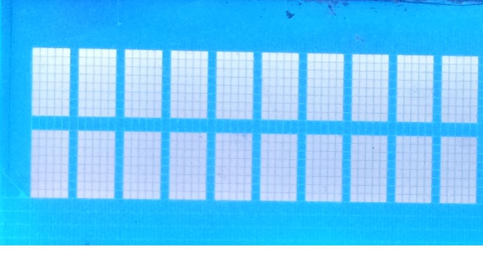

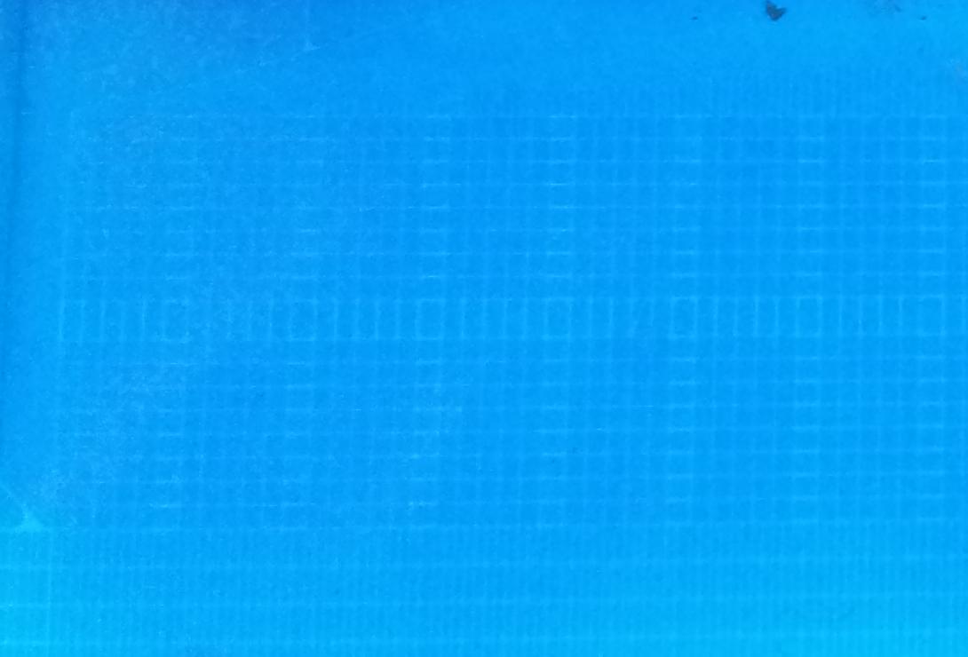

    Can you include a high res picture of your display?

    if I write the PIC and turn ON the board with Vcc = 3,6V I see on LCD this:
    ...then I move the Vcc to 5V, on LCD appear :
    In this case I can set a contrast from 5k potentiometer on V0 LCD pin, but I see only full dots.
    If I write the PIC and turn ON the board with Vcc = 5v, I see nothing on LCD. No effect if I down the voltage to 3,6V !
    Also change the address to $7C again according to the data sheet i found.
    I2C interface
    It just only could write Data or Instruction to ST7032 by the IIC Interface.
    It could not read Data or Instruction from ST7032 (except Acknowledge signal).
    SCL: serial clock input
    SDA: serial data input
    Slaver address could only set to 0111110, no other slaver address could be set
    I found this data sheet at http://www.farnell.com/datasheets/1669635.pdf
    The pinouts are the same as your display

    Gerogetown, Texas
    94
    Default Re: I2C LCD
    No problem, sorry it does not wok for you. Did you try 4.7K pullups?
    Take care
    Jan 2014
    84
    Default Re: I2C LCD
    Each time I verified with 4k7 and 1k. I made 2 different boards for tests.
    I found on market LCD with 7036i controller with own datasheet. I hope that in 2 weeks I'll receive it.
    Jan 2014
    84
    Default Re: I2C LCD
    I'm back after exactly 1 year.
    I changed the 16LF1824 with 16F1503 and now LCD is working !
    Many thx to Dave and Robert !
    Now I need again a your help. How i can display a variable ? (for example, x from my code )
    Working code:
