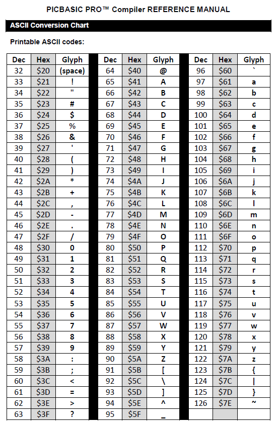

    A way forward is to use a bit pattern within a byte simply by indicating . as 0 and - as 1.
    this would make S 000 or the whole byte %00000000 which will not work but if we add a start bit 1 we get %00001000 or $08 in hex.
    and O would be 111 and with the start bit 1111 we get $00001111 or $0F
    and so on for all of the ASCII characters.
    One way to encode each character in a message is to use a lookup table using the ASCII decimal value.
    The first 32 characters are often ignored as they are not keyboard characters, with a few exceptions obviously.

    Default Re: Blinking LED will not Blink
    Quote Originally Posted by EarlyBird2 View Post
    ....A way forward is to use a bit pattern within a byte simply by indicating . as 0 and - as 1.
    ... we add a start bit 1 we get %00001000 or $08 in hex.
    Weird, I was sure morse was up to 3 characters, turns out it's up to 5 characters.
    I've tried all sorts of ways to try to store morse in as little space. Turns out the start bit technique is the best one yet.
    There's non-English code ś and special character $ here that can be up to 7 characters; so you could still fit that in 8 bits.
    http://en.wikipedia.org/wiki/Morse_code
    The only character I haven't figured how to store is prosign ERROR; 8 dots. I suppose that could be hard-coded?
