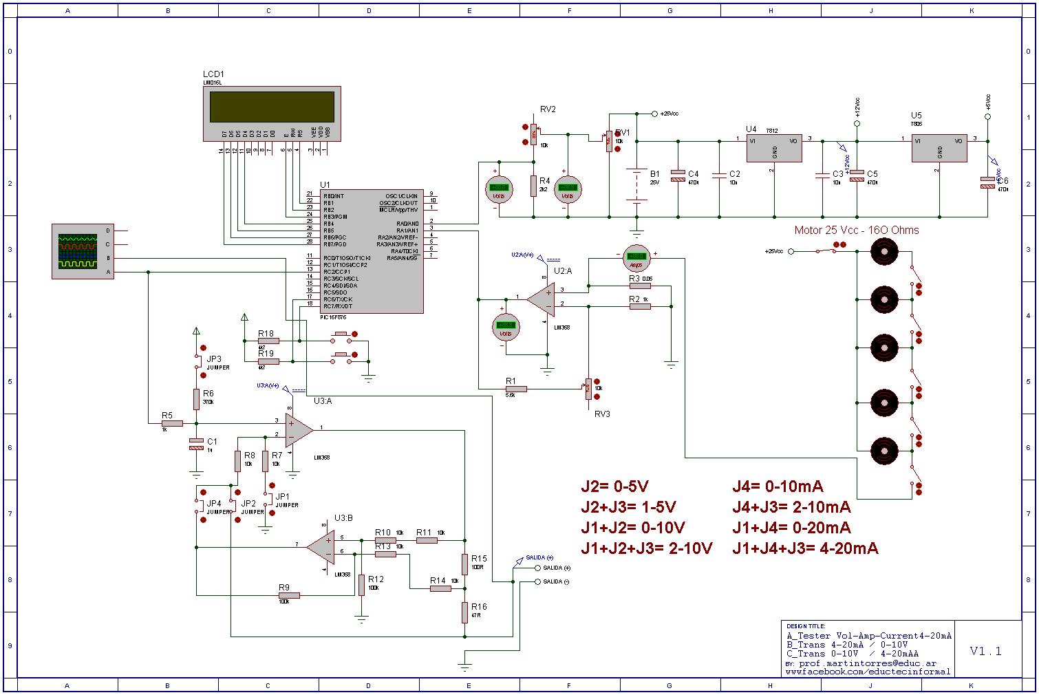

    thanks for the help; this is my project hardware (monitor voltage and current output proportional). The idea is to add the 0-5VDC output with pwm controlled to perform a transducer 0-5V / 0-10V / 0-10mA / 4-20mA configurable through jumpers ...

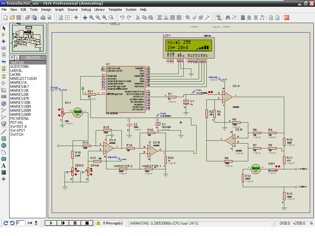

    well, succeed in making a mirror with the help of the LM358.
    Basically, what I do is with the first Ampop (12v source) is to convert the 4-20mA 0-5V input voltage ... that, I do mirror the output of a PWM pic and put it in a second Ampop (24v source) which transforms 0-5 in 4-20mA.

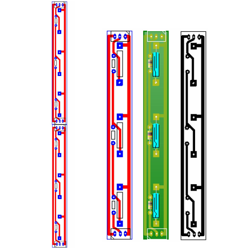

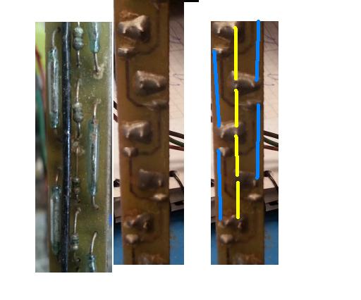

    While this project could be implemented to build a current source 4-20mA, the initial idea is to add it to a tank level sensor home made. ( The sensor consists of several magnetic sensors with 0 ohm resistors ... with a floating magnet, according to the water level switches enable me )
