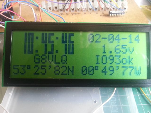

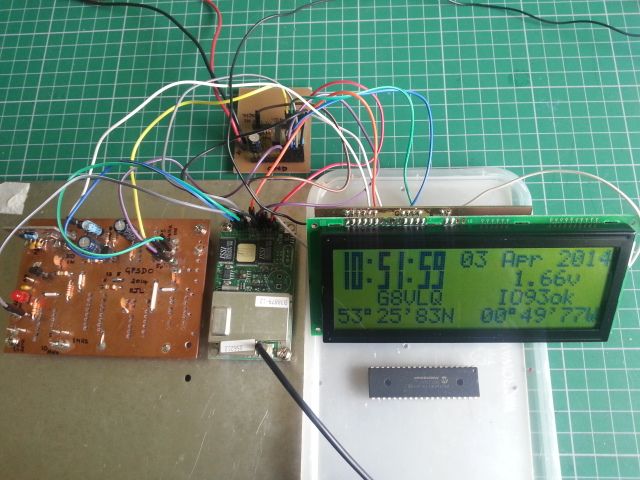

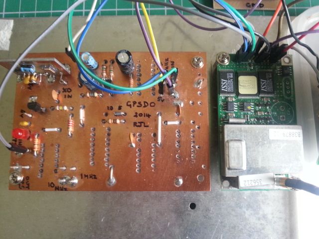

    Hi Andy,
    The project is already working, I just wanted more information displayed on LCD. The LCD board piggybacks the LCD display. It has a 16F818 which deals with the NMEA string and ADC functions.
    It's a GPS Disciplined Oscillator producing 10MHz to 10-12 signal. For accuracy of frequency and timing for MS and EME.
    It remains extremely stable but I am slightly improving it by logging the PLL control voltage and the TCXO temp swing.
    By logging I can get a mean control position for either start up purposes or short term 'dropout' from gps. Thus it will keep accuracy for short term outage. If the unit is turned off then on, I can apply the correct PLL control voltage until the gps locks again. Although watching the PLL voltage swing whilst trying to lock was fascinating.
    It also produces a very accurate 1PPS output. I later intend to use this to trigger the NMEA sentence display. You may be aware that the sentence suffers from lag or slight offset depending if the gps module decides to send another, other, information sentence. In my case at the moment it is 1.635 secs BEHIND actual time as my module occasionally sends out the powerID string which puts the timing RMC sentence out.
    I will be turning all off except the RMC sentence. At the moment it is testing phase.

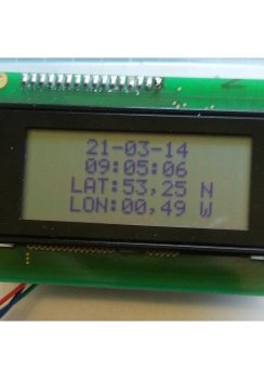

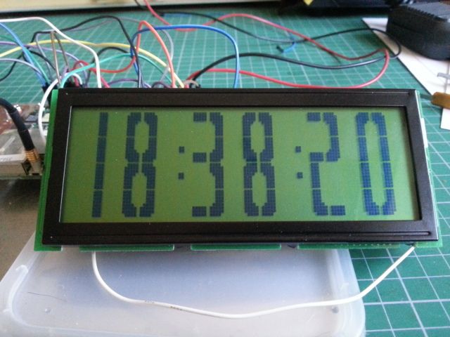

    Code is working at base level now and info is on screen, next is to incorporate the Locator code of yours.
    Rob.

    Default Re: How do I discern Maidenhead Locator from GPS lat long info.
    Awesome!
    Can't wait to see an IO93ok on that LCD.

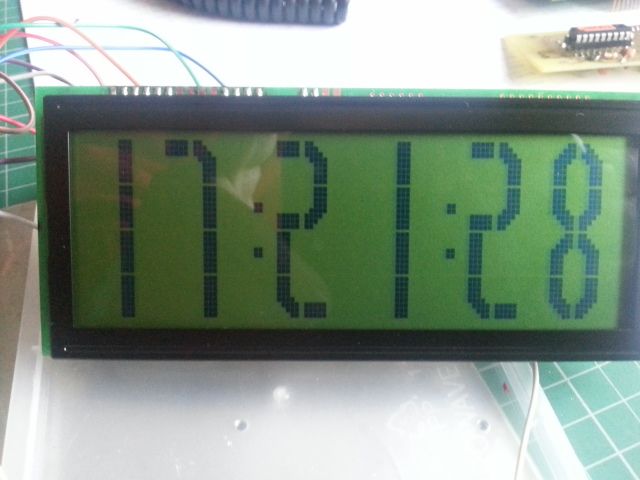

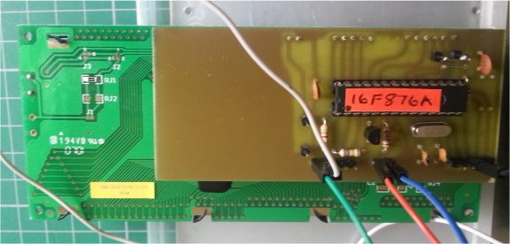

    Here you go Darrel -
    That display is huge at 4inch by 2 inch (See pic chip in background) Used a 16f876a in the end. That's your BigDigit code put to use as well.
    Display shows 1.65v which indicates to me that the oscillator control voltage is stable and in lock.
    Code needs some polishing especially Month but that's a work in progress :-

    Glad you like it Darrel. I'm very pleased with it. Any ideas very welcome.
    I have also coded a full digit clock over the four lines. At the moment it's a standalone code due to the character loading. Is it possible to load the second set of characters, replacing the original, on a button push ? Maybe using EXT ?
    The idea was to have dual display, button push changes from that shown in pic to a full clock and back again on another push.

    ' Program to display returned value of a GPS on RA4
    ' LCD in 4-BIT mode PIC16F876a controller 4Mhz clock Fuse PWRT BODEN
    'GPS sentence: $GPRMC,192144.62,A,5041.6058,N,00412.6124,E,0.45,3 57.74,081205,,*0B

    Clock:
                         ;Display time
    'Set up the digits (http://www.darreltaylor.com/files/CustChar.htm)
    LCDOUT  $FE,$40,$03,$03,$03,$03,$03,$03,$03,$03  ' Cust Char #0
    LCDOUT  $FE,$48,$1F,$1F,$1B,$1B,$1B,$1B,$1B,$1B  ' Cust Char #1
    LCDOUT  $FE,$50,$1F,$1F,$18,$18,$18,$18,$1F,$1F  ' Cust Char #2
    LCDOUT  $FE,$58,$03,$03,$03,$03,$03,$03,$1F,$1F  ' Cust Char #3
    LCDOUT  $FE,$60,$1F,$1F,$1B,$1B,$1B,$1B,$1F,$1F  ' Cust Char #4
    LCDOUT  $FE,$68,$1B,$1B,$1B,$1B,$1B,$1B,$1F,$1F  ' Cust Char #5
    LCDOUT  $FE,$70,$1F,$1F,$03,$03,$03,$03,$1F,$1F  ' Cust Char #6
    LCDOUT  $FE,$78,$1F,$1F,$03,$03,$03,$03,$03,$03  ' Cust Char #7
        nDig=hh dig 1 : nPos=0 : gosub displaydigit
        nDig=hh dig 0 : nPos=1 : gosub displaydigit
          npos=2 : gosub colon
        ndig=mm dig 1 : npos=3 : gosub displaydigit
        ndig=mm dig 0 : npos=4 : gosub displaydigit
          npos=5 : gosub colon
        ndig=ss dig 1 : npos=6 : gosub displaydigit
        ndig=ss dig 0 : npos=7 : gosub displaydigit
    LCDOut $fe,$c0+9,"    ",#volt, ".", # voltd1,# voltd2,"v"
    LCDOUT $fe,$94,"   G8VLQ    ",STR MH\6
    LCDOut $fe,$d4,DEC2 latdeg,$DF,DEC2 latmin,"'",DEC2 latsecs,NS,"  ",DEC2 londeg,$DF,DEC2 lonmin,"'",DEC2 lonsecs,EW                           ; ,#volt, ".", # voltd1,# voltd2,"v"   ; d4 4th line

    LCDOUT  $FE,$40,$07,$07,$07,$07,$07,$07,$07,$07  ' Cust Char #0
    LCDOUT  $FE,$48,$1C,$1C,$1C,$1C,$1C,$1C,$1C,$1C  ' Cust Char #1
    LCDOUT  $FE,$50,$03,$07,$0F,$1E,$1C,$1C,$1C,$1C  ' Cust Char #2
    LCDOUT  $FE,$58,$18,$1C,$1E,$0F,$07,$07,$07,$07  ' Cust Char #3
    LCDOUT  $FE,$60,$1C,$1C,$1C,$1C,$1E,$0F,$07,$03  ' Cust Char #4
    LCDOUT  $FE,$68,$07,$07,$07,$07,$0F,$1E,$1C,$18  ' Cust Char #5
    LCDOUT  $FE,$70,$1F,$1F,$1F,$00,$00,$00,$00,$00  ' Cust Char #6
    LCDOUT  $FE,$78,$00,$00,$00,$00,$00,$1F,$1F,$1F  ' Cust Char #7
    BUTTON Pbutton,0,100,0,butt,1,ClockClear
                         ;Display time
        nDig=hh dig 1 : nPos=0 : gosub displaydigit1
        nDig=hh dig 0 : nPos=3 : gosub displaydigit1
          npos=6 : gosub colon1
        ndig=mm dig 1 : npos=7 : gosub displaydigit1
        ndig=mm dig 0 : npos=10 : gosub displaydigit1
          npos=13 : gosub colon1
        ndig=ss dig 1 : npos=14 : gosub displaydigit1
        ndig=ss dig 0 : npos=17 : gosub displaydigit1
    GOTO GPS
    displaydigit1:
    if ndig=0 then gosub Zero1
    if ndig=1 then gosub One1
    if ndig=2 then gosub Two1
    if ndig=3 then gosub Three1
    if ndig=4 then gosub Four1
    if ndig=5 then gosub Five1
    if ndig=6 then gosub Six1
    if ndig=7 then gosub Seven1
    if ndig=8 then gosub Eight1
    if ndig=9 then gosub Nine1
    Zero1:
    	LCDOUT $FE,$80+nPos,2
        LCDOUT $FE,$81+nPos,3
    	LCDOUT $FE,$C0+nPos,1
        LCDOUT $FE,$C1+nPos,0
    	LCDOUT $FE,$94+nPos,1
        LCDOUT $FE,$95+nPos,0
    	LCDOUT $FE,$D4+nPos,4
        LCDOUT $FE,$D5+nPos,5
    One1:
        LCDOUT $FE,$80+nPos," "
    	LCDOUT $FE,$81+nPos,0
    	LCDOUT $FE,$C0+nPos," "
    	LCDOUT $FE,$94+nPos," "
    	LCDOUT $FE,$D4+nPos," "
    	LCDOUT $FE,$D5+nPos,0
    Two1:
    	LCDOUT $FE,$80+nPos,6
    	LCDOUT $FE,$C0+nPos,7
    	LCDOUT $FE,$C1+nPos,5
    	LCDOUT $FE,$95+nPos," "
    	LCDOUT $FE,$D5+nPos,7
    Three1:
    	LCDOUT $FE,$95+nPos,3
    	LCDOUT $FE,$D4+nPos,7
    Four1:
        LCDOUT $FE,$80+nPos,1
    	LCDOUT $FE,$81+nPos," "
    	LCDOUT $FE,$C0+nPos,4
    	LCDOUT $FE,$C1+nPos,7
    	LCDOUT $FE,$95+nPos,1
    	LCDOUT $FE,$D5+nPos,1
    Five1:
    	LCDOUT $FE,$81+nPos,6
    	LCDOUT $FE,$C1+nPos," "
    	LCDOUT $FE,$94+nPos,6
    Six1:
    	LCDOUT $FE,$94+nPos,2
    Seven1:
    Eight1:
    Nine1:
    colon1:
        LCDOUT $FE,$C0+nPos,$A5
        LCDOUT $FE,$94+nPos,$A5

    Complete working prototype system
    Rockwell GPS Module on right. PLL and TCXO board on left. TCXO is small vertical board top left. Small board at top with all wires is 7805 5v reg board.

    Rear of LCD showing piggyback decoder.

    Darrel,
    Don't know if you are still reading this thread.
    I wondered how difficult it would be to add the final two numerical digits of the locator so that it is the full 8 digit string.
    I nearly destroyed the prototype when I took it out in the car to test the locator code. The car voltage meant the regulator board became really hot, I was afraid it would fail.
    Rob.
    The moment after you press "Post" is the moment you actually see the typso
    The code was based on the pearl script on the Wikipedia page, which only shows how to get 6 digits.
    Do you know of somewhere that shows how to get the last two digits?
    Dec 2011
    IO93ok
    190
    Surprisingly I do have it in asm if that helps. I think this is the applicable code after GPS string is parsed. Loc 1 to 8 are the Maidenhead.
    I wanted it all in PBP so I could do what I wanted to achieve. The final two are numeric digits. Mine is 03 if that helps re the original code.

    I have made a separate switchable sub for the Big Digit clock which just uses the h, m, s, part of the gps string called alone.
    Pic of result. As near accurate to second as code allows.
    Rob.
