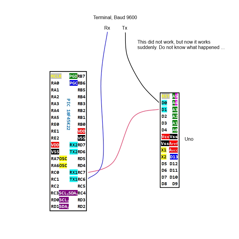

    Default Re: Serial: PIC18F45K22 -> (Arduino) Uno = works | Uno -> PIC18F45K22 = fails Why
    Are you able to communicate with your PC?
    The problem can be at either ends. It would help to know if the data is sent properly so you can concentrate on the culprit.
    Check your PBP manual on how to set up the link, or search here.

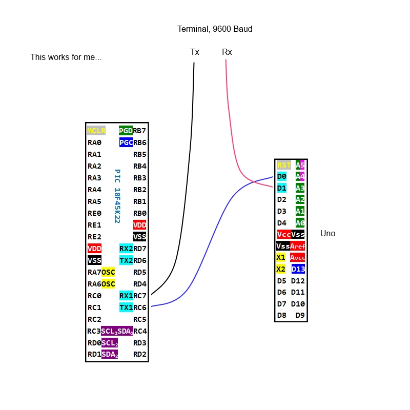

    Hi All
    All right. Thanks for the response.
    It's a bit embarrassing and I'm pretty confused for a sudden does it all as it should without I know what caused it. It's very simple setup but for several days it has teased me.
    Test set-up:
    Name:  PIC to Arduino.jpg
Size:  135.0 KBName:  Arduino to PIC.jpg
