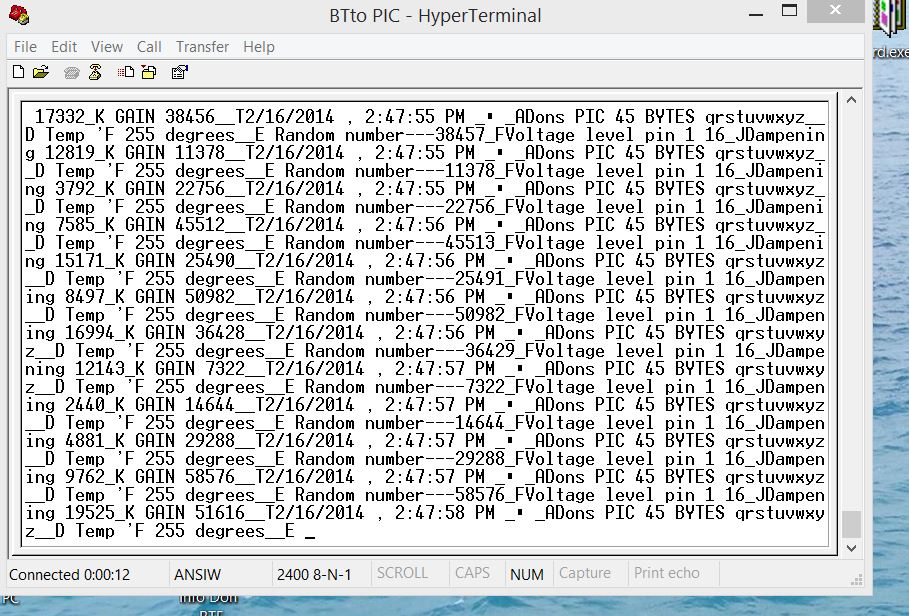

    OK then, I have a Blue Tooth (BT) module (from a few years back) sending serial data that is spit out from my PIC continually @56khz. Now on older pc's I used a BT dongle and my windows8 pc has BT in it already. So you use the SPP.......'serial port profile' on pc which just makes a faux port....(kind of software type port) that shows up in ports available in your VB.....consider VB.net free in visual studio from Microsoft.
    And I recently tried an app on my android phone that could also see the data over BT utilizing SPP.
    following is hyper-term displaying continuous data over BT, the port is the added port but the baud doesn't seem to matter because it still comes in at different settings !
    don

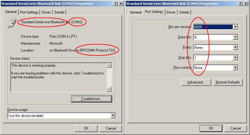

    Default Re: Inventory System
    Did that tweak, no difference.
    At least I know the COM2 properties. Hadn't noticed RFCOMM earlier.
    Name:  COM2 properties.JPG
    So if I read this right:
    https://developer.bluetooth.org/Tech...Pages/SPP.aspx
    RFCOMM is an adaption of RS232 via bluetooth. So I guess I can go back to MCcomm32.OCX module.
    I have no idea why I can't even get a few bytes of jibberish through a Terminal. The connection is complete, I can receive a file manually via the Bluetooth icon.

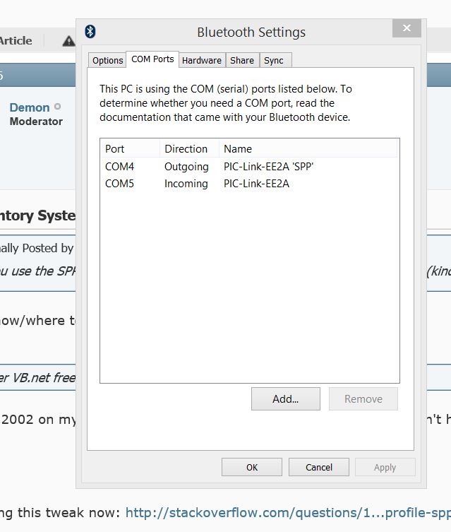

    the old BT stuff may be a little different from newer BT drivers.
    the driver picks its own ports.
    don
