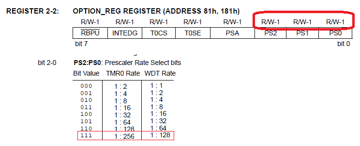

    'setup option register for TMR0
    option_reg.7 = 0
    option_reg.6 = 1     '1 for interrupts active
    option_reg.5 = 0
    option_reg.4 = 1     '1 for interrupts active
    option_reg.3 = 0     'Assign prescaller to TMR0
    option_reg.2 = 1     'prescaler 0-15
    option_reg.1 = 1     'with this setting TMRO-Rate = 1:256
    option_reg.0 = 1
    'Prescaller settings for option_reg
    'option_reg 01011000 = 1:1 prescaler TMR0 roles over every 1mSec
    'option_reg 01010000 = 1:2 prescaler TMR0 roles over every 152 uSec
    'option_reg 01010001 = 1:4 prescaler TMR0 roles over every 1mSec
    'option_reg 01010010 = 1:8 prescaler TMR0 roles over every 2mSec
    'option_reg 01010011 = 1:16 prescaler TMR0 roles over every 4mSec
    'option_reg 01010100 = 1:32 prescaler TMR0 roles over every 8mSec
    'option_reg 01010101 = 1:64 prescaler TMR0 roles over every 16mSec
    'option_reg 01010110 = 1:128 prescaler TMR0 roles over every 32mSec
    'option_reg 01010111 = 1:256 prescaler TMR0 roles over ever 64mSec

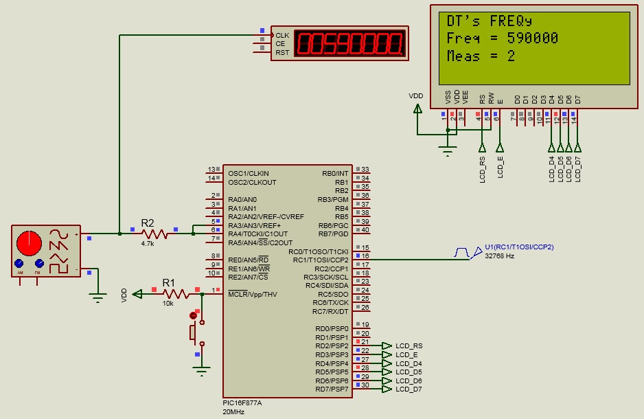

    The following PBP3 code is my first attempt at coding for a frequency counter that can read above 500khz...
    It does work, but its not accurate enough to be considered anything but educational or a fun project.
    Since it's not a problem for the PIC chip, or for PBP ...
    Will there be a Second Attempt?
    I'd hate to interfere with the learning process.
    But I would suggest using the Timer0 input (T0CKI) for the frequency to be measured.
    The Timer0 prescaler has a minimum period of 20nS, which means it can take up to 50Mhz.
    Timer1 (T1CKI) can only take up to 1Mhz with a 4Mhz OSC, or 5Mhz with a 20Mhz OSC.
    Any frequency measurement requires an accurate "Time Base".
    And the easiest way to get that is to use a 32768 Hz crystal on the Timer1 oscillator.
    This way, Timer1 generates the 1 sec window, and Timer0 (and it's overflows) counts the frequency.
    It is a little tricky to read the Timer0 prescaler to get the lowest byte of the count though.
    The prescaler should be 1:256 (the default).
    Oh, and the PICs oscillator should be as fast as possible, so that the program can respond to the hardware flags, which have to be polled.
    The fastest oscillator for the 16F877A is 20 Mhz.
    A simulation works good up to 600Kz. Reading the exact Hz. (actual results will depend on the 32768 crystal tolerance)
    A real chip should go much higher, but the SIM crashes with the higher frequency.

    The simulator is Proteus VSM from Labcenter in the UK.
    It's a bit pricey, but does an amazing job. Couldn't do my job without it.
    And I just want to point out how I have RA3 and RA4 tied together in the above schematic.
    It's a very important part of making the freq. counter work.
    DT
    OK, I'll bite.... Are using RA3 to gate the signal for the T0CKI-pin, hence the seriesresistor on the input?
    Jul 2003
    Colorado Springs
    4,959
    Default Re: Counting Timer0 and Timer1 overflows without any interrupt handler
    The two pins tied together (and the resistor) serve two purposes.
    1. You're right Henrik, since Timer0 on 16F's can't be stopped and started like all the other timers, it's used to gate the incoming signal.
    2. You can't directly read the value in Timer0's prescaler. So after counting pulses for the 1 sec. window, you have to provide additional pulses to the input until the value in TMR0 changes. The number of pulses you add tells you how many counts were already in the prescaler. This gives the low Byte of the final 32-bit value.

    But since I added the Timer0 register settings, it appears that I can't shut off the Timer1 overflow no matter what I do. Its supposed to display the timer0 overflow count and then go into a forever loop. But it keeps popping back up to "Display_Results". So I suspect timer1 is still initiating the interrupt routine.

    OPTION_REG = %10100111   'bit 7 pullups disabled
                             'bit 6 don't care
                             'bit 5 Transition on TOCKI pin
                             'bit 4 Increment on low to high TOCKI pin
                             'bit 3 Prescaller assigned to TIMER0
                             'bit 2-0 Prescaller setting 1:256

    I think I'll just post my code for the 877A simulation in post #5.
    Hopefully you can convert it for your needs with a different PIC.
    ; DT_FREQy.pbp
    ; Created     : Mon Feb 3 2014
    ; Processor   : PIC16F877A
    ; Compiler    : PicBasic Pro 3.0
    ;----[Device Configuration]--(See manual section 4.9)---------------------------
    #CONFIG
      __config  _HS_OSC & _WDT_OFF & _PWRTE_OFF & _BODEN_OFF & _LVP_OFF & _CPD_OFF & _WRT_OFF & _DEBUG_OFF & _CP_OFF
    #ENDCONFIG
    ;----[DEFINEs]------------------------------------------------------------------
    DEFINE OSC 20
    DEFINE LCD_DREG PORTD         ; LCD data port
    DEFINE LCD_DBIT 4             ; LCD data starting bit 0 or 4
    DEFINE LCD_RSREG PORTD        ; LCD register select port
    DEFINE LCD_RSBIT 2            ; LCD register select bit
    DEFINE LCD_EREG PORTD         ; LCD enable port
    DEFINE LCD_EBIT 3             ; LCD enable bit
    DEFINE LCD_BITS 4             ; LCD bus size 4 or 8
    DEFINE LCD_LINES 2            ; LCD Number lines on LCD
    DEFINE LCD_COMMANDUS 2000     ; LCD Command delay time in us
    DEFINE LCD_DATAUS 50          ; LCD Data delay time in us
    ;----[Aliases]------------------------------------------------------------------
    Timer1    VAR WORD EXT : @Timer1 = TMR1L
    TMR0IF    VAR INTCON.2
    TMR0CS    VAR OPTION_REG.5
    TMR1IF    VAR PIR1.0
    TMR1CS    VAR T1CON.1         ; Timer1 Clock Source Select bit
    T1OSCEN   VAR T1CON.3         ; Timer1 Oscillator Enable Control bit
    TMR1ON    VAR T1CON.0         ; Timer1 On bit
    T1OSI     VAR PORTC.1         ; 32768 Hz input pin
    PSCLKOUT  VAR PORTA.3         ; pin to clock out the remaining prescaler
    PSA       VAR OPTION_REG.3    ; Prescaler Assignment bit
    ;----[Variables]----------------------------------------------------------------
    Result     VAR WORD[2]        ; Final 32-bit Frequency measurement
    T0overflow VAR Result[1]      ; Counts Timer0 overflows (HighWord of the result)
    T0value    VAR Result.BYTE1   ; Final Timer0 value
    PScount    VAR Result.BYTE0   ; Final Timer0 Prescaler value
    FreqHigh   VAR WORD           ; Top five digits of the decimal result
    FreqLow    VAR WORD           ; Bottom 3 digits of the decimal result
    MeasCount  VAR WORD           ; Counts number of measurements
    ;----[Initialize]---------------------------------------------------------------
    ADCON1 = 7                    ; All Digital
    CMCON  = 7
    T1OSCEN = 1                   ; Start Timer1 oscillator
    PAUSE 250                     ; LCD Power-Up delay
    LCDOUT $FE,1,"DT's FREQy"
    MeasCount = 0                 ; clear the measurement count
    ;----[Main Program Loop]--------------------------------------------------------
        GOSUB MeasureFreq         ; Get a Frequency Measurement
        GOSUB DisplayFreq         ; Display the Frequency
        MeasCount = MeasCount + 1 ; increment and display measurement count
        LCDOUT $FE,$94,"Meas = ", DEC MeasCount
    GOTO Main
    ;----[Measure frequency on T0CKI]-----------------------------------------------
    MeasureFreq:
        LOW PSCLKOUT          ; prevent signal from getting to Timer0
        PSA = 0               ; Prescaler is assigned to the Timer0 module
        TMR0CS = 1            ; Transition on T0CKI pin
        TMR1CS = 1            ; Timer1 Clock source = T1CKI (T1OSC)
        TMR1ON = 0            ; Stop Timer1
        TMR0IF = 0            ; Clear Timer0 overflow flag
        T0overflow = 0        ; Clear Timer0 overflow count
        TMR0 = 0              ; Clear Timer0 value
        Timer1 = $FFFF        ; Timer1 overflows on next cycle of 32768 Hz clock
        TMR1IF = 0            ; Clear Timer1 overflow flag
        TMR1ON = 1            ; Start Timer1 1 sec. period
        WHILE !TMR1IF : WEND  ; Synchronize to 32768 clock
        INPUT PSCLKOUT        ; Start counting freq input
        Timer1.15 = 1         ; Set Timer1 to 32768 for 1 Sec. period
        WHILE !TMR1IF         ; while 1 sec. window is open  ---|
            IF TMR0IF THEN    ; count TMR0 overflows            | This section
                T0overflow = T0overflow + 1  ;                  | does the actual
                TMR0IF = 0                   ;                  | 1-Sec measurement
            ENDIF                            ;                  | Window
        WEND                                 ;               ---|
        LOW PSCLKOUT           ; Stop further counting
        T0value = TMR0         ; get Timer0 value
        PScount = 0            ; Clock out remaining prescaler
        WHILE TMR0 = T0value   ; until TMR0 value changes
            HIGH PSCLKOUT
            PAUSEUS 3
            LOW PSCLKOUT
            PAUSEUS 3
            PScount = PScount + 1
        WEND
        PScount = -PScount     ; negate to get prescaler count
    RETURN
    ;----[Display frequency on LCD]-------------------------------------------------
    DisplayFreq
        R2 = Result            ; Load Result into PBP's system vars for DIV32
        R0 = Result[1]
        FreqHigh = DIV32 1000  ; get left most 5 digits
        FreqLow = R2           ; remainder (R2) is right 3 digits
        LCDOUT $FE,$C0,"Freq = "
        IF FreqHigh > 0 THEN                        ; if any left digits
            LCDOUT DEC FreqHigh, DEC3 FreqLow,"   " ; display both left and right
        ELSE                                        ;  otherwise
            LCDOUT DEC FreqLow,"     "              ; display only right digits
    RETURN

    On power-up, the default value of OPTION_REG is %11111111.
    Which means the prescaler is already set to 1:256.
    There is no need to set it again in the code.
    DT
    3,516
    Hi Duane,
    If you look up OPTION_REG in the datasheet, you'll find that it defaults to "all ones", $FF, 255 whichever way you want to look at it.
    This means that the prescaler ratio, when assigned to TMR0 defaults to 1:256 - so no need to change it.
