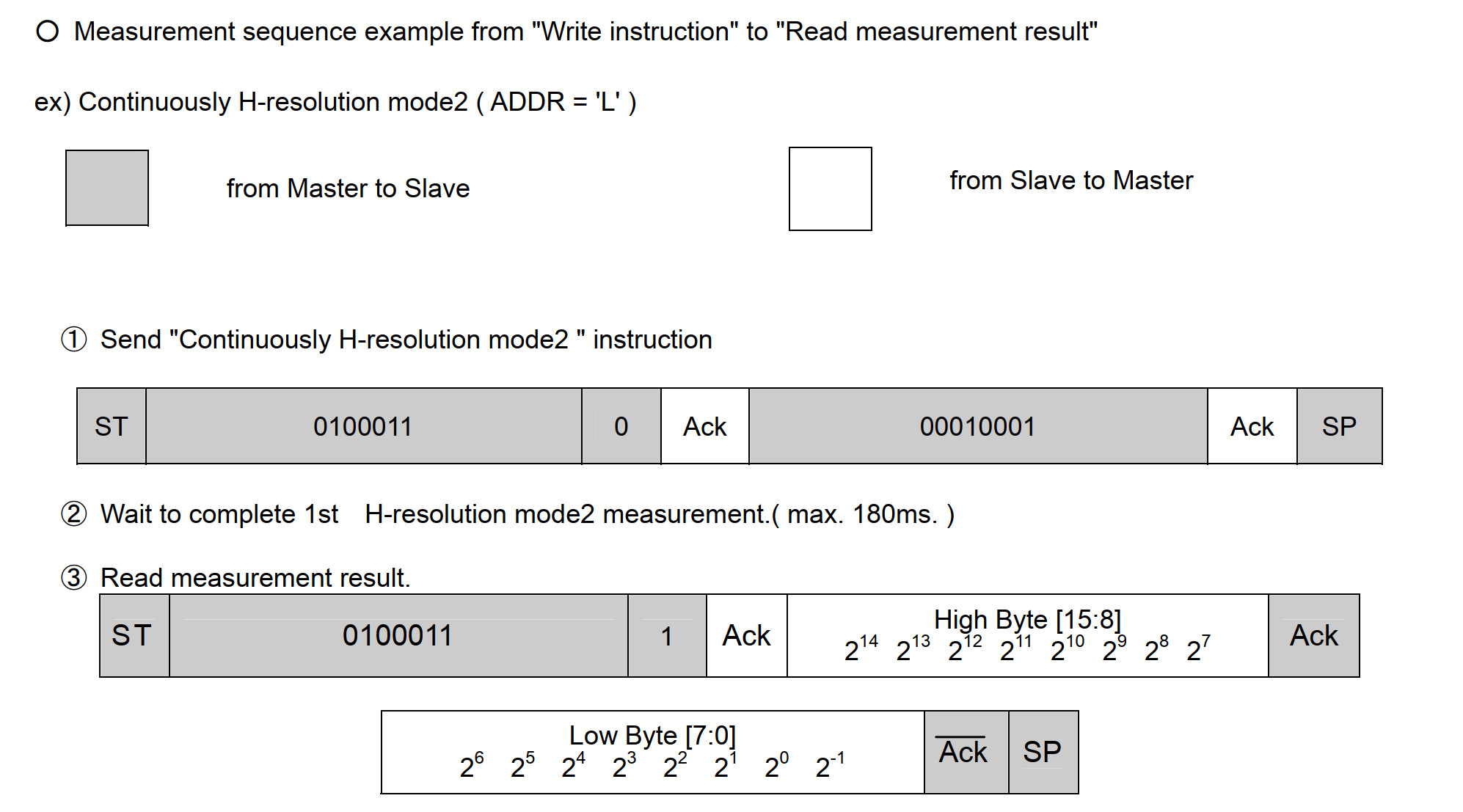

    8 years passed and now I'm giving it 2nd try, but it still does not works (returns 58317 constantly). Here's code:
    ldta  var porta.6
    lclk  var porta.3
    x var word
    adr var byte
    adr=23
    i2cwrite ldta, lclk, adr, %0100011
    pause 200
    i2cwrite ldta, lclk, adr, %00010001
    pause 200
    maik:
    i2cread ldta, lclk, adr, %0100011, x
    pause 200
    lcdout $fe, $1, dec x
    pause 200
    goto maik

    Here's screenshot from datasheet, based on which I wrote the above code.

    Default Re: BH1750FVI sample code available?
    1 - use the appropriate I2C address for the device based on the hardware pin state
    2) Slave Address
    Slave Address is 2 types, it is determined by ADDR Terminal
    ADDR = ‘H’ ( ADDR ≧ 0.7VCC ) → “1011100“
    ADDR = 'L' ( ADDR ≦ 0.3VCC ) → “0100011“
    2 - the device address for case 1 is $B8 and case 2 is $46 (use one of these values in cnt)
    When you put the address as shown in your code, the leading bit is 0 and the address will be $5c or $23. This is definitely wrong.
    3 - cnt remains the same for I2CWrite and I2CRead. the least significant bit is changed internally by the compiler depending on whether the command is a read or write
