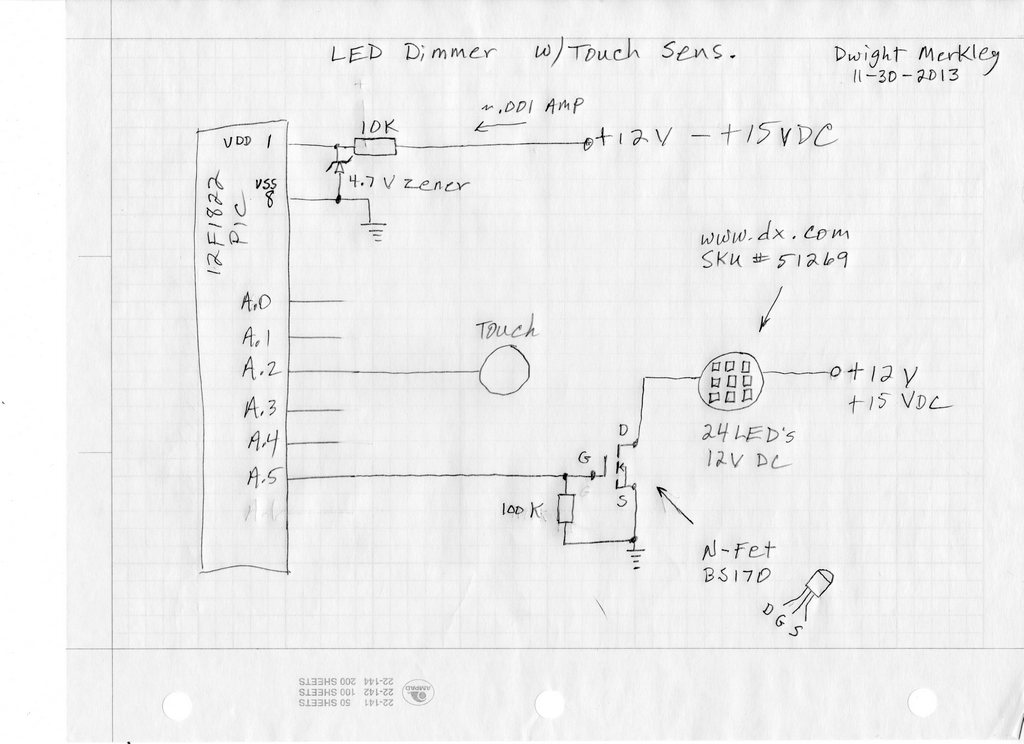

    Any way here is a little project I have wanted to do and CapSense seems to work and makes it a bit simpler.
    See attached schematic.
    This is the LED I am using... http://dx.com/p/g4-1-2w-108-lumen-35...b-dc-12v-51269
    Which makes use of Darrel's Instant Interrupts (thanks Darrel!). You will have to go get those include files from his web site dt.cambs.net
    enjoy! and tell me what you think (good or bad)

    Default Re: my project Capacitive Sensing LED dimmer 12F1822 via PWM
    I like your PIC power supply. What is the expected life of that zener? Little current = forever?
    I didn't know that zeners had a limited life span.
    One thing that did occur to me (during the night ) is that this type of power supply would limit the PIC's ability to provide a "high" output with any amount of current. So if you want to use those pins for something else you would want the active state to be a LOW or ground, or change the value of the 10K resistor to a lower value.
    I did measure the current draw at 0.9 ma.
    I designed this to specifically be an emergency light or camping light so I wanted the PIC to draw as little power as possible in the OFF state.
    With a 7 amp hour gel cell it should last quite a while drawing only 1ma.
    Dwight
    I don't know, that's why I'm asking. I've thought of this idea before but didn't know if it was reliable, or what the limitations were.
    I kept thinking it was too simple to be true and wondered why I didn't see anyone else doing it.
    What if you just used VDD (pin 1) as your source, couldn't you then do as you please with that "regulated" 5V?
    Edit: ok, I see where you're going. Even using a transistor on the pin, you're still limitted by what can pass through the resistor.
    What if you use a higher wattage resistor?
    Glue a heatsink on it.
    I would use LDO with low Iq, eg. tps709135
    And put pic in sleep, wake up with timer interrupt, do things, back to sleep...
    This way you can get average current very low, under 100uA.
    Oct 2009
    Utah, USA
    427
    Wow, I didn't know they made voltage regulators with that low of idle current.
    My intention was to be able to leave the ckt connected to a, say 7 Ah, gel cell battery for at least a few weeks.
    I will probably add to the circuit board a jumper or small switch to completely disconnect the ckt for storage. Even 1 ma will use up 8.76 Ah in a year. Probably not much more than the self discharge of the batt, though.
    For a hobbyist though the junk box is your friend. That regulator is a bit esoteric and the shipping cost would drive up the cost for just a few items.
    If you study Zener regulator ckts they are somewhat inneficient if your current needs vary by much. This ckt would get below 2 volt if the current draw gets over 1ma with a 12V source. Since my ckt pulls a bit less than that I am OK. Actually now that I look at it I may want to lower the 10K resistor to say a 5K or so. It's all just experimentation at this point.
    If one wants to be able to draw more current for the other PIC pin outputs then it quickly becomes necessary to use a lower value resistor.
    I'm sure a good electronics engineer could shred this idea for any kind of commercial application.
    Mostly I was determined to get the Cap Sense working and be able to evaluate its suitability for other applications.
    Sometimes I just enjoy the challenge of figuring out these Little PICS and what they are capable of. They truly are amazing what is in these little packages for such a few dollars.
    For example the APFCON register. It allows you to move the function of some of the PIC peripherals from one pin to another if needed!! (which I did need to do with the PWM from A.2 to A.5)
    Ok Demon,
    You got me thinking and as I did some more measuring I found that, with the 10K R, I had only 2 volts to the PIC. Which is ok but mabie a bit low. So I switched out the resistor to a 4.7 K and now I have 3.95V to the PIC and the current draw is 1.7ma (0.0017Amps)
    I used one of these... http://www.eevblog.com/projects/ucurrent/
    to measure the current
    The zener is probably still not working too hard to control the voltage yet (not sure how sharp the zener voltage point is)
    Any way I just wanted a simple way to power this ckt from the 12 to 15 Volt source battery.
    Dwight

    Dec 2010
    409
    This approach is often used as a voltage reference, but rarely as a power supply because it's very inefficient and has lots of other issues. You need to size the resistor so the voltage across it does not cause a troublesome dip in the VDD voltage at peak currents. Typically, you would need to have about 10x the current the PIC needs flowing all the time in the zener. A much more robust approach would be to put this circuit to the base of a NPN transistor, with the collector on the supply rail and the emitter on VDD. Then you can reduce the quiescent current consumed by roughly the gain of the transistor.
    Anyway, this circuit is fine for a demo or an application where there's lots of free current. Of course, every time the PIC takes a sip of current, noise is induced on VDD. Maybe it doesn't matter - but anything with an ADC using VDD as reference won't be happy. Note it will have a much better sense of humour with a big cap across the zener for those computational gulps of current. Of course, then it will come up slowly, which might cause other issues. In the end, a 3 terminal regulator is the easiest, and may even be the cheapest solution.
    @Acetronics2... great minds must think alike
    That's pretty much what I did.
    @Charlie... my design is specifically designed to run on battery power. The PIC current drain should not change by much. Unless one starts trying to supply current via other pins. That is why I would limit other pin outs to supplying ground when active. (I think this is correct, but I am open for debate)
    My intent was to specifically create a Camping/Emergency light that could be dimmed for maximum battery life. My crude measurements with the PWM output is that on low the current is around 1, 6, 25, 50, 100 milliamps respectivily with each of the 5 steps.
    I really was not going to do much, if anything, else with the other pins.
    In this case I think the current draw of the PIC should be quite stable and very low.
    If one starts doing other things with the other pins then all bets are off with the zener/resistor supply.
    And, hey, since I am a hobbiest it might be fun to let the smoke out of a PIC to learn a little. See how much abuse one of these little jems can take and keep on ticking. (evil grin)

    Just wondering if anybody has taken the time to bread board up the circuit and see how it works?
    If you do build the circuit I suggest you lower the value of the Resistor in the Zener ckt to around 4700 ohms.
    (Assuming you are trying to drive it with 12 Volts)
    I still need to learn about how to best design a small circuit board with an included touch pad. I still am unsure if I need a surrounding ground to make the touch sense work better.
    My testing shows that it does not seem to make much difference.

    Hi Dwight,
    Are you looking to make these Camping/Emergency lights as a commercial venture or just for your own use?
    If it is the latter, you would probably be best served (from a purist aspect) to throw a bit more coin at an LDO voltage regulator.
    From my own curiosity standpoint, what have you used for the capacitive touch sensor in your prototype and how do you plan to implement the sensor in your production unit?
    Respectfully, that's simply wrong. Every different instruction uses a slightly different amount of current. Those current changes result in noise. Put a cap across the zener to resolve it. And if minimal current is your objective, you are wasting more in the zener than is used in the PIC. Use a regulator and use the PIC sleep capability to get down to minimal current. If you are really interested in parts count, have a look at some of the other PIC devices. The 12HV615 for instance - I've used this as a touch dimmer for LED lighting - can run off of 12V directly (well, through a resistor) because it has an integrated regulator. The method it uses, though, does still waste a little current.

    @Barry... building this just for hobby fun. And always enjoy using something I build myself. Probably just build a few for myself. Possibly thinking of using it as I teach electronics to Boy Scouts for the electronics merit badge. The final requirement is for them to build a project.
    The touch sensor on my proto type is a bit of copper tape (Scotch #1245) stuck to my desk with regular scotch tape over the top as an insulator.
    In the final I envision a small ckt board, say 1" x 2" or so, with a "touch" area for the button.
    @Charlie... I did not know that there was an "HV" pic. Thats cool. Might have to take a look at getting a couple of samples.
    So regarding the noise... A small cap across the power input is probably a good idea. What problems might the noise cause? Intermittent operation? I took a look with an o-scope across the power input (vss, vdd) and didn't see what I thought was a lot of noise (lot is a relative term though)
    Yeah I am clear on the fact that a Zener supply is wastefull, but hey 2ma, though your point is well taken. I just don't have one of those LVD regulators on hand.
    Again, just an exercise in understanding how to set-up and use the cap sense and maybe come up with a little fun project.

    If you look at the datasheet for the 12f1822 you will see that only pins A.0, A.1, A.2 and A.4 have cap sense capability.
    You will have to work with those pins.
    Also, as Charlie and others have pointed out, I would not do the Zener regulator. It is inefficient and does not allow one to draw more or less current as your circuit might demand, at least not efficiently.
    The Zener regulator idea was a bad one... especially with the LDO regulators available for about the same cost and parts count.

    rather than confuse hecklers fine and working project why not start a new thread that reflects your project and hardware more closely
    say "using multi cap-sense inputs on a pic16f722a" .
    there are many issues with your code starting from the tmr0 setup (prescaler ?) to a 100mS delay in the isr that will interfere with key scanning to such an extent to make success unlikely.

    Okay. But if the timer0 source works for Heckler, why won't it work in mine? Everything seems to be working okay, except that I want it to be a single-shot occurrence on the 1/0 button, rather than a continuous loop, as it is for the up/down buttons. I thought the 100mS pause was the period that the count from timer 1 is occurring? Thanks. The reason I posted on Hecklers was because I was hoping to get some input from him.

    What is happening with CPSCON1 =CPSCON1 ^ 1? Is the THRESH a fixed value predetermined? Just wondering where the THRESH CON 4000 comes from. Thanks.
