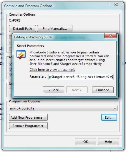

MicroCode Studio gives the option to configure the Programmer to pass certain parameters when the program is started. This one auto loads the mikroProg Suite with current selected PIC and compiled file then starts the Write process:
-p$target-device$ -f$long-hex-filename$-w
Name:  Compile-Program options.jpg

The only thing is, the mikroProg Suite application gets mad for a second and gives a quick warning when I Compile/Program when the application is already running.
So I just Compile with MCS, then hit the Reload HEX and Write buttons on the mikroProg since everything is already running.
