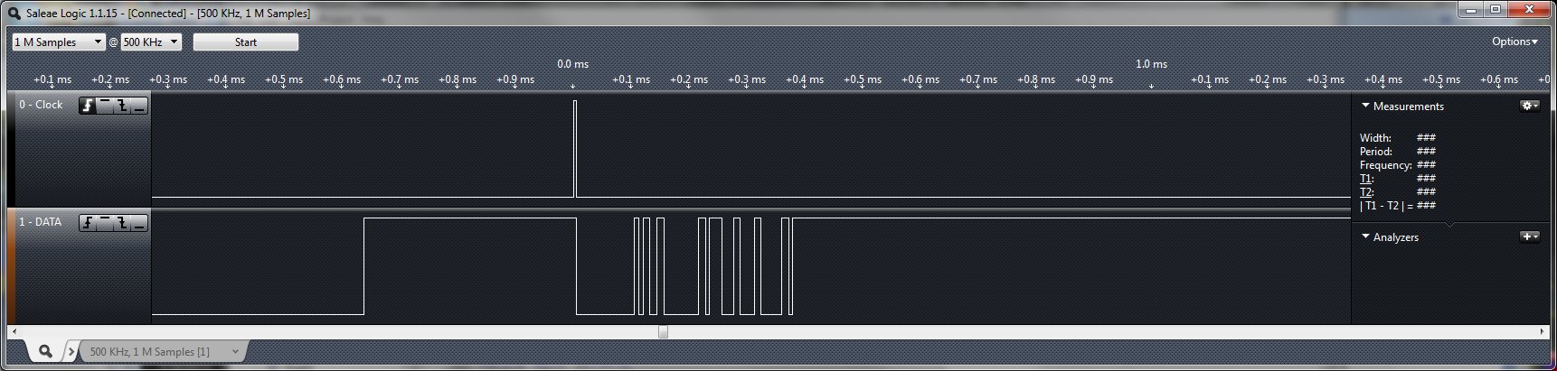

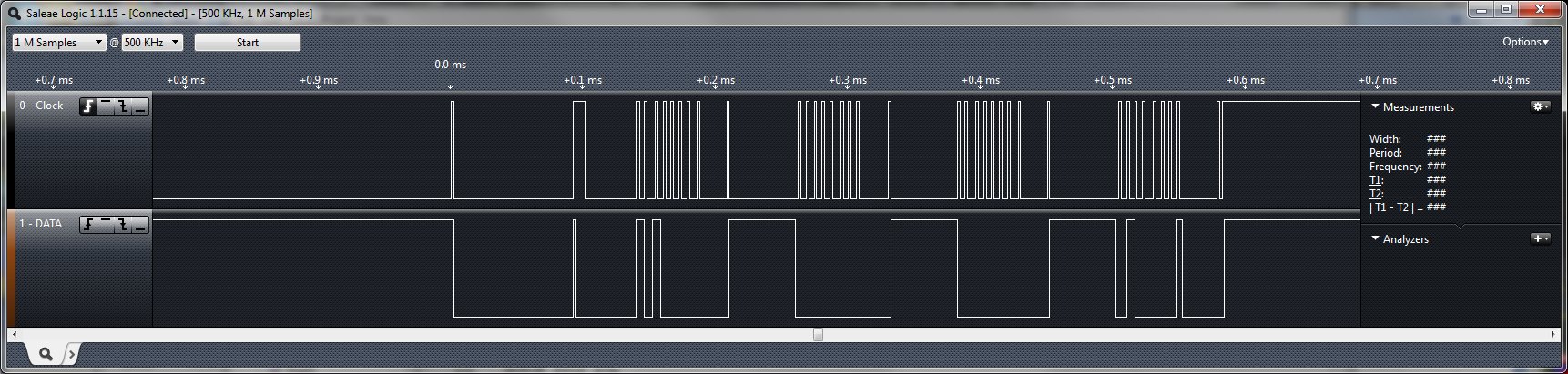

    Feb 2012
    64
    Default Re: Problem reading 24FC1025 EEPROM with 18f14k22
    Trying again to upload the analyzer screenshots:
    I2cWrite:
    Name:  I2CWrite Letter A to EEPROM.jpg
    Shiftout (Works):
    Name:  Shiftout Save Letter A to EEPROM.jpg

    I am running the Internal OSC at 16MHz. I did try slowing the clock down and it still didn't work. I am not sure if the Clock is whacked or if my Logic Analyzer is just too slow to capture it (500kHz is as fast as it will run on my computer for some reason).
    I am still leaning toward a bug in Picbasic Pro 2.60C (Not because it isn't working at all, but because the value being returned is directly related to to the binary value of the pin it is connected to). If I connect to pin ra.0 I get a return value of 1, ra.1 returns a value of 2, ra.2 = 4... This shouldn't be happening unless I either made some strange mistake with variable ussage, or if there is an internal bug in the compiler. I saw a similar wierd sort of incremental value on the 18f46k22 while reading ADC lines and it turnned out to be a bug in the complier (which got fixed with 2.60c).
