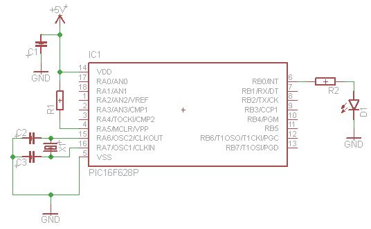

    Regarding the microbasic pro, I've downloaded the trial version, and reading manual right now. I also have K149-BC PIC programmer which works just fine. So I'll use them together, without using mikroe board.
    The software cames with sample led blink code. And it has some specific settings, which you need to uncomment, before compiling. But, since I want to use PIC16F628A, I need a different config settings, as I guess. I've checked relevant datasheet, and that code to be working, instead of ANSEL = %00000000 I should use TRISB = %00000000
    right?
    Also, I set oscillator to XT type in fuses config in programmer, to use internal osc.
    3,520
    Default Re: Moving from Basic Stamp and MIKROE basic to PicBasic PRO
    Agreed on dropping the MikroE discussion, there's nothing more to be gained from it.
    I've checked relevant datasheet, and that code to be working, instead of ANSEL = %00000000 I should use TRISB = %00000000 right?
    Not quite. ANSEL is a register which controls if the pins should be used for analog or digital. TRIS is the register controling the "direction" of the pins, when the pins are set to digital thru the ANSEL register... Makes sense?
    The 16F628A doesn't have an ADC so there will be no ANSEL register to set but it does have a comparator module which may need to be configured properly, see the CMCON register.
    Nope, if you set it to XT it expects an external x-tal.

    Ok, so, as I guess, the code now should look like this:
    Define OSC 4 ' 4MHz  'set internal osc to 4mhz
    CMCON=0  'turn comparator off
    VRCON=0 ' turn voltage reference off
    TRISB = %00000000  'set direction of port B pins
    LED    VAR  PORTB.0   ' Assign name "LED" to PORTB.0
    mainloop:
       High LED        ' Turn on LED connected to PORTB.0
       Pause 500       ' Delay for .5 seconds
       Low LED         ' Turn off LED connected to PORTB.0
       Goto mainloop   ' Go back to loop and blink LED forever
       End
    3,520
    Hi,
    That's a good start. Couple of notes:
    DEFINE OSC 4 does not SET the oscillator to 4Mhz it simply tells the compiler at what speed you INTEND to run the chip so it (the compiler) can calculate delay loops etc.
    CMCON = 0 does not turn off the comparator, look at the datasheet.

    Hi,
    I didn't have a 16F628A only a non A-version but I don't think the differences matters here (they are covered in Appendix C of the datasheet).
    First take a look at the schematic:
    With the above setup I wrote a short program, no more no less than:
      Toggle PortB.0
      Pause 250
    Goto Main
    I programmed the PIC and the LED blinked at 2Hz - it really can't get easier than that IMO and it certainly isn't harder than on a BasicStamp. It works because I built the hardware to match the default setup, ie using an external 4MHz x-tal.
    Next thing I did was open up the .info file for the device and copied the default configuration from where it says The PBP default configuration for the PIC16F628 is: and pasted that into my program. I then read thru the available options and decided that I want to use the internal oscillator without feeding the clock out and use internal MCLR so I changed my program to:
    #CONFIG
        __config _INTRC_OSC_NOCLKOUT & _WDT_ON & _PWRTE_ON & _MCLRE_OFF & _LVP_OFF & _CP_OFF
    #ENDCONFIG
      Toggle PortB.0
      Pause 250
    Goto Main
    I removed the pullup on MCLR and the x-tal, programmed the PIC and the LED blinked with a frequency of 2Hz - as expected. All I have on the breadboard is a bypass cap, a 16F628, a resistor and a LED.
