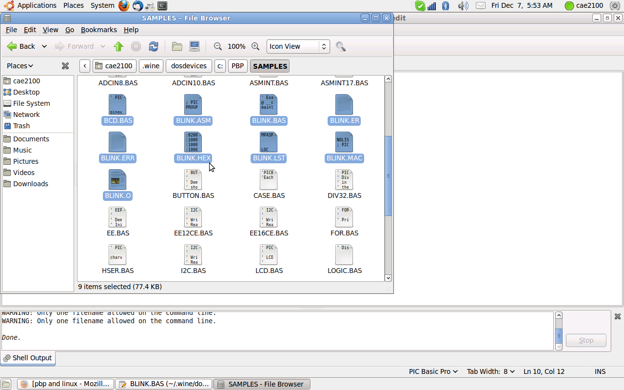

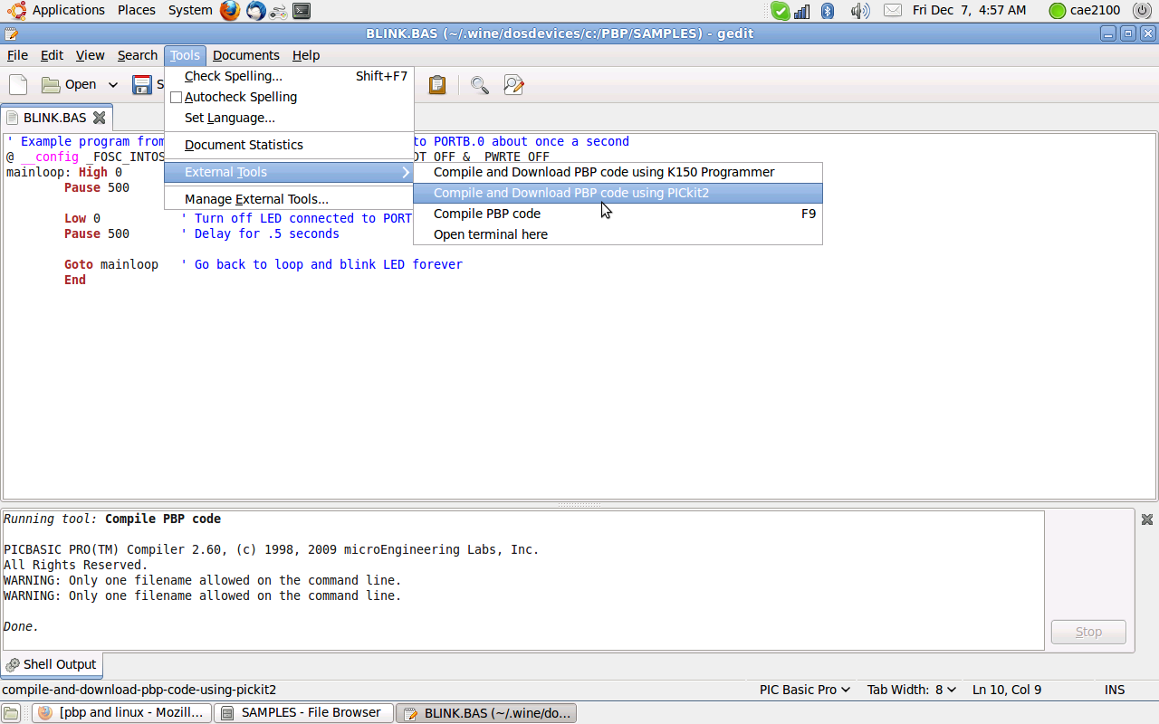

    for those that are curious about what Ive been working on actually does, this is two screenshots of the mods to gEdit.
    sorry again about the spam posts, and such large pictures.
    I'd like to get everyone's input on this to see what needs improved and such, or what needs changed.
    also, a little bug in the jdm programmer part, add "pic" just before the $pic on the bottom line so it shows pic$pic, then it'll work fine.

    yea, the tiles is what bugs me most. I think I rather just finish up my gedit mods and use that, pretty much every other programming language uses gEdit also in linux, so I might as well just add it in and get it working. makes it easier to do everything up in anyways. I always used gedit to mess with python stuff rather than IDLE because it starts faster and does the same thing more or less, also I end up usually just starting the programs from the command line with python. so gedit works better for me with that.
    also, Ive never used pbp3 because of the new keywords and such, also most of the code out there is still using pbp 2 for everything, so I just stick with my 2.6 version that I have. I know that the old code probably should work with the 3.x but why upgrade when you already have something that works good :P
    atm, as far as I can tell, everything works in gedit for compiling, code highlighting, and all of those features. The compiling and burning using pickit2 works too, Ive used it a few times to upload code to my robot. The only thing that isnt implemented yet is a chip selector, but anyone who programs stuff in linux and have gotten this far should probably be able to get back into external tool's manager, and just change the chip name there, where they added in the scripts. nothing too hard and it is changable, and quite easy at that imo.
    I know the scripts are in the ~/.gnome2/gedit/tools/ so it shouldn't be too hard to just write a program to be called up and modify that value in the code in those scripts.
    little by little, it'll get finished

    ok, went through and fine tuned everything with pickit2 part, just change it to this and it should work perfectly.
    #!/bin/sh
    pic="16f628a"
    wine c:/pbp/pbpw -e -s -ac:/Program Files/Microchip/MPASM Suite/MPASMWIN -p$pic $GEDIT_CURRENT_DOCUMENT_NAME
    var=$GEDIT_CURRENT_DOCUMENT_NAME
    var2=${var%???}
    outasm=$var2"ASM"
    wine c:/Program\ Files/Microchip/MPASM\ Suite/mpasmwin /q /e /l $outasm
    outhex=${var2}"HEX"
    pk2cmd -B/usr/share/pk2/ -PPIC$pic -F$outhex -M -R
    I just wrote some code to my robot a few mins using this and the pickit2, so I know it works fine now. found out I needed to include the device file path and PIC to -PPIC$pic part.
    here's the updated JDM part too:
    #!/bin/sh
    comport="/dev/ttyS0"
    pic="16f628a"
    var2=${var%???}
    outasm=$var2"ASM"
    outhex=${var2}"HEX"
    picprog --erase --burn --input $outhex --device pic$pic --p $comport
    also, here's the new and easier version of compile pbp code command.
    #!/bin/sh
    pic="16f628a"
    var2=${var%???}
    outasm=$var2"ASM"
    in both of these, just change the 16f628a in the quotation marks at the top to change the chip, it's as simple as that now.
    sorry about the mixup, had to reinstall linux on here a few days ago, so had to work out all of the little bugs
