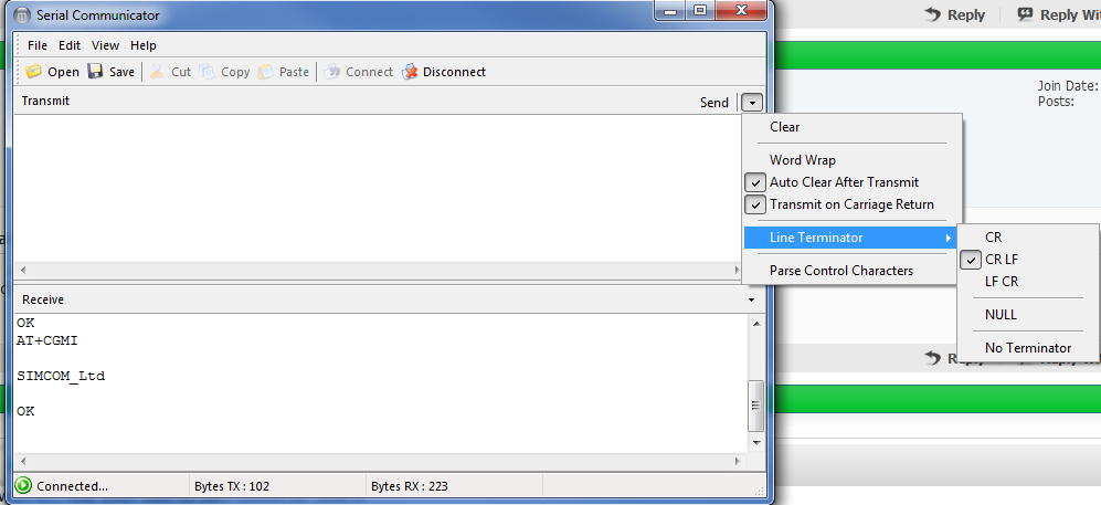

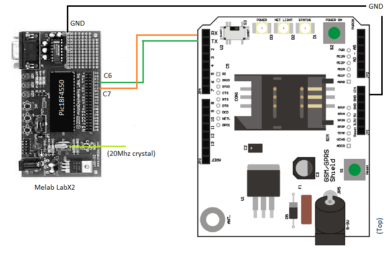

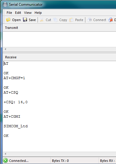

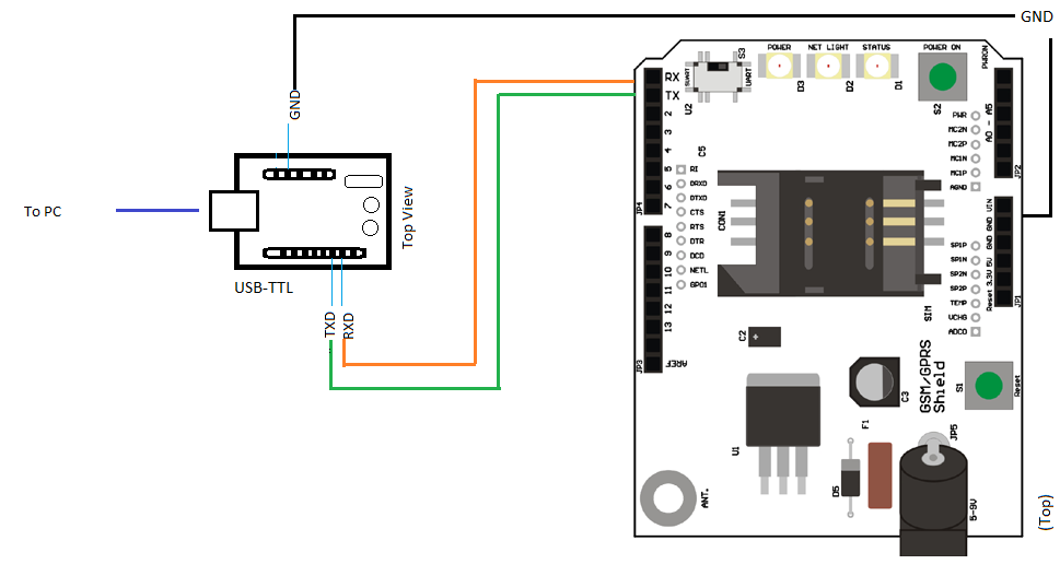

    I have a SIMCOM SIM900D GSM/GPRS module. I'm trying to make it communicate with the Pic18F4550 with 20Mhz crystal. But before that I made sure that the module is working/replying to AT commands by connecting it the serial port communicator via USB - TTL converter. And I confirmed that PC(Serial communicator) -> USB-TTL converter + GSM(Baud 115200) module are working.
    Then the next step I did is to try to send HSEROUT ["AT",13] to the GSM module..using hardware setup below

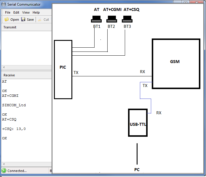

    I did some more testing and the following codes works but still have some issues.

    After pressing each button (response displayed to the LCD) I need to press the RESET button of the LABX2 everytime.
    What do you think its causing this?

    On the SERIAL COMMUNICATORl, sending AT commands had no problems( w/ CR and CRLF).
    tacbanon

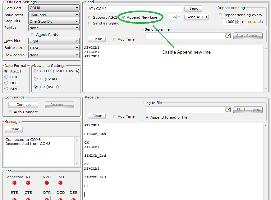

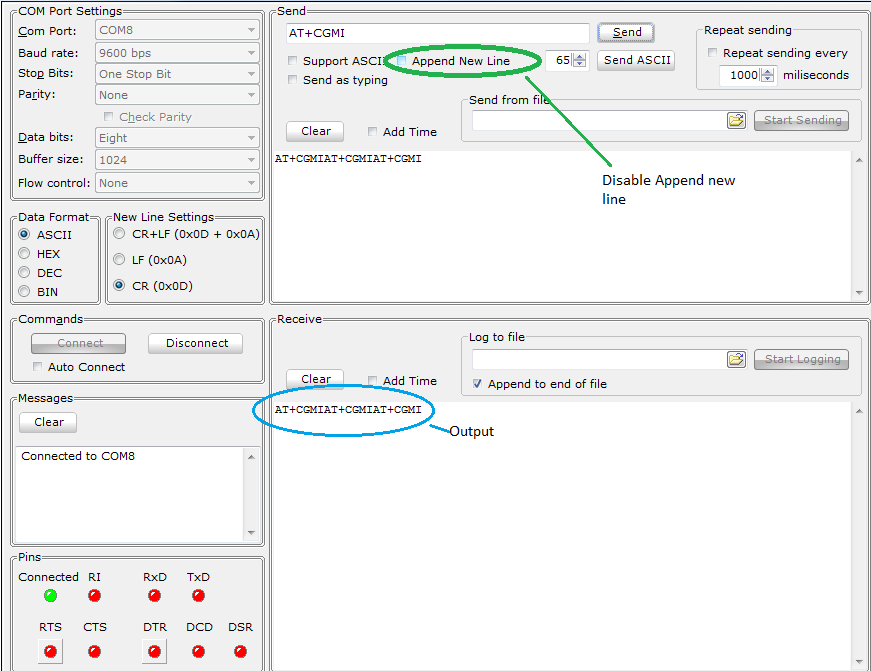

    I tried other serial communicator, and I'm not sure if I found the trouble...
    When I disable the Append New Line
    With New line after sending
    Do you think adding new line after each send will solve it - how?

    I tried to modify my hardware setup to detect whats going IN and OUT in the GSM module (below). I test each button(Button1-Button3) and each corresponding response of the GSM shown in the serial communicator.
    I noticed that everything seems normal..but when I tried the connection PIC-GSM... I have the same issue.
    So sending PIC to GSM AT commands is not issue..I think when receiving incoming data from GSM to PIC is where the trouble is.
    tacbanon

    For testing I removed all HSERIN command to see if it will continue each line. And below is the results.
    Here is the code I'm using...

    Yes I'm using a shield..sorry I can not seem to find the schematic. I used USB -to TTL module to communicate with the PC.
    /tacbanon
