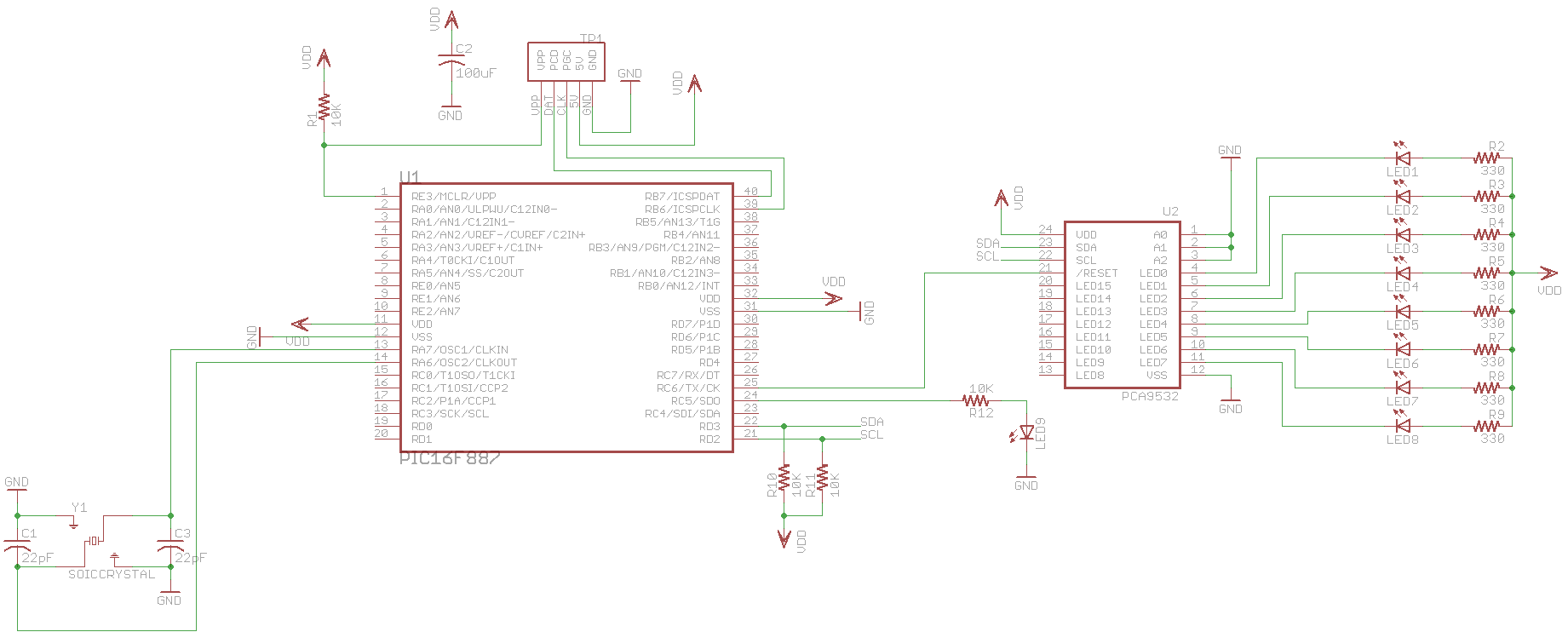

    I've drawn a schematic of my test setup for reference. Let me know if anything doesn't look right. Thanks!
    Default Re: i2c interface with LED driver PCA9532
    I notice the led's are drawn backwards.... It will be kind of tough to get them to light....

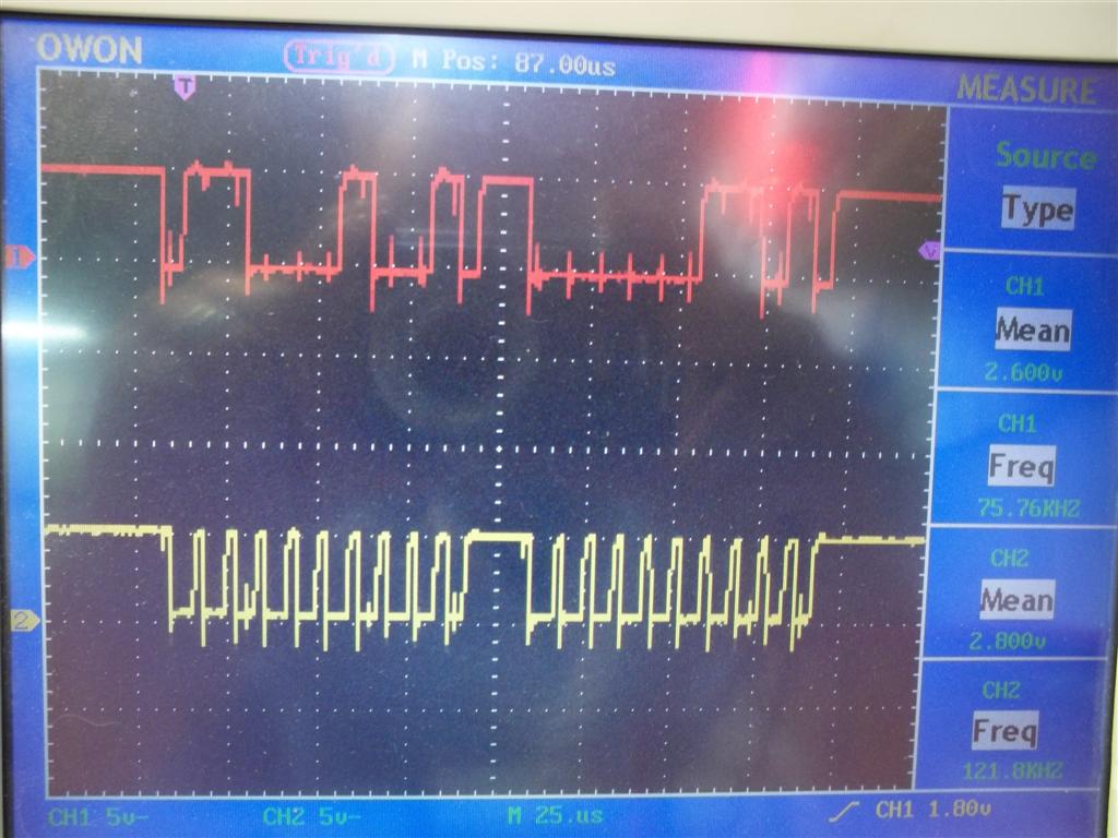

    Lol, that's what happens when I draw a schematic in a hurry. Thanks for noticing. The leds are wired correctly on my breadboard though. I just can't get any response from the PCA9532. I've scoped the SDA and SCL pins and I can see the correct clock signal on SCL and various "data" on SDA, so I know that the PIC is outputting something. When I add the optional label argument to the i2cwrite function, the program constantly jumps to the label. Which means that I'm not receiving an acknowledge from the device. I've also tried adding "DEFINE I2C_SLOW 1" to my program because I'm running a 20MHz clock, but it did not help.
    Jul 2012
    7
    Thumbs down Re: i2c interface with LED driver PCA9532
    Here is my new code and a shot of my oscilloscope to show the output. I can see that I'm not getting an acknowledge, but I do not know why.

    Thanks for the reply! I added both of your ideas to my code, but I still cannot receive an acknowledge from the PCA9532. When I look at my scoped output and the datasheet, it looks like it should work with no problem... The address is correctly clocked out along with the R/W bit... there should be no problem. Anyways here's updated code: More advice will be greatly appreciated! Thanks.

    I got it working! The chip is in a SO24 package so I had to use a SMD to breadboard adapter, which was apparently faulty... Anyways there was no problem with my code, so it all works now! Thanks.
