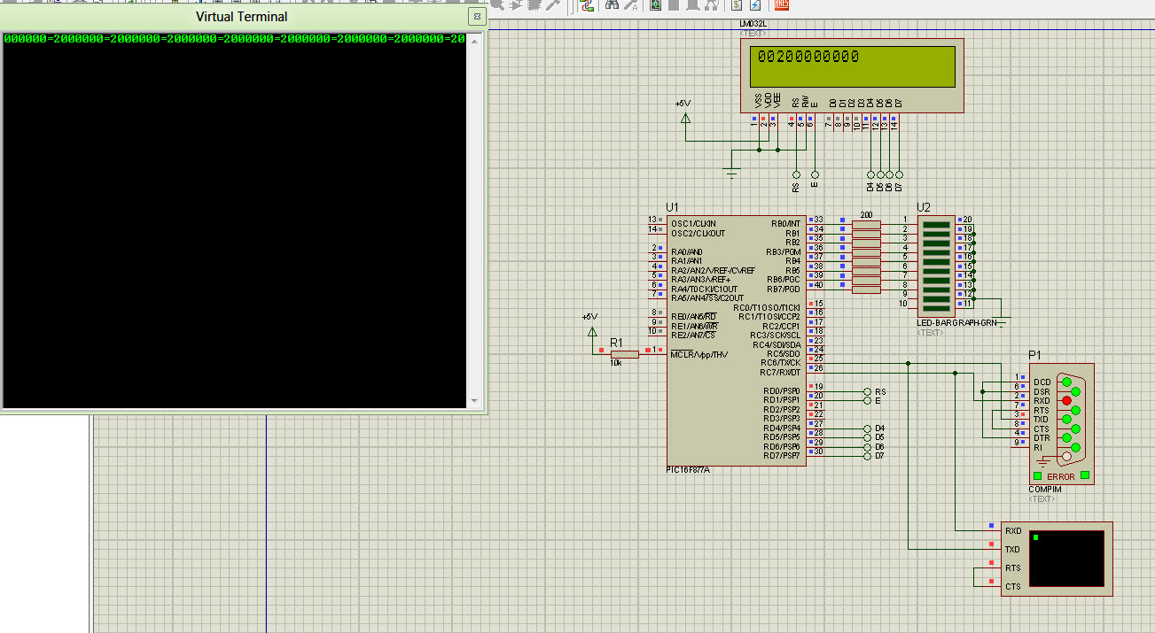

i receive serial input from weight meter head
the input in the form shown in this image ASCII Characters
this picture shows the input from weight meter at the left
and the lcd output for the code attached
it's 2 kilogram but the lcd shows 20 and sometimes it shows 00000000 values instead since it store values randomly without index or char to start from
the problem is that i need to read the values after "=" equal ascii character
i need a way to store array of ascii's input let's say 10 input's until it reaches the charachter "=" so that i can use DIG to extract the values and display it in 7 segment display instead of lcd.

but when i tried another code it gives me reversed values on the lcd if i tried to store values as string of 10 char
and then used dig to extract them and displayed them at lcd with DEC before each char extracted
i.e
it shows
decimal 35 for ascii 5
decimal 84 for ascii 0
but when i put weight more than 9 it shown only the values coresspondes to the right part of the number
so if the weight was 10 it shows 84
another thing to say is that 84 is the reverse of dec equavelent for ascii 0
