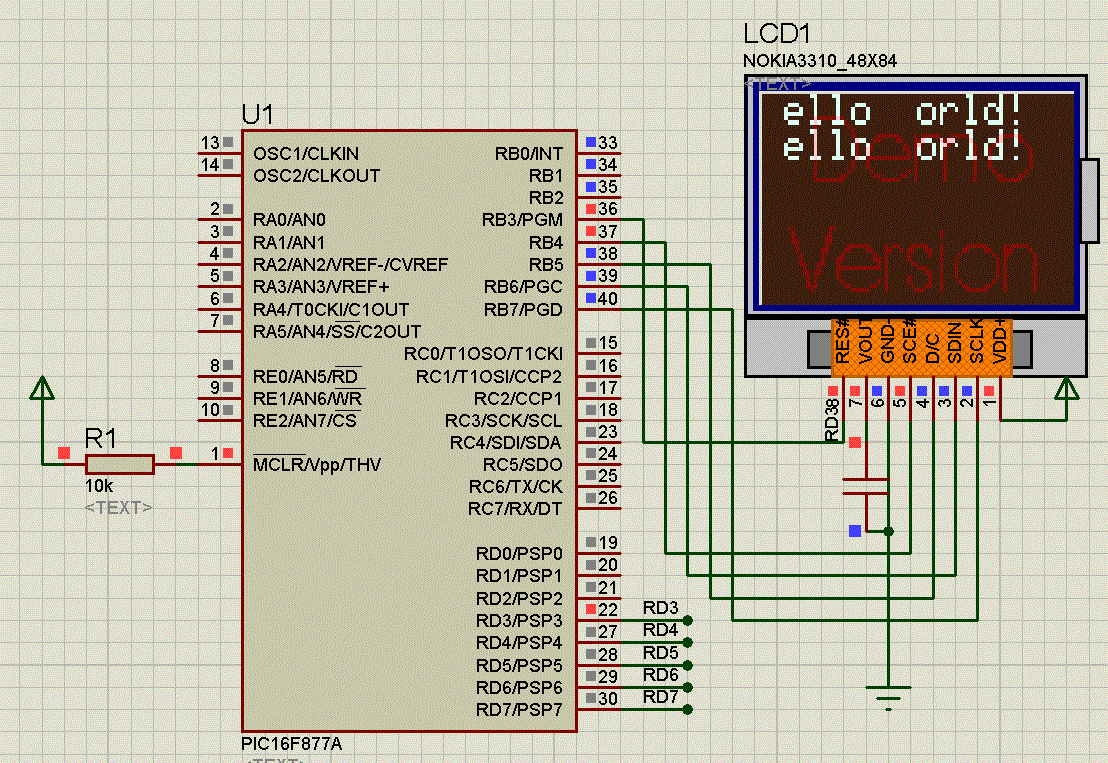

    it compiled with no problem now, but custom character won't display on the lcd, probably I'm still doing it wrong..
    I'm expecting a letter 'j' in the 3rd row.

    You'll see a J once you'll add it in the character you want to use.... no coincidence why you don't have the H nor the W either
    Again it's all explained in the Readme.txt file...

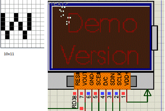

    I'm trying to display a 10x11 font size "w" but not displaying right to the lcd...(sorry if I'm very slow catching up )

    								ADDCUSTOMCHAR CHR_CUSTOM_0,0x04,0x88,0x01,0x48,0x01
    								ADDCUSTOMCHAR CHR_CUSTOM_1,0x28,0x01,0x18,0x01,0x00
    								ADDCUSTOMCHAR CHR_CUSTOM_2,0x00,0x00,0x00,0x00,0x00
    								ADDCUSTOMCHAR CHR_CUSTOM_3,0x00,0x00,0x00,0x00,0x00
    								ADDCUSTOMCHAR CHR_CUSTOM_4,0x00,0x00,0x00,0x00,0x00
    						CHARTABLEEND

    Default Re: Display graphical font using Nokia3310LCD
            '       Includes
            DEFINE GLCD_CHAR_IN_EEPROM               ' store/read character/lookuptable to/from EEPROM
            DEFINE GLCD_STRING_IN_EEPROM           ' store/read string to/from EEPROM
            define GLCD_CHAR_6X8
            DEFINE GLCD_USE_SPECIFIC_CHARACTER       ' We will define our own set of character to be used
            INCLUDE "..\Include\GLCD_NOKIA.PBP"    ' Plug the Nokia Driver/Wrapper in here
                    CHARTABLESTART
                            ADDCHAR 'T'
                            ADDCHAR 'E'
                            ADDCHAR 'X'
                            ADDCHAR 'a'
                            ADDCHAR 'b'
                            ADDCHAR '!'
                            ADDCHAR CHR_NUMBERS
                            ADDCUSTOMCHAR CHR_CUSTOM_0,0x78,0x80,0x60,0x18,0x60,0x80 ;
                            ADDCUSTOMCHAR CHR_CUSTOM_1,0x78,0x00,0x00,0x00,0x00,0x00 ;
                            ADDCUSTOMCHAR CHR_CUSTOM_2,0x00,0x01,0x00,0x00,0x00,0x01 ;
                            ADDCUSTOMCHAR CHR_CUSTOM_3,0x00,0x00,0x00,0x00,0x00,0x00 ;
                    CHARTABLEEND
            '------------------------------< Main program >---------------------------------------------
                    GLCD_CLS     ; Clear the screen (if not initialized yet, it will do automatically)
                    GLCDOUT_AT?CHR 0,0,CHR_CUSTOM_0
                    GLCDOUT_AT?CHR 1,0,CHR_CUSTOM_1
                    GLCDOUT_AT?CHR 0,1,CHR_CUSTOM_2
                    GLCDOUT_AT?CHR 1,1,CHR_CUSTOM_3
                    GLCDOUT_AT?STR 5,6,"TEXT!"

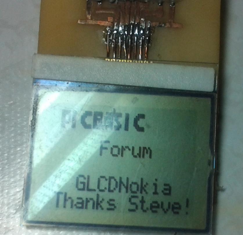

    Finally got it...thanks for the help.
