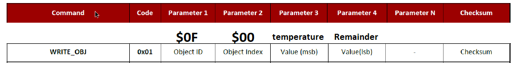

    Now i have an LCD that requires a CS value to be added in a command.
    Thats why i gosub to find and calculate the CS value of the overal command.

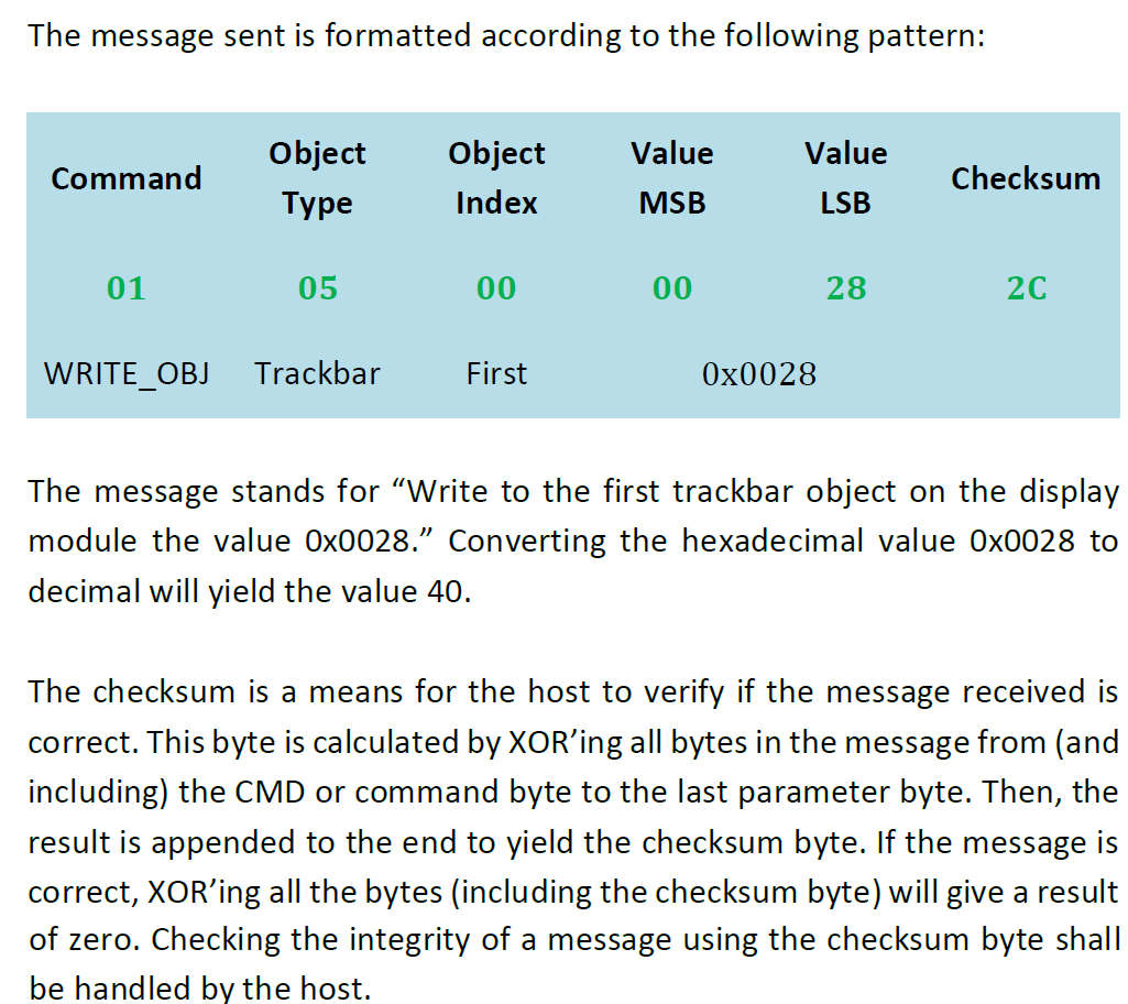

    According to the manual of the display and the VISI GENIE OS.
    The following is an example.
    I'm missing something, because right now as the code is, returning from the Checksum calculation, the HSEROUT command is set right. But i do get HEX result. Right?

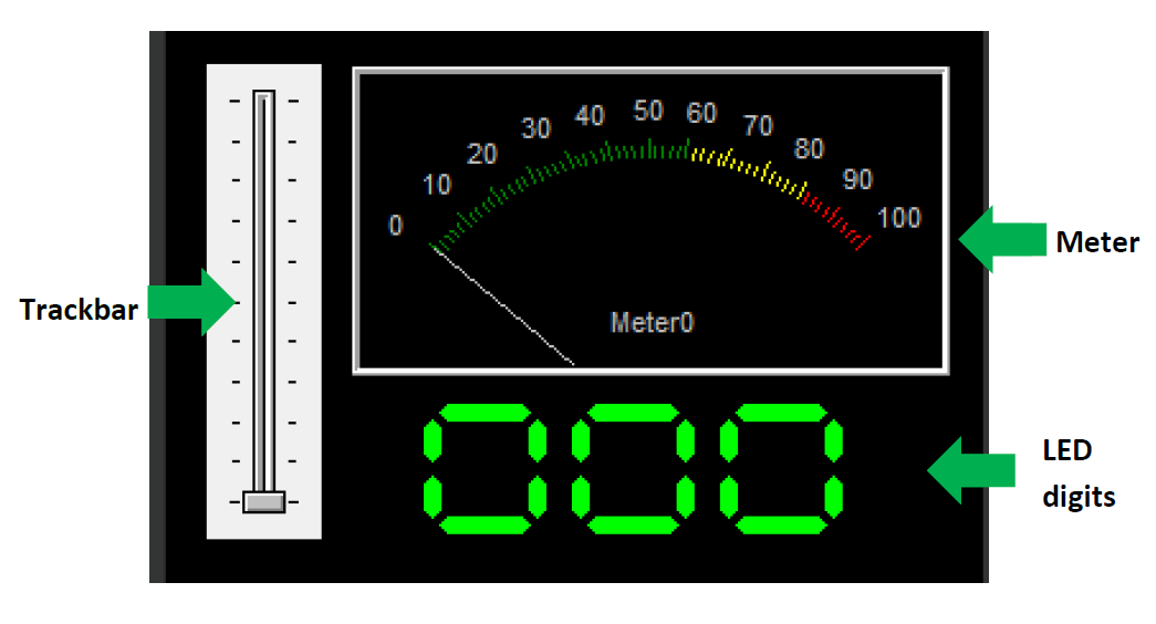

    Trackbar is only an object ID in VISI GENIE OS for the Display like the following.
    in our case we do use the LEDDIGITS which the OBJECT ID is $0F
    4,183

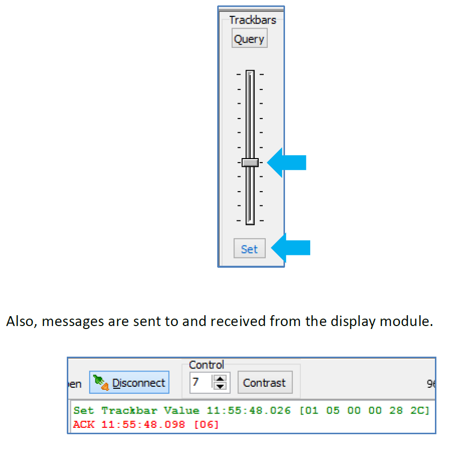

    Default Re: Multi-digit word variable to string
    OK, I see.
    So, if you want to move the trackbar to position $28 you will use
    HserOut [$01,$05,$00,$00,$28,$2C]
    and the slider will goto position $28.
    But I guess you have to set beforehand the two ends of the trackbar? I mean the zero can be 100 and the maximum position 200, or whatever.
    Can you try and see if you can move the trackbar just by sending straight in values? and the CRC computed by hand.
    Then you may do more complicated things.

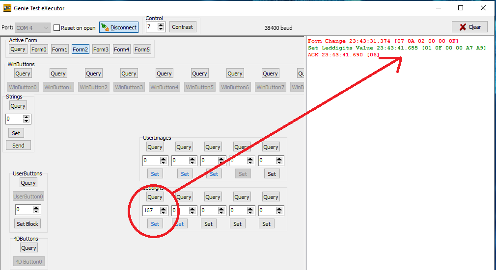

    in my case i do not use the trackbar, but the LED digits as shown below.
    In the software 4D SYstems they have, you can set manually a number for example 167, and will show you the command as shown in the SET DIGIT VALUE:
    I have tried to give manually a constant number and it worked!

    Now i'm trying to figure out how to add the remainder in the command.

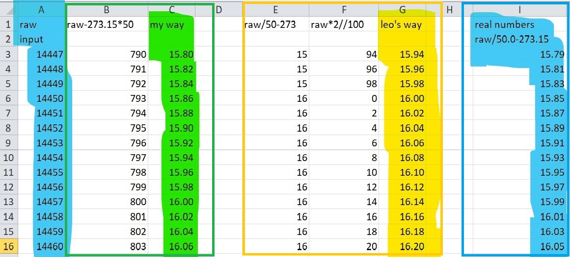

    your temperature calculation is not accurate and the remainder calculation is mathematically incorrect
    temperature  = tempir/50         ' based on the manual we need to divide by 50 or 0.02
    temperature  = temperature - 273 ' subtract 273 for Degree in C,actually is 273,15
    yields the temp in deg C to about 1 deg of resolution with an error of +- 1 degree
    remainder    = (tempir*2)//100   ' multiply x 2 and get the remainder //100
    calculated the 100 modulus of the temp in deg kelvin
    adding them together is nonsense , trying to display a two decimal point result is from any of these results is just not right
    Name:  Screenshot 2021-12-19 163013.jpg
    wtf tempir = (temp.highbyte << 8) + temp.lowbyte ;just Nooooo! its the hardest most convoluted way i have ever encountered to go
    tempir = temp which serves no purpose anyway
    don't like this either, it pisses away too much resolution hence its not particularly accurate
    ;this is good  although it could be even more accurate [temperature  = temp*2  - 27315 ; temp x 2 - 273.15*100 ] >==>temperature*100] if the raw value won't exceed 32768
    temperature  = (temp  - 13657)<<1  ; (temp-[273.15*50]) x 2   <==> temperature*100; is good
    i make the assumption temperature * 100 is the value required by the slider display
    tempir and remainder are not needed

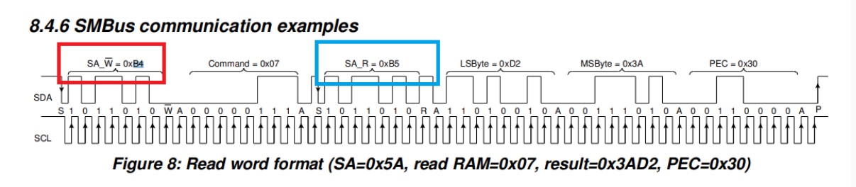

    wait a sec,
    im reading the manual again from the SENSOR
    https://www.waveshare.com/w/upload/e/e4/MLX90614-EN.pdf
    Name:  ir sensor 2.png
    Oct 2010
    413
    If the chip is the MAX30102, on page 16 seems that reading needs first a write.
    it is an IR MLX90614
    Oct 2010
    413
    Applying the 0x00 is not working.
    When i add back the B4 or B5 for write or read mode correspondingly, everything is in a working order again.

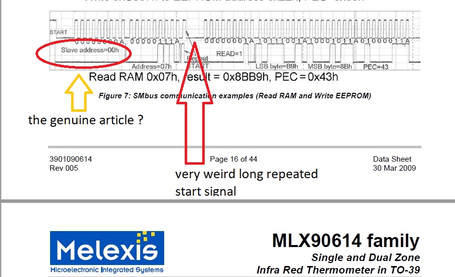

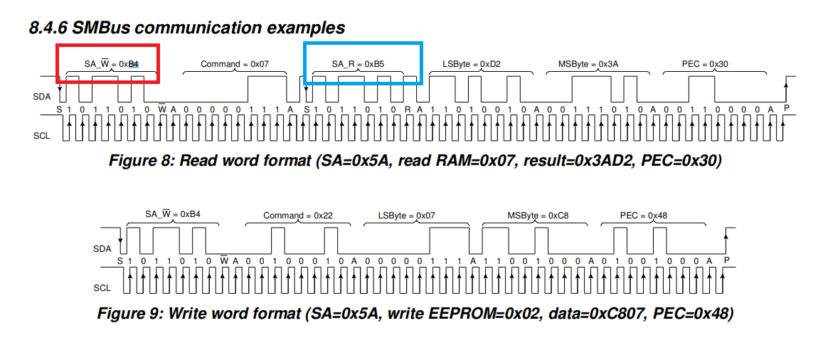

    out of curiosity i downloaded the real data sheet and discovered quite a few things
    1 the bus speed is 100khz
    2 the datasheet depicts an abnormally long repeated start signal on a read transaction [no specs but]
    3 the bus needs a SMBus Request signal before a read/write transaction
    4 the genuine article has addr 0 not 0xb4
    looking at ebay banggood aliexpress etc yields a 5 to 1 price range from $10 to nearly $60 us
    most venders spruking a multitude of part numbers in the listing, you would wonder what you are buying
    i suspect clones fakes and lookalikes abound
    a real one from e14 or rs is $40ish au , a bit much for a play trinket for me
    so i don't think i can take it much further

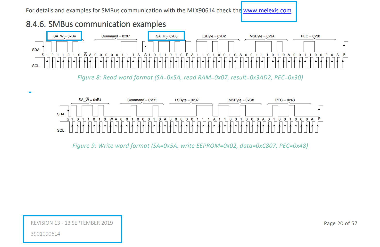

    Now i have changed the code and used byte insted of word for the reg and used only the code line you suggested and taaaadaaa, it worked.
    Apart from that......
    i think i have the original from melexis the IR module as it cost here in Europe around 25 Euros.
    The link of the Datasheet is the following.
    https://www.melexis.com/en/documents...sheet-mlx90614
    and this is the part of the datasheet shown the revision and the date.
