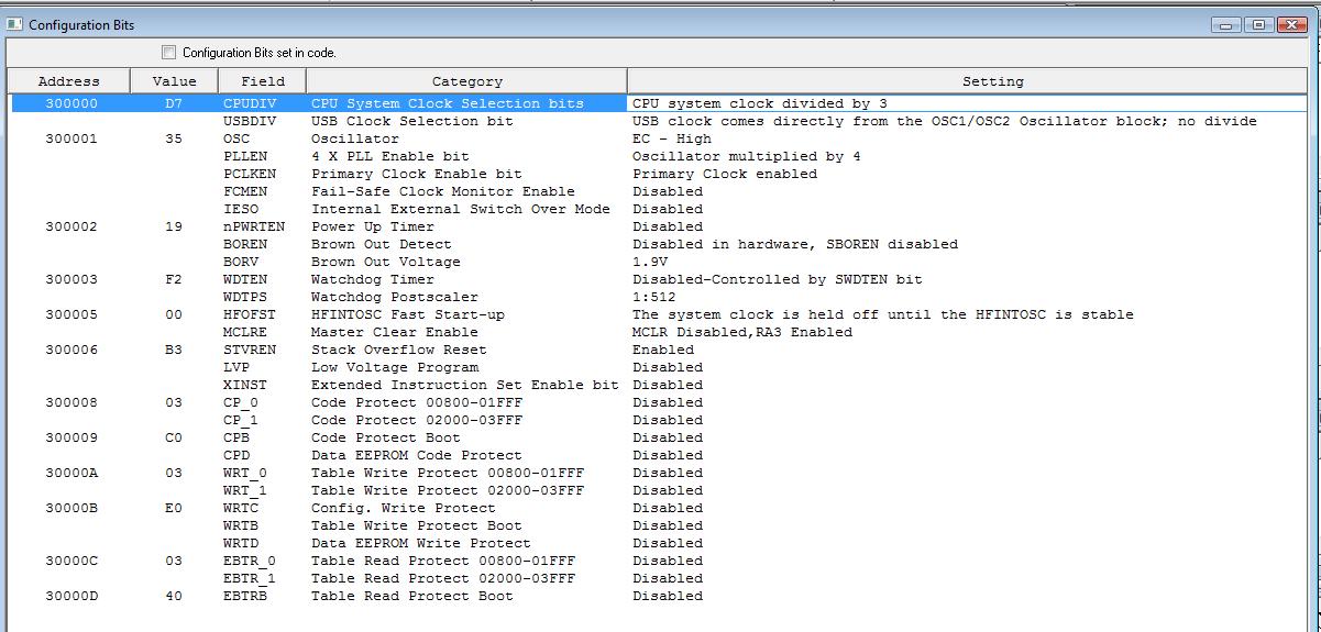

    Hi all, can anyone check my config in the picture below..
    I am trying to get a 18f14k50 usb to work but I just keep getting the 'USB Device not recognized' message from windows.
    I'm using a lab-x1 board with the clock set to 12mhz and the config settings below
    Can anyone give a hello world example or config that will get this device going, I've been at it all day and I'm going nuts lol
    Ps: i've read the datasheet and the other postings about config, i'm no wiser.

    Reading the datasheet & understanding it are two different things.
    Default Re: Hello World help please 18F14K50 config
    You might try looking at Darrel's sample here: http://www.picbasic.co.uk/forum/show...0434#post80434
    ASM ; 18F13K50/14K50 Only 12mhz crystal can be used for USB
    __CONFIG _CONFIG1L, _CPUDIV_NOCLKDIV_1L & _USBDIV_OFF_1L
    __CONFIG _CONFIG1H, _FOSC_HS_1H & _PLLEN_ON_1H & _PCLKEN_ON_1H & _FCMEN_OFF_1H & _IESO_OFF_1H
    DEFINE OSC 48
    Thanks for sharing that config, I tried it but it does not work, I still get the device not recognized message, any ideas ?
    Hi yeah dial-up can be a pain.
    I used the prototype area on the lab-x1 for the 14k50, I tried darrels code and it gives the same problem but darrels code does not tell you what config settings to use ?.
    I think it does show most of the configs to use:
    Hi, yes, I just noticed that, ok I copied that config into the program and also into the INC file and still device unrecognized :-(
    What code are you using for the usb part? DT_HID260.pbp, withDT_INTS-18.bas or something else?
