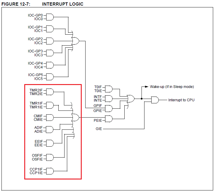

    Although this appears to be working in my application I'm confused by
    PEIE var INTCON.6 'Peripheral Interrupt enable
    (Does this need to be on for TMR0 interrupt?) I currently have it enabled.
    I understand PEIE needs to be enabled for TMR1 but TMR0?
    Default Re: TMR0 Confusion
    Appears not as seems to be working without it set?
    In the Interrupts section of the datasheet (under SPECIAL FEATURES OF THE CPU), there is a diagram that shows the Interrupt Logic.
    Only the peripherals in the red box are affected by PEIE.
    Thanks Darrel that's very clear, little by little i'm learning.
