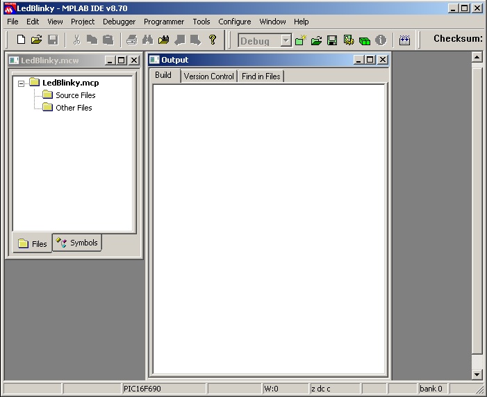

    There's quite different way to start a new project within MPLAB. Here I'll show how to start a new PicBasic project using a PIC16F690 with the Project Wizard.
    1. On the top menu, Click on Project
    2. Select Project Wizard
    3. Click on Next
    4. Choose PIC16F690 from the Device drop down list
    5. Click on Next
    6. Time to tell MPLAB we'll be using PICBASIC PRO
      From the Active Toolsuite drop down list, choose microEngineering PICBASIC PRO Toolsuite... obvious I know.
    7. Click on Next
    8. On the right side of Create New Project File field, Click on Browse
    9. Choose the folder we created to store our codes & project C:\PBP_Prog
    10. In the Filename Field type LedBlinky
    11. Click on Save
    12. Click on Next
    13. You'll be prompted to add some source code and files... click on Skip
    14. We're done, Click on Finish

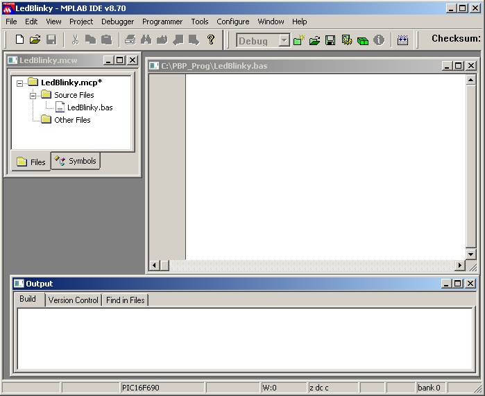

    Looks familiar? Great. Now what we need to do, is to create, and add a source code to it.
    1. On the top menu click on File
    2. Choose New, this will open a new window called Untitled. Our source code will go there
    3. Let's give our source code a name.
    4. Choose Save As
    5. In the Filename field, type LedBlinky.bas
    6. Click on Save
    Project is created, Source Code file is created, but have a look at the project explorer windows on the left... there's no source code included...yet. There's two way to add/include your source code to it.
    1. In the project explorer, right click on Source Files and then on Add Files
    2. On the top menu, click on Project then choose Add Files to the project
    Both do the same job, I prefer the right click thing... it's up to you to decide.

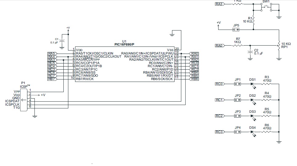

    Ok so now we should have everything setup up properly and we are now ready to jump on the dark side. BUT before we jump in, as we're going to use a PIC16F690 and Microchip LPC Demo board, it's a good idea to download some references to make friend with
    1. The PIC16F690 Datasheet
    2. Microchip's LPC Demo Board User Guide
    I assume you have ALL 5 JUMPER installed.
    Let's observe the board schematic (PDF page 41)
    Name:  LPC Schematic.jpg
    Is there some gotcha in it? Sure...
    1. There's no crystal attached to the PIC.
      Q. And then?
      A. We will need to configure the PIC to work with it's own internal OSC. If we don't do it, the PIC will never run...
    2. LEDs are attached to some pin who have some enabled by default analog peripheral.
      Q. How do you know that?
      A. The PIC pinout gives some hints, but It's always a good to have a look in the datasheet,
      Section 4.5 PORTC and TRISC Registers (pdf page 78-82)
      Table 4-3 resume it really well, you want to dig the datasheet to see how to set them.
      Q. What if I don't care about the datasheet and just go ahead typing some code for...what kind problem it may cause?
      A. You'll be the really first one on earth Your milleage may vary, but usually a LED connected to an analog pin doesn't work at all. Have a good look at This thread for more infos.

            '    Date       : June 22, 2011
            '    Device     : PIC16F690
            '---------------------------< Project description >-------------------------------
            '   Beginner code example to display the ADC reading from channel AN0 to 4 LEDs
            '   attached on PORTC<3:0>
            '       1) PBPDEMO version
            '       2) MPLAB
            '       3) PICKIT 2 Programmer
            '----------------------------< Hardware listing >---------------------------------
            '   - Microchip Low Pin Count Demo Board
            '   - PIC16F690 installed
            '   - *** All jumper have to be installed ***
            '   - Target board will be powered by the PICKIT 2
            '       Pic Configuration
                    '   All PIC configuration fuses (Configuration bits) are listed in the
                    '   C:\PBPDEMO\p16f690.inc file.  Also see datasheet section 14.1
            @  __config _INTRC_OSC_NOCLKOUT & _WDT_ON & _MCLRE_ON & _CP_OFF & _CPD_OFF & _FCMEN_OFF & _IESO_OFF & _BOR_ON & _PWRTE_ON
                    '   _INTRC_OSC_NOCLKOUT: Using Internal Oscillator
                    '   _WDT_ON: Enable Watch Dog Timer
                    '   _MCLRE_ON: Enable MCLR
                    '   _CP_OFF: Disable Code Protection
                    '   _CPD_OFF: Disable Data Code Protection
                    '   _FCMEN_OFF: Disable Fail Safe Clock Monitor
                    '   _IESO_OFF: Disable Internal/External switchover
                    '   _BOR_ON: Enable Brown out detect
                    '   _PWRTE_ON: Enable Power up Timer
            OSCCON  = %01110000  ' datasheet section 3
                    ' -x-------- n/a
                    ' --111----- IRCF<2:0> Internal Oscillator Frequency Select Bits (8MHz)
                    ' -----xxxx- Read Only
            DEFINE OSC 8    ' tells PBP we use a 8 MHZ clock
            '       Hardware assignment
                    '   Here we assign Aliases to PORT pin
                    '   this makes the code easier to read
                    '   I'll use the Aliases name as written on the schematic
                    '   LEDs
                    DS1     VAR PORTC.0
                    DS2     VAR PORTC.1
                    DS3     VAR PORTC.2
                    DS4     VAR PORTC.3
                    LED     VAR PORTC
            '       Hardware configuration
                    '       I/Os (Datasheet section 4.0 & above)
                    TRISA = %00000001
                          ' -xx------- n/a
                          ' ---00000-- Output: When capable of
                          ' --------1- Input: AN0, ADC input
                    TRISB = 0   ' All PORTB I/O set as Output
                    TRISC = 0   ' All PORTC I/O set as Output
                    '       ADCs (datasheet section 9)
                    ANSEL  = %00000001
                           ' -0000000-- AN<7:1> = Digital I/O
                           ' --------1- AN0 = Analog
                    ANSELH = 0  ' AN<11:8> = Digital I/O
                    DEFINE ADC_BITS 8       ' Set number of bits in result
                    DEFINE ADC_CLOCK 3      ' Set clock source (rc = 3)
                    DEFINE ADC_SAMPLEUS 50  ' Set sampling time in
                    '       Comparator (datasheet section 8)
                            '   At Power On, the comparator are already disabled
                            '   but let's play safe.
                    CM1CON0 = 0 ' Disable comparator 1
                    CM2CON0 = 0 ' Disable comparator 2
            '       Software variable
            bADC    VAR BYTE    ' Hold the ADC reading
            '       Software/Hardware initialisation
            PORTA = 0   ' clear PORTA output pins (0v)
            PORTB = 0   ' clear PORTB output pins (0v)
            PORTC = 0   ' clear PORTC output pins (0v)
            WHILE !OSCCON.2 : Wend  ' Wait untill the internal OSC get stable
            '------------------------------< Main program >-----------------------------------
    Start:
            ADCIN 0, bADC   ' read AN0 and store it to bADC variable
            '       Since we use only 4 LED and the ADC is a 8 Bit result, we
            '       need to adjust it so the ADC range will fit a 4 BITs LED reading
            '       To do so we will shift the ADC by 4 bits
            bADC = bADC>>4
            LED = bADC ' show the result
            PAUSE 100   ' wait 100 mSec
            GOTO Start  ' do it again
    • Compile
    • Program
    Now see what happen when you play with the pot attached to AN0 input.
