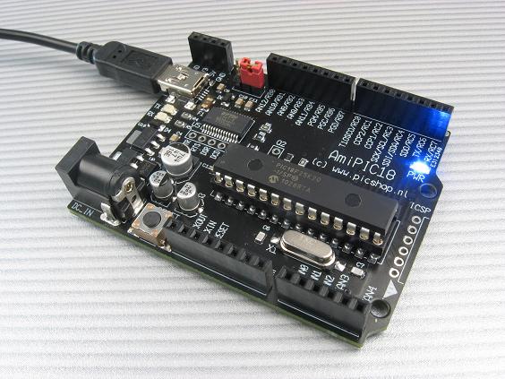

    Default Amicus clone
    Hello Dave,
    Why not a PIC based board ?
    With the free Proton Compiler or with MELabs PIC Basic.
    Works well.
    Gevo
    Dec 2005
    1,073
    Default Re: Amicus clone
    Quote Originally Posted by Gevo View Post
    There seem to be a surfeit of PIC based boards, Amicus18, XINO, the one you have referenced and, I suspect, many, many more.
    As I told Bruce Reynolds in another thread, I seldom choose PICs for anything beyond 8-pins (or an occasional 16F88) and have long preferred ZBasic for bigger projects. Anyways, at 70 years of age and in ill health (my sell by date passed about 3 years ago), I'm sort of stuck in my ways.
