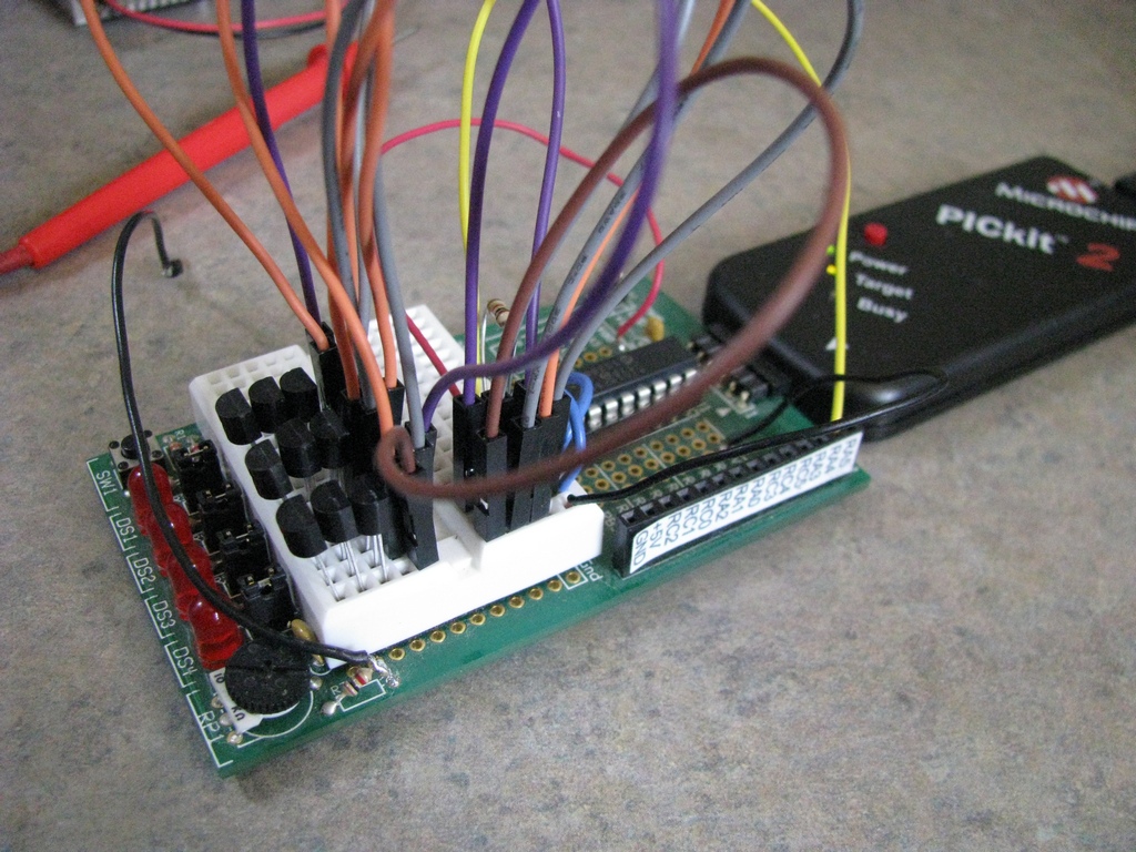

    Below is a sequential read of nine sensors that are all in parallel on a bread board:
    1 TempC = +25.1250 C
    2 TempC = +25.2500 C
    3 TempC = +25.1875 C
    4 TempC = +25.1250 C
    5 TempC = +25.625 C
    6 TempC = +25.625 C
    7 TempC = +25.625 C
    8 TempC = +25.625 C
    9 TempC = +25.0 C
    I modified Bruces code that is posted on rentron. First I read each serial number and made a note of it as I placed it in line on the bread board. Then I did a For/Next read of each sensor and displayed the temp using debug.
    I also sequentially touched each one with a hot soldering iron and watched just that sensor change in value confirming that I, indeed, was reading each sensor.
    If anybody is interested in my test code... I would be happy to post it. I used a 16F690 on a Microchip LowPinCount demo board with pickit2. You can see all nine sensors lined up 3 x 3 on the breadboard.

    Here is the latest read of all nine sensors:
    1 TempC = +25.3125 C
    2 TempC = +25.4375 C
    3 TempC = +25.3750 C
    4 TempC = +25.3750 C
    5 TempC = +25.2500 C
    6 TempC = +25.2500 C
    7 TempC = +25.1875 C
    8 TempC = +25.2500 C
    9 TempC = +25.1875 C

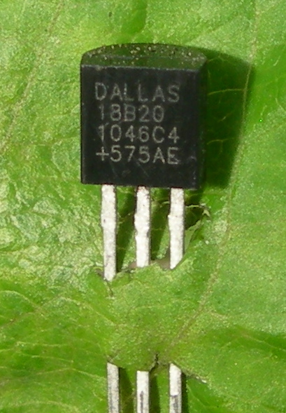

    If the chips actually work, I doubt they're counterfeits, it would not surprise me if they are old or not RoHS compliant.
    Order 2500 at mouser for $2.09 each . . . I am getting even more sure of my opinion about old stock . . . and those You have shown, Look Old too . . . http://www.mouser.com/Search/Refine.aspx?Keyword=DS18B20&Ns=Pricing|0&FS=True

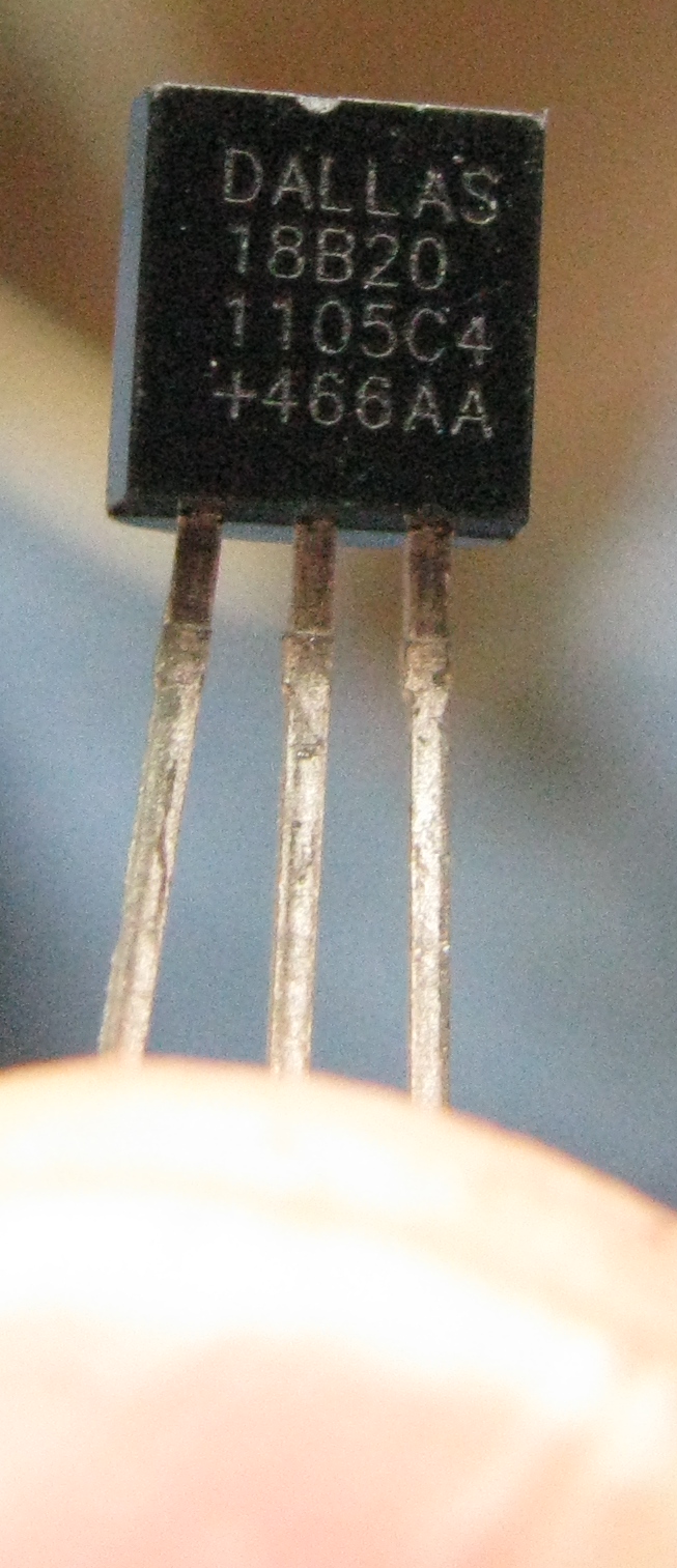

    As for whether they are fakes, sounds like they work. The printing on yours vs a known sample I got directly from Maxim look approximately the same to me. Both seem to have letters that are slightly askew. Yours seems to have the S in DALLAS raised maybe slightly more.
    Looks to be a good bargain. So I bought some too!

    portC=0                 'turn off LED's on breadboard
    Begin:
        PAUSE 500           ' Wait .5 [1/2] seconds
    Main
    for sensor=1 to 9       'I am reading 9 DS18b20 sensors... change this to match how many sensors you are reading
    portC=sensor            'use the 4 breadboard led's to count binary as each sensor is read
        for hexbyte=0 to 7  'each sensor address is 8 bytes
            gosub getid     'go look up each sensors address
            id[hexbyte]=col 'load the ID array with the retrieved address byte
        next hexbyte        'go get the rest of the address bytes
        gosub readsensor    'now go read the current sensor
        gosub DisplayTemp   'now display the temp of the current sensor
    next sensor             'now go read another sensor
    portC=0                 'done with all 9 sensors... turn off led's
    debug $0D,$0A           'reset terminal cursor to home, upper left
    end                     'end here... use reset button to read them again.
    '============= subroutines ========================
    ReadSensor:
        OWOUT DQ, 1, [$55,str id\8,$44] 'instructs sensors to match[$55] this[ID] rom code and
                                        'initiates[$44] temperature conversion on matching sensor
    CkAgn:
        OWIN DQ, 4, [busy]      ' Check for still busy converting
        IF busy = 0 THEN ckagn  ' Still busy?, then loop
        owout dq,1,[$55,str id\8,$BE]   'instructs sensors to match[$55] this[ID] and start sending back scratchpad[$BE]
        OWIN DQ, 2, [Raw.LOWBYTE,Raw.HIGHBYTE]' Read two temperature bytes, then end communications
    DisplayTemp:                        ' +32.0 to +257 F
        IF      Cold_Bit = 1 THEN Cold  ' If Cold_Bit = 1, it's below "0" deg C
        Sign  = "+"
        Dummy = 625 * Raw      ' Multiply to load internal registers with 32-bit value
        TempC = DIV32 10          ' Use Div32 value to calculate precise deg C
        TempC  = (Raw & $0FF0) >> 4 ' Mask middle 8-bits, shift into lower byte
        Float = ((Raw.Lowbyte & $0F) * 625) ' Lower 4-bits of result * 625
        debug dec sensor," TempC = ",Sign,DEC TempC,".",DEC Float," C ",$0D,$0A
    '   debug "Raw ", IBIN16 Raw," Dec=",dec (Raw>>3),$0D,$0A  'display the raw value
    Cold:                       ' arrive here if temp is below zero C
        Sign   = "-"            ' Display - symbol for negative temp
        Dummy  = 625 * ~Raw+1' Multiply to load internal registers with 32-bit value
        debug dec sensor," TempC = ",Sign,DEC TempC DIG 4,DEC TempC DIG 3_
            ,".",DEC3 TempC," C ",$0D,$0A
    '   debug "Raw", IBIN16 Raw," Dec  ",(Raw>>3),$0D,$0A
    'below is a list of the addresses of each of the 9 sensors I am reading
    'these must match the sensors you are trying to read...
    'use "Read Rom" program to determine the addresses of each of these sensors
    GetID:
    Select Case sensor
            Case 1 :LOOKUP hexbyte,[$28,$1E,$F5,$24,$03,$00,$00,$B8], col
            Case 2 :LOOKUP hexbyte,[$28,$4E,$F4,$24,$03,$00,$00,$5B], col
            Case 3 :LOOKUP hexbyte,[$28,$35,$FC,$24,$03,$00,$00,$05], col
            Case 4 :LOOKUP hexbyte,[$28,$4D,$2C,$25,$03,$00,$00,$ED], col
            Case 5 :LOOKUP hexbyte,[$28,$45,$F8,$24,$03,$00,$00,$82], col
            Case 6 :LOOKUP hexbyte,[$28,$FC,$FC,$24,$03,$00,$00,$0C], col
            Case 7: LOOKUP hexbyte,[$28,$BB,$02,$25,$03,$00,$00,$77], col
            Case 8 :LOOKUP hexbyte,[$28,$32,$24,$25,$03,$00,$00,$6F], col
            Case 9 :LOOKUP hexbyte,[$28,$4C,$A5,$24,$03,$00,$00,$6D], col
    end select
    Please note... the basis for the above programs came from Bruce Reynolds' website www.rentron.com.
    http://www.rentron.com/PicBasic/PBP1-wire.htm
    http://www.rentron.com/PicBasic/one-wire2.htm
    http://www.rentron.com/PicBasic/one-wire3.htm
    I simply took his working code and modified it to work with a debug window instead of an LCD and made it work with 9 temperature sensors. Bruce's code originally read two temp sensors and two 1-wire switches. As always take a look at the data sheet for what ever sensor or switch you are using and you can get a better idea of what is possible.
    The third page link above actually has code that accuratly displays C and F as well as the raw 64 bit data.
    It should be quite easy to modify this to work with most any PIC micro you might have available. Simply look through the code and you will se I used PortA.4 as the 1-wire connect pin.
    I thought about combining these two programs into one and using one more PIC pin to tell the software to either run the first section of code to read an individual sensor or GOTO the second section to read multiple sensors. (have fun) Also if you don't have a PICkit you should be able to use any other programmer and an LCD, with some minor changes.
    Again, Thanks to Bruce for providing the basis of this code.
    Enjoy!!
    P.S. I use MicroCodeStudio as my IDE but I would assume that you can just copy and pase this code into your own IDE. (Integrated Development Enviornment) I have also attached the two programs to this post. When I looked at the post I could see that some of the formatting is lost.
    Don't forget to use a pull-up resistor on the 1-wire data line. Maxim recomends a 4.7K but I used a 10K.
    For some reason I was unable to upload the native file using extension of .pbp, so I changed it to .txt. You should be able to open it up in a text editor and copy/paste into your IDE or possibly just change the extension back to .pbp
