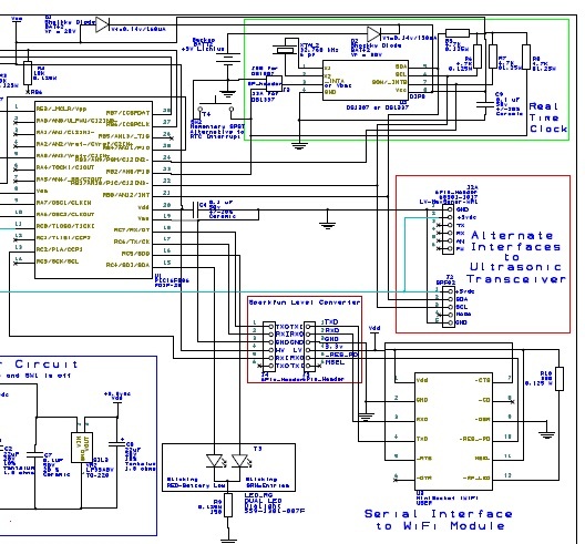

    I modified your proven code you inserted above very slightly per below. Because my PCB has the _RES_PD and MSEL interfaces connected to MCU pins for control of the module, I had to insert the "Initialize" statements for those interfaces per programmers manual to supposedly have module in normal AT+i ops for the internal serial interface. I also inserted some WRITE to EEPROM statements with comments and some LED blinking to assist my troubleshooting.
    As you can see from the comments, I never get the first I/OK acknowledgment from the module, which tells me that the internal serial interface from my MCU to the module is not working.
    Next step I guess is to solder 3 wires to my PCB to provision a temporary serial interface to my PC to see if Serial interface is working from MCU. Any other suggestions?

    I understand your point, Dave, but I already built the PCB with hookups to MSEL and _RES_PD from the MCU so have to make them work in the setup.
    This code works! The fix was to set TRISC so that _RES_PD and MSEL were declared as outputs. When this worked I was able to read the EEPROM to see what the IP was for the iChip website that it established and then to got to it via http://xx.xx.x.xxx/ichip and set the parameters I wanted.
    Now on to figure out how to integrate this working code into my application so I can use the iWiFi module to send an email via its connection with my wireless router to the internet.
    Thanks for your help, Dave. I hope this attached code will show others who visit this thread how to setup a iWiFi MiniSocket module to set its parameters without having to use the config utility.

    I thought it was working...and it is to a point. However I am seeing an anomaly I can't understand. I hope you can help me figure this out.
    I am programming my application with the below code using a PICKIT2. I have the PICKIT2 set to "VDD Target" so that the PICKIT2 is not providing power...my application has its own power.
    The programming of the device is normal and it starts working and executes the program normally as long as the PICKIT2 is still connected (but not providing power).
    However, when I disconnect the PICKIT2 and power down my application and then reapply the application's power, the code is obviously stopping execution at the point in the code where the AT+i coommand is given to set auto-baud at 9600 baud. I know this from the WRITE 4,4 statement not appearing in EEPROM after the test run and the LED_RED not blinking. However, when I then reconnect the PICKIT2 and load the PICKIT2 software with its screen, my application then works normally and executes the complete program with the LED_RED blinking as a heart beat during the BOOT loop.
    It is almost like the iWiFi module isn't getting power when the PICKIT2 is disconnected and therefore the AT+iBDRA fails...but it is getting power...I checked with a voltmeter.
    I am stumped and can't go any further in integrating this code with my overall application until I resolve this anomaly.
    Do you or anyone have any ideas why the iWiFi module would act this way with this code and this scenario?? At least I was able to use this code when it worked while PICKIT2 was connected to identify the IP address, log into the iChip web server from my PC via the wireless route,r and set parameters on the iChip.

    Does the PIC run without the PicKit2?
    Do a blinky to verify.
    The Sparkfun device looks like it requires 5 and 3 volts.
    Do you have both? Do they share a ground, VSS ?
    Do you have capacitors near the PIC across VDD and VSS?
    Did you change the backup battery problem?
    I created a set of code that is the same as above post down through the _RES_PD and MSEL initialization followed only by a mainloop that blinks the LED. I did this so that all the setup code I was using was still the same in this test. This blinky code works whether the PICKIT2 is connected or not, so that didn't ID the problem.
    Do you have both?
    Yes. Actually I have the iWiFi module running on 3.32 volts which is within its required Vdd range, so the lov voltage side of the Sparkfun converter is at 3.32v.
    Yes, I created a large ground plane layer on the top layer of my PCB right below the iWiFi module's outline where it is mounted to the PCB and this ground plane is shared with the level converter, the PIC and the rest of the PCB circuit.
    Yes, I have a 10uf tantalum and a 0.1uf ceramic connected near Vdd on the PIC to the Vss.
    Yes, after I cut the traces to the pull-ups and greenwired them to Vcc I then replaced the backup battery and the clock is running fine and maintaining time.
    These were all good questions and I appreciate you making me think through this. The bad news is that the code still quits running when the PICKIT2 is disconnected. However the good news is that I am now sending and receiving an email from the ichip (but only when the PICKIT2 is connected). Still trying to figure out the AT+i commands and right sequence of WAITs to only send one email when I want to. At this time for some reason it is sending two emails one minute apart repeated every 8 minutes. I thought I had the timing in this code set to only send one every 5 minutes and don't see where this is causing the repeats at the wrong interval. I only want it to send one every 5 minutes. I don't think I have the WAIT statements for I/OK, I/DONE, and I/ERROR correct and the timeouts to the EMAIL label may be causing repeated emails. Here is the EMAIL routine code I am using....any suggestions?

    I just saw them, got two.
    I do not have the RES_PD or MSEL pins connected to anything, they are floating.
    Cut some more traces.
    Or if all else fails, skip the sparkfun part and test with the whole system running on ~3 volts.
    Ain't prototyping fun

    Dave, I finally got it all working...or I should say almost all. Still troubleshooting one statement I want to add to the FTP process that is posting the wrong HH:MM values used from the RTC...for which I will describe and ask for help at end of this posting..
    First of all, I made what I think are some good changes to the approach which I will share below for benefit of anyone else monitoring this thread that is trying to use the ConnectOne iWiFi MiniSocket module. I broke a lot of your sample code into some callable subroutines which I will list and explain below. I am posting all this code because I discovered that the ConnectOne programmers manual for the MiniSocket doesn't have any examples so it is somewhat difficult to get the syntax just right. Since these routines are tested and work it should save others from having this problem. Although I should say that the TechSupport people at ConnectOne have been very helpful and also say they are going to add examples to each command reference in their next publish of the programmers manual for the very reason I pointed out to them.
    You will see a lot of WRITE to EEPROM statements embedded in this code which you can comment out or ignore...I use them to debug the AT+i command sequences so I know where the hangups are in the code by reading the EEPROM of the MCU after each run of the code when programming the MiniSocket module. I also have embedded a lot of variable duration, blinking LED statements to make use of a GREEN/ RED LED on my board to help see what is happening when the code is running.

  32. #72
    Mar 2009
    Colorado
    378
    Default Re: mackrackit's ConnectOne example code
    Quote Originally Posted by kenruizal View Post
    Do you have a schematic diagram of your design?...
    Not sure whether you are asking me for schematic or from mackrackit.
    As mackrackit says in one of his posts, we have both posted schematics. However, the previous one I posted had some errors in how to connect the ConnectOne iWiFi MiniSocket module, which I discovered the hard way in my PCB and had to re-do the wiring on the PCB. Therefore, if you want this updated schematic that shows how to wire the MiniSocket and how to use a SparkFun level converter module in the interface between the PIC MCU and the MiniSocket, here it is attached.
