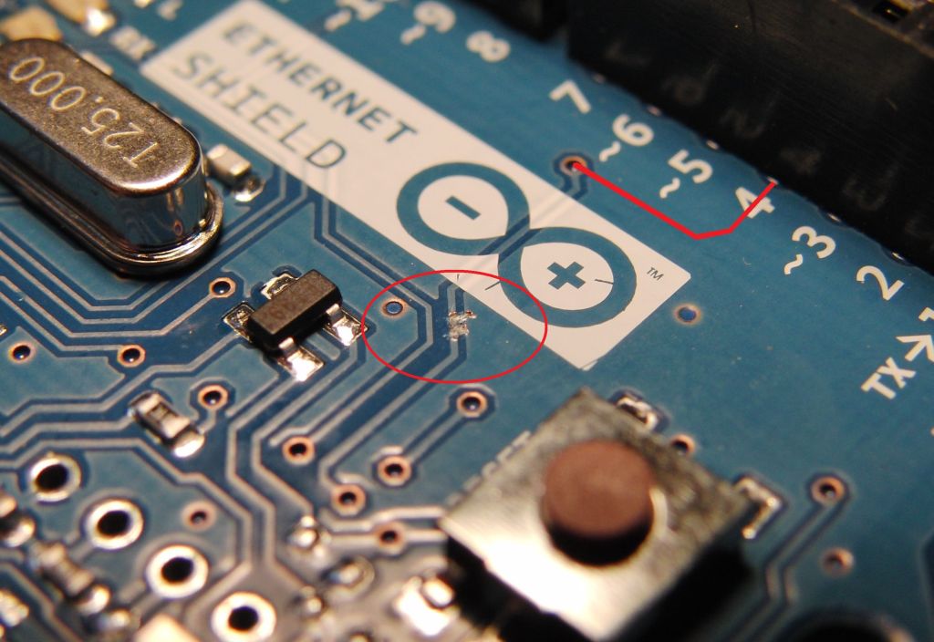

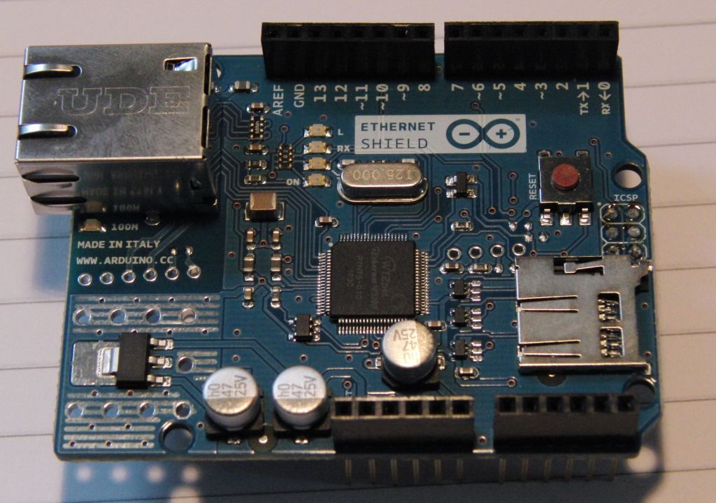

    As have been said the Ethernet shield uses a SPI interface to communicate with the host CPU. Since these signals are brought to the ICSP header on the shield we need to "move" them to pins that suits us better. The 18F25K22 that is used on the AMICUS18 has its SPI signals on RC3, 4 & 5 which are the same as pins 4, 3 & 2 on the Ethernet shield. Now, moving the SPI signals from the ICSP header to RC3, 4 & 5 wouldn't be too hard but unfortunately two out of three pins (RC3 & RC5) are already in use by the shield so we need to move those signals too - before we can connect the SPI signals to these I/O's.
    Pin 2 on the Ethernet shield (RC5 on the AMICUS18) carries the interrups signal from the W5100 chip. Since we might want to use this signal later on it would make sense to move it to an I/O-pin of the 18F25K22 capable of generating an interrupt. I've selected RB0 which on the Ethernet shield is labeled AREF. Fortunately AREF is not connected to anything on the shield so we're good to go there. By default the W5100 interrupt signal isn't actually connected to Pin2, instead there are two small solder pads on the back of the board which, when bridged with solder, connects the signal to Pin2. We'll use one of these pads to "hijack" the signal and re-route it to RB0 instead.
    Pin4 on the Ethernet shield carries the chip select signal for the onboard micro-SD card socket. This signal is an ordinary I/O so any pin will do really. I've selected RB2 which, on the Ethernet shield, is labeled 13.
    Why not RB1 you may think. It's because RB1 on the shield is GND and it would be hard to gain access to that pin without serious board surgury. This also brings up an important point: On the AMICUS18 board there's jumper that allows you the select if RB1 should "be" RB1 or if it's GND. This jumper should be in the GND location.
    When these two signals are moved we can connect the SPI interface signals from the 2X3 ICSP header to pins 2, 3 and 4 on the shield. Let's start with the trickiest one, Pin4, which carries the chip select signal for the SD-Card. First we need to "disconnect" the signal from Pin4, this is done by cutting the PCB trace just where it comes out from under the Arduino logo:

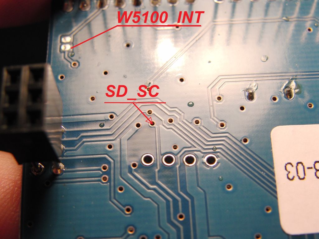

    With the trace cut we can turn the board over and find a good spot to "tap into" the signal:

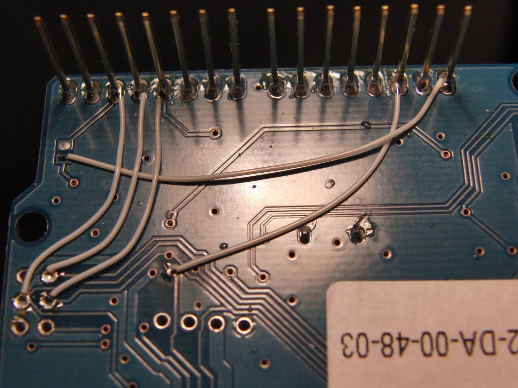

    Running a wire from the via marked SD_SC to RB2 and a wire from the pad marked W5100_INT to RB0 is all it takes to "free up" the AMICU18's SPI pins so we can use them.

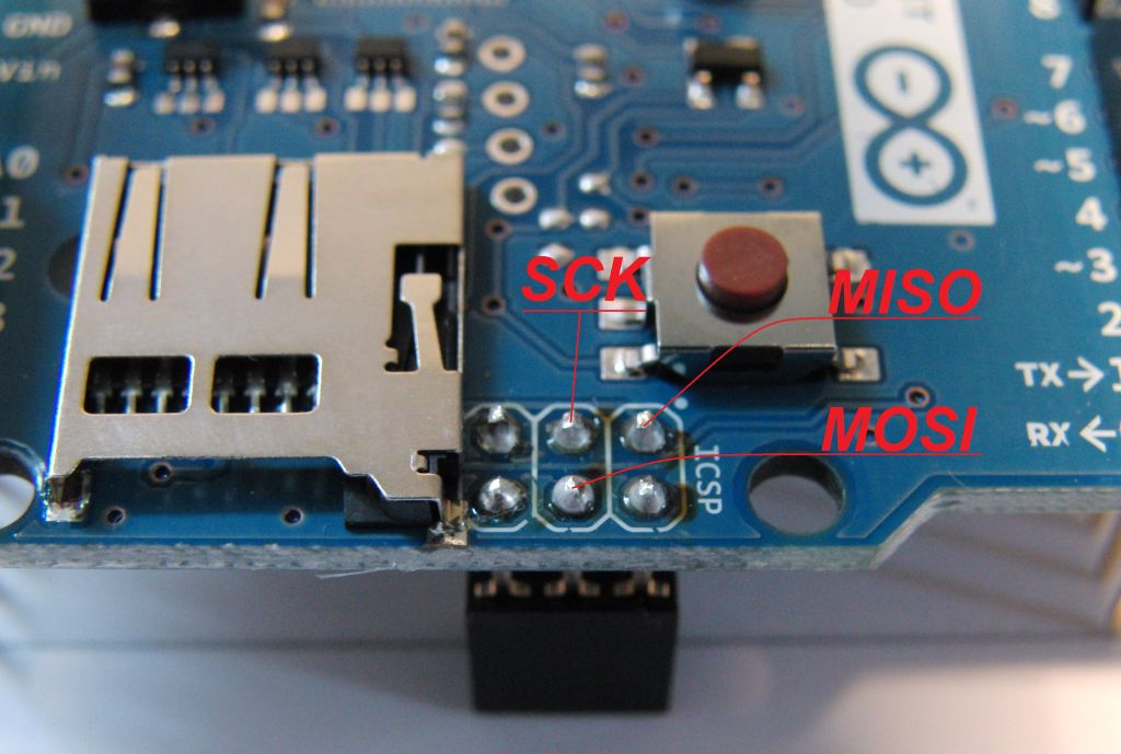

    In the next photo I've marked which pins in the ICSP header that we're interested in. SCK goes to RC3, MISO goes to RC4 and MOSI goes to RC5. I opted to remove the header altogether because it has a slight interference with the socket for the 18F25K20 on the AMICUS18 board.

    Here's the the back of the board with the modification complete. One trace cut and five jumper wires and we should be good to go. (I guess you can't really call that "Arduino shield compatible"....)

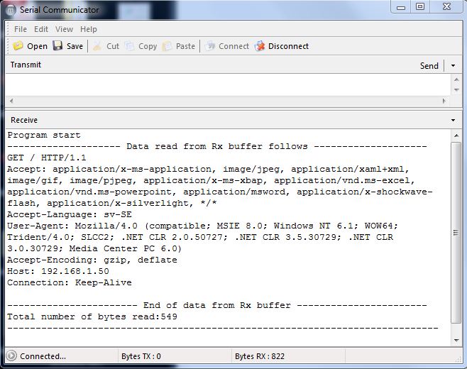

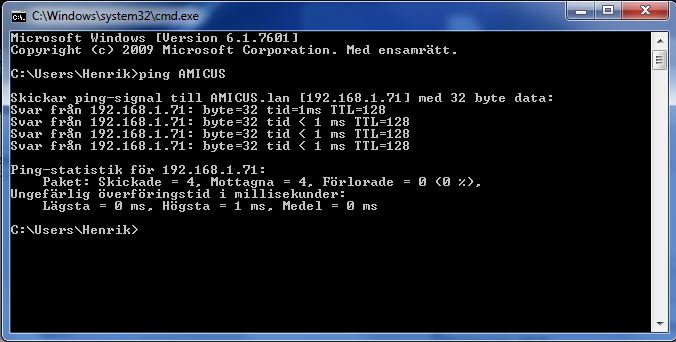

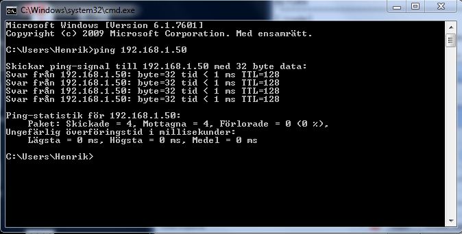

    By the way, I've got PING working....and I've got to a point where I can see the HTTP Get request in the W5100 Receive memory buffer :-)
    (Sorry about the Swedish screenshot but you'll get the idea...it works...)

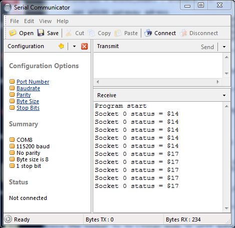

        WizAdress = W5100_S0_SR : GOSUB Read_W5100
        HSEROUT["Socket 0 status = $", HEX WizData,13]
        Pause 500
    Goto Main
    If you run this code with a serial terminal open and type in the W5100's IP-adress in a browser you should see the sockets status register changing from $14 (Listen) to $17 (Established):
    Name:  Socket status output.jpg
    ...to be continued in the next post.

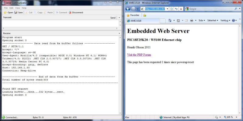

    Using the above code you'll be able to "see" the HTTP GET request issued by a web-browser pointing at the W5100's IP-adress:
    Name:  HTTP Get request.jpg
    To this post I've attached the exact file I compiled to arrive at the screenshot above (remove .txt extension), you'll also need the W5100_defs.pbp posted earlier in the thread.

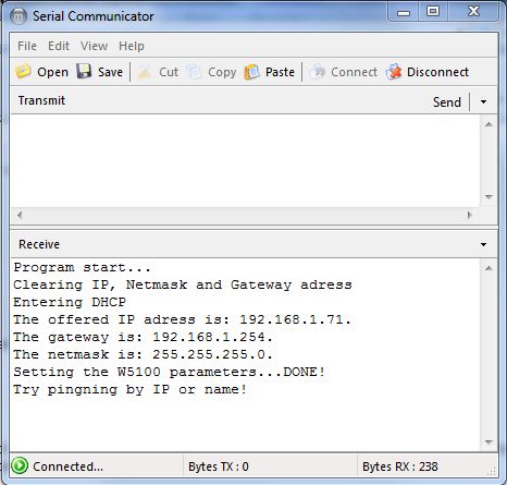

    I now have a working DHCP client. This means I can just plug in the network cable and the thing gets an IP-adress from the DHCP server (my router in this case). It also passes a host name to the DHCP-server which then somehow passes that on to the DNS server that apparently runs on the router. In the end it means that I can now get to it by browsing to http://amicus or whatever name I wish the unit to have - good times :-)

        Counter = 0                                 ' Start loading the local array buffer at the beginning.
        ' Do we have a buffer wrap around condition?
        If WizEnd < WizStart THEN
        ' When that happends we need to start reading at the first byte in the received
        ' package and go on until the end of the sockets RX memory....
            For WizAdress = WizStart to W5100_S0_RX_END
                Gosub Read_W5100
                HSEROUT[WizData]
                ' Make sure we don't write outside of the allocated buffer.
                If Counter <= BufferSize THEN
                    Buffer[Counter] = WizData
                Counter = Counter + 1                ' Keep count
            NEXT
            ' ...then we need to start over at the beginning of the buffer and keep reading
            ' until we've got all the bytes in the buffer.
            For WizAdress = W5100_S0_RX_START to WizEnd
                Gosub Read_W5100
                HSEROUT[WizData]
            NEXT
        ELSE                                         ' There's no buffer wrap-around.
            ' WizStart now contains the physical adress of the first byte to read.
            For WizAdress = WizStart to WizEnd
                Gosub Read_W5100
                HSEROUT[WizData]
            NEXT
        HSEROUT [REP "-"\23, " End of data from Rx buffer ", REP "-"\23, 13]
        HSEROUT ["Total number of bytes read:", #Counter,13]
        HSEROUT [REP "-"\76, 13, 13]

    As you can see we are no longer disconnecting and closing the connection at the end of the GetData routine, the reason is obviously because we intend to send a response to the client so we need to keep the connection open until we've done that.
    Now that we have the data in our local array Buffer (or at least the first 128 bytes of it) we are ready to start analysing it in order to determine what the client wants. Looking back at the screenshot of the received data being printed to the serial terminal we can see that simply browsing to the W5100's IP adress results in the first couple of bytes in the buffer looking like this:
    GET / HTTP/1.1
    What we're interested in here is the GET part, that is what the client wants to do - it wants to GET something from our server. The client could have specified a specific resource to get after the first forward slash, like
    GET /thatpage.html HTTP/1.1
    But for now we won't look at serving more than a single resource so as soon as we see the word GET we know we should respond with the webpage we've got in the PIC. Here's a very simple routine to parse the buffer, starting at the beginning:
    ' Very simple routine to parse the data in the local buffer.
    ' If the first word is GET we set a semaphore signaling the main program that we've got
    ' a GET request.
    GetRequest VAR BIT
    ParseData:
    If Buffer[0] = "G" THEN
        IF Buffer[1] = "E" THEN
            IF Buffer[2] = "T" THEN
                IF Buffer[3] = " " THEN
                    GetRequest = 1
                    HSEROUT["Found GET request",13]
    Once we've found the word GET at the very beginning of the received data we're going to respond with a simple web-page. To do that the first order of business is to determine the amount of free space in the socket transmit buffer and where it wants us to start loading the data. This is done in a similar way to checking the RX-buffer, in fact we're reusing the same variables (WizPtr, WisStart and WizSize) for this purpose.

    Note that I don't actually verify if the data I'm about to load will fit in the amount of free space provided in the sockets TX memory. Not doing that should be considered bad practice but for now I'll do it anyway since I know that the size of the buffer is more than 6 times the size of the data I'm writing to it.
    Now all we need to do in our main routine is to:
    1) Check the received size register of the socket, if it's >0 we'll handle the received data using the above routines.
    2) Since we're closing the socket after sedning the data it's the main routines job to re-open it and set it to listen mode.
    HSEROUT ["Program start",13]
    GOSUB Init_W5100   ' Reset W5100 and set MAC, IP, NetMask and Gateway adress,
        ' The socket 0 status register automatically switches to SOCK_ESTABLISHED
        ' when a valid request to connect comes in from a client.
        If WizData = W5100_SOCK_ESTABLISHED then
            Gosub CheckBufferForData
            If WizSize > 0 then
                GOSUB GetData
                GOSUB ParseData
                If GetRequest = 1 then GOSUB HandleGetRequest
        ' If the socket is closed (we're closing it in the GetData routine) then
        ' we must re-open it so we are prepared for the next client request.
        If WizData = Socket_CLOSED THEN
            GOSUB Init_Socket_0
    Pause 250
    Goto Main
    To this post I'm attaching the source file (remove the .txt extension and you'll need the W5100_defs.pbp file as well) I used to arrive at the following results:
    It compiles to 5275 bytes out of which the ArrayWrite statements (with a total of ~340 bytes of HTML) occupies 2038 bytes - yikes. So, without the HTML we're looking at less than 3.5k for the actual server code - not bad.

    PS. DHCP is now working nicely, with proper handling of leasetime and renewal of lease. Very cool but it adds about 3kB and 42 bytes of RAM to the total footprint when included, I'll try to get that down a bit further.

    Time for an update. As I wrote in the previous post I've had DHCP working nicely and today I thought it was time to show you how it can be used. However, for this to work nicely, there had to be some changes made to the overall structure of the package of files used. It gets easier to USE but a tad more complicated to maintain. I won't go into specific details, just give you the overall picture.
    First of all, the code now requires PBP3. This is beacuse I've added a bunch of conditional debug statements in the code making use of the wonderful conditional compilation feature of PBP3. For example, you can add #W5100_DEBUG_LEVEL 1 to the top of the code and you'll get a whole bunch of data sent over the USART, if you want even more details do #W5100_DEBUG_LEVEL 2. Do note though that these takes up a lot of program space so if the application grows they might not fit when "activated".
    The main include file for using the W5100 is called W5100.pbp and that's what you should included from the main program/application. It is also in THIS file that you may need to make some changes to match your project:
    1) BufferLenght CON 256 - This is the length of the local buffer (array) that gets declared, you can change this to match your needs. Don't make it too small though, the DHCP routines - if you're going to use those, requires a lenght of ~48 minimum.
    2) MAC-adress - This is the hardware adress of the device, change as needed - and please DO change it, don't use mine! As can be seen the MAC adress is defined as constants and can therefor currently not be changed at runtime - this MAY change or you can change it yourself.
    3) W5100_Select VAR PortB.5 - this is the PIC-pin to which ChipSelect pin of the W5100 is connected. My modified Arduino Ethernet Shield uses PortB.5
    This file (W5100.pbp) then includes two more files - W5100_defs.pbp (which we've looked at before) and W5100_subs.pbp which contains several of the routines discussed in earlier posts as well as others. Neither of these files 'should' need to be edited.
    In previous "exercises" we've hardcoded the IP-adress, netmask and gateway address of the W5100 - for DHCP to work properly this can't be done. So I've declared three arrays (in W5100_subs.pbp) called W5100_IP, W5100_Netmask and W5100_Gateway - all 4 bytes long. To set the network parameters of the W5100 we can now do something like:
    W5100_IP[0] = 192
    W5100_IP[1] = 168
    W5100_IP[2] = 1
    W5100_IP[3] = 100
    W5100_NetMask[0] = 255
    W5100_NetMask[1] = 255
    W5100_NetMask[2] = 255
    W5100_NetMask[3] = 0
    W5100_Gateway[0] = 192
    W5100_Gateway[1] = 168
    W5100_Gateway[2] = 1
    W5100_Gateway[3] = 254
    GOSUB Init_W5100
    The Init_W5100 subroutine uses the above arrays and sets the parameters of the W5100 accordingly.
    To be continued in the next post....
    3,612
    Default Re: Using the Arduino Ethernet shield with AMICUS18 (Joint forum project?)
    ...continued from previous post.
    OK, Dynamic Host Configuration Protocol - DHCP.
    DHCP is used to automatically configure a networkdevice without actually knowing anything about the network it's attached to. There are hundreds and hundreds of pages to read about how it works so I won't cover it in much detials, just give a basic overview.
    The process starts with the client sending out what's called a DHCP Discover message. This is sent as a brodcast message meaning it's addressed to any and all DHCP servers on the current subnet. One, or more, servers(s) will respond with a DHCP Offer message containing an offer for a lease of a specific IP adress for a specific amount of time. The client can then selects one of these offers and sends a DHCP request message, still as a broadcast message but it has now filled in the server it wants to use in a specific field in the message. If everything goes well the server responds with a DHCP Ack message meaning that it has now reserved the IP-adress for the amount of time specified and the client is free to use it. The client is NOT allowed to start using the IP-adress untill a valid DHCP Ack message is received. Along with the IP adress the server also provides other important setting such as the netmask and the gateway adress.
    Like I said, this is just the basic outline of the process - there are alot of details to get into, which we don't have to do right now.
    The DHCP implementation for the W5100/PBP3 is supplied as three files. The main file to include in your project is DHCP.pbp It's also in this file that a change or two may be needed. At the top, you'll find this:
    HostNameLength          CON     6           ' <- Change this to match the length of the name.
    HostName                VAR     BYTE[HostNameLength]
    HostName[0] = "A"
    HostName[1] = "m"
    HostName[2] = "i"
    HostName[3] = "c"
    HostName[4] = "u"
    HostName[5] = "s"
    This is the host name that is supplied to DHCP server. It then (if it has the functionallity) passes it on the DNS server and the end-result is that the client device can be accessed by name, ie you can browse to http://amicus instead of trying to remeber the IP-adress. What you need to change is the HostNameLenght so that it matches exactly the lenght of the array containing the name you want to use. As in the example above the name is 6 bytes long therefor HostNameLenght is 6.
    The DHCP.pbp file then includes two more files, DHCP_subs.pbp and DHCP_defs.pbp - neither of which 'should' need any editing for normal use.
    As with the main "driver" files for the W5100 I've added a while bunch of debug-messages to the DHCP code. These can be enabled by adding a #DEFINE DHCP_DEBUG_LEVEL 1 or #DEFINE DHCP_DEBUG_LEVEL 2 to the application. Again, these adds quite a bit of code.
    When the DHCP process is complete we can get the network setting to use from the arrays DHCP_IP, DHCP_NetMask and DHCP_GateWay and use these to initilise the W5100.

        ' At this point we should have received a set of valid network paramters from
        ' the DHCP server on the network. Let's start by simply printing them out.
            HSEROUT["The offered IP adress is: "]
            For i = 0 to 3
                HSEROUT[#DHCP_IP[i], "."]
            NEXT
            HSEROUT[13,"The gateway is: "]
            For i = 0 to 3
                HSEROUT[#DHCP_Gateway_IP[i], "."]
            NEXT
            HSEROUT[13, "The netmask is: "]
                For i = 0 to 3
                HSEROUT[#DHCP_NetMask[i], "."]
            NEXT
        ' The DHCP engine does NOT actually SET the IP adress for us, it just TELLS
        ' us what to use. We must make the changes ourselves:
        HSEROUT[13,"Setting the W5100 parameters..."]
        For i = 0 to 3
            W5100_IP[i] = DHCP_IP[i]
            W5100_GateWay[i] = DHCP_GateWay_IP[i]
            W5100_NetMask[i] = DHCP_NetMask[i]
        NEXT
        ' Now re-initilise the W5100 with the new network parameters.
        GOSUB Init_W5100
        HSEROUT["DONE!",13]
        HSEROUT["Try pingning by IP or name!",13]

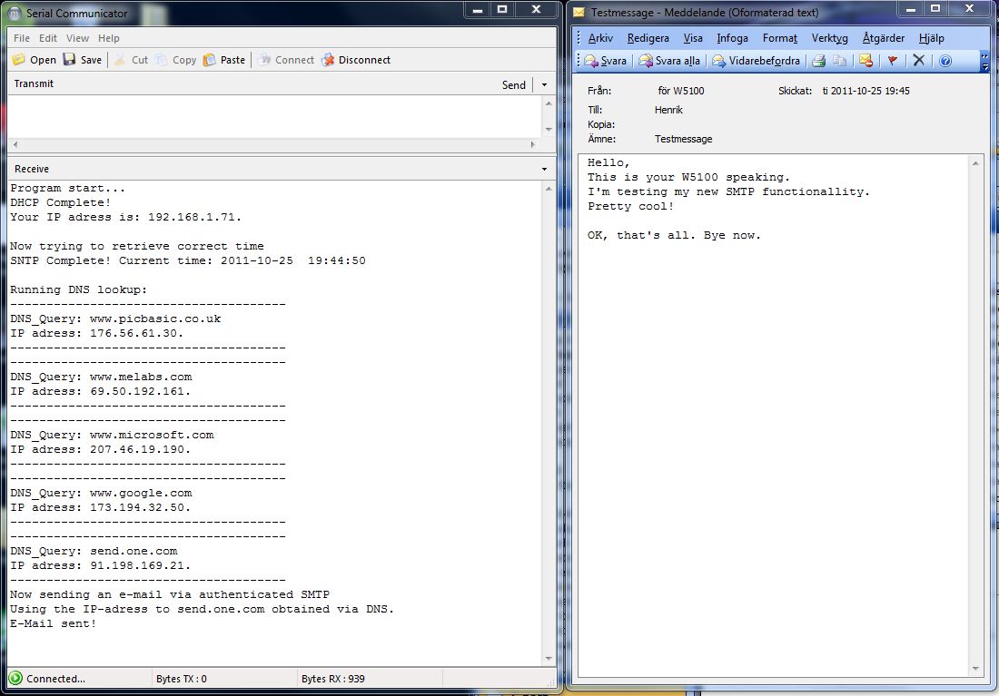

    Just thought I'd give those with interest in this project a short update of what I've been doing.
    Take a look at the following screenshot:
    The screenshot itself is pretty self explainatory but I'll do a short explanation of what is happening (it's quite a bit).
    At bootup the DHCP code is executed to retrieve the network parameters from the DHCP server, then the W5100 is configured with those parameters. Then the SNTP code is executed to retrieve current time from an SNTP server on the net. Then a series of DNS queries are run, looking up the IP-adress of some well known URL's. The last URL that DNS queries is the SMTP server for my email account. Once it gets that IP-adress it uses it in the SMTP code to login to my account, using authentication (no encryption just AUTH LOGIN (BASE64 encoded username and password)), and sends an email to my account - which you can see next to the serial terminal.
    There is one thing I don't get though. Browsing to to the IP-adress retrieved by the DNS code gets me to the correct places in all but ONE instances, namely THIS SITE. If I PING www.picbasic.co.uk I get the same IP as my DNS code and if I run Wireshark and browse to www.picbasic.co.uk its DNS-records shows the same IP-adress but if I browse to that very same IP I do not end up here. I'm pretty sure it's not an error in my code since every other URL I've tried seems to work. It has to be something specific with where and how this site is hosted. Anyone know, and can explain, what's going on?
    Anyway the DNS code currently "only" handles normal queries, not reversed or any other type, like MX etc. It does handle both direct type A responses and CNAME responses, either single or "nested". For example, the query for microsoft results in a response with no less than three CNAME records (aliases) before finally arriving at the IP-adress shown.
    That's it, just wanted to show you what's going on at my end. If anyone else is doing anything cool, please tell!
