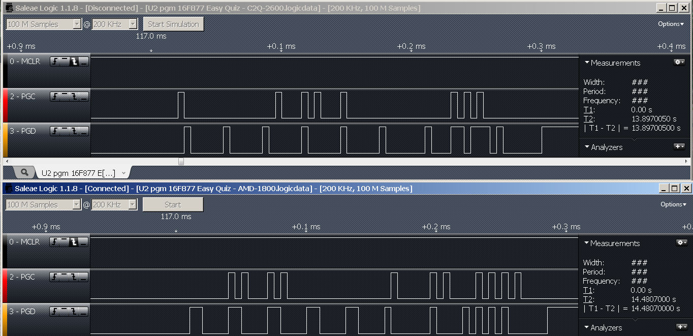

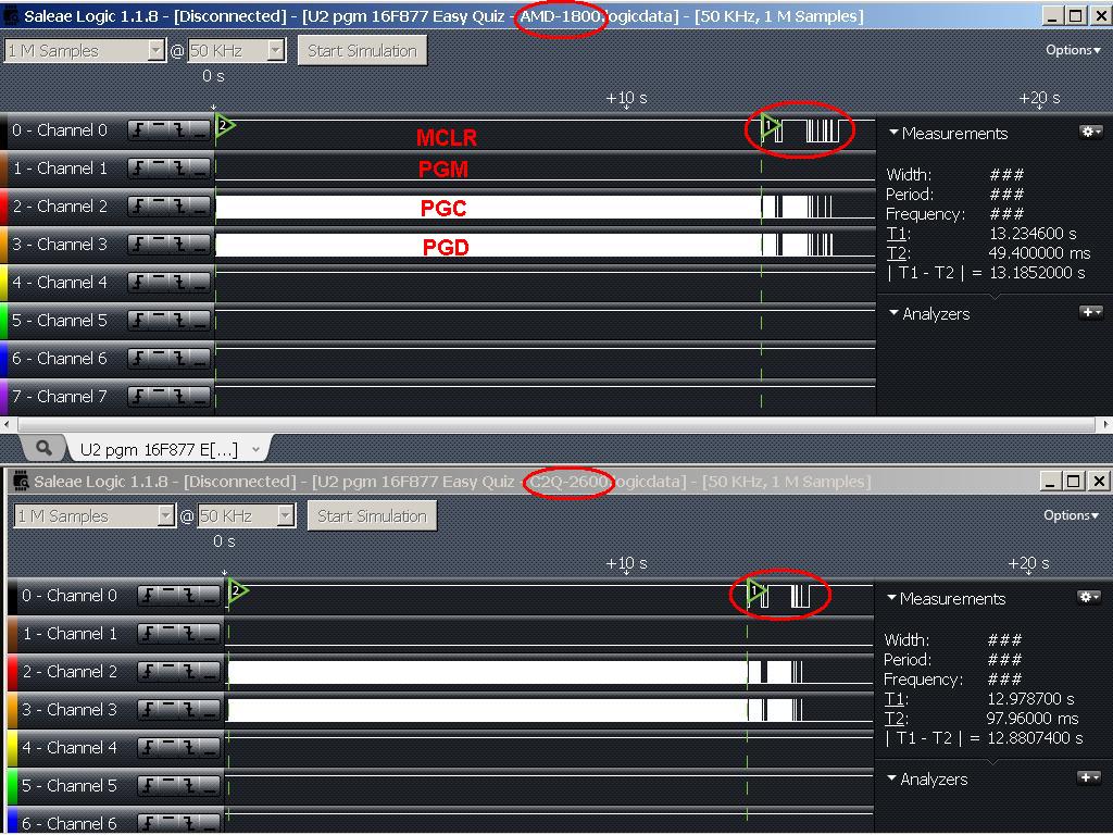

    So I decided to connect the Saleae Probe using identical settings and see what's going on. MCLR has apparent differences right away at end of programming cycle. PGC and PCD also have differences but I didn't bother trying to get pics of those.
    I would have liked to get faster sample rates, but there's a limit to the buffer size; the faster you go, the less time you can collect.

    I'm afraid I currently have no idea what your actual problem is and I don't see any apparent difference between the two screenshots, what is the problem that you see on the trace? Anyway, I thought I'd write you a line about LOGIC.
    Yes, there's a limited amount of samples but surely you can have more than 1M AND higher samplig frequency. On a slow(ish) computer you might not be able to reach 24MHz but you should be able to go WAY up from where you are now. Just select, say 10M samples at 500kHz instead. Or does that not work for you for some reason?
    You can give each channel a name in the software, just click on the text Channel 1, Channel 2 etc and punch in your name. That way you don't have to photoshop that in later.
    I don't see you have any trigger set up, did you capture it "on the fly"?

    Yup, no trigger. I just watched the programmer messages and started the sampling as soon as the Verification step finished.
    I started at 1M but the sampling ended quickly. The slower the speed, the more time the sampling lasted. The programming step lasts over 10 seconds so I had to go all the way down to get it all.
    Thanks for the labelling idea, didn't read the manual yet. I just wanted to try something with my new toy and thought that it might help figure what is wrong with the U2 on only 1 PC.

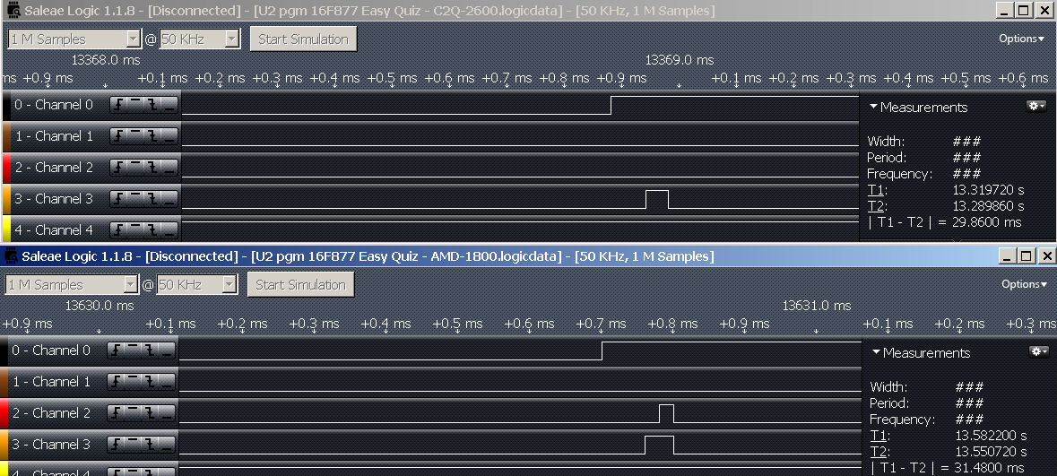

    Here's a zoom of the end of the programming cycle (sorry, I inverted the PCs from the pervious pic).
    Name:  U2 pgm 16F877 Easy Quiz - Compare zoom.jpg
    EDIT: There's a bit more activity on the bottom chart from 14.7s, and that's the PC that programs properly.

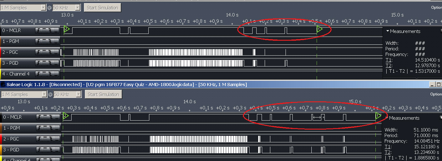

    There's also activity on PGC on the AMD PC after 13.6s. I went back for a better pic in case it was an issue with the zoom not yet picking up a short signal:
    Name:  U2 pgm 16F877 Easy Quiz - Compare zoom max.jpg
    I'm definitely missing pulses on the C2Q PC and have no clue why that would be.
    Either something is wrong with the USB ports, which is unlikely 'cause every other device works properly; gaming wheel/yoke/thrust quadrant/joystick, mouse, keyboard, digital camera, logic probe, etc.
    Or something is wrong with the U2 programmer at the driver level, 'cause the hardware works properly on the other PC.

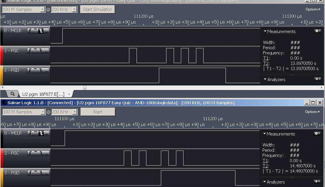

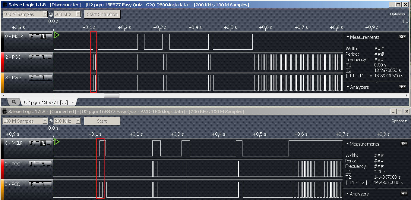

    I upped the rate to 100M@200KHz.
    (the bottom PC is the one that programs properly)
    This is the start of the programming step:
    Name:  U2 pgm 16F877 Easy Quiz - Pgm start.jpg
    At first glance things look practically identical. The only thing I haven't figured yet in Logic is how to get the same zoom ratio to make it easier to visually compare 2 windows.
    This is a zoom on that very first PGC signal from the red box:
    Name:  U2 pgm 16F877 Easy Quiz - Pgm start A.jpg
    The PGC signals are somewhat delayed relative to PGD.
    And this is the second PGC signal:
    Name:  U2 pgm 16F877 Easy Quiz - Pgm start B.jpg
    An even bigger difference in signals.
    I guess I'm stuck to using the old Pentium 4 until I figure this out.
    (I have to say I love my Saleae logic probe)
