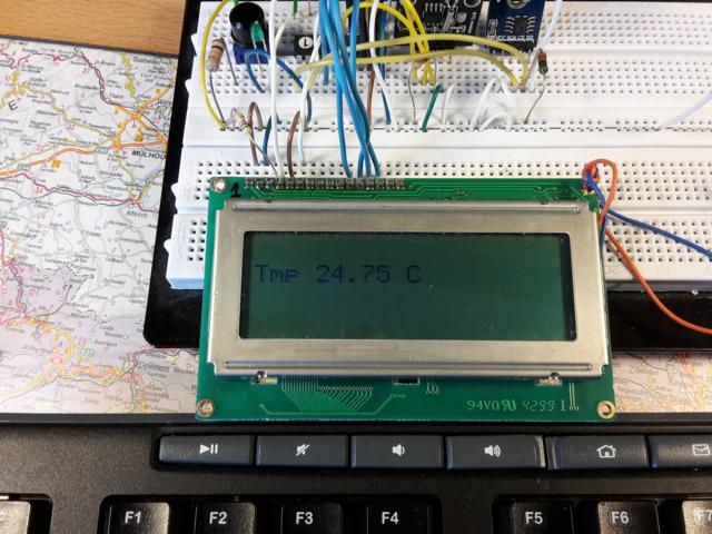

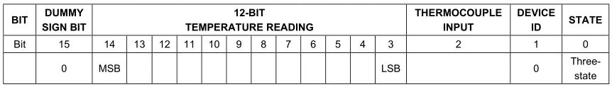

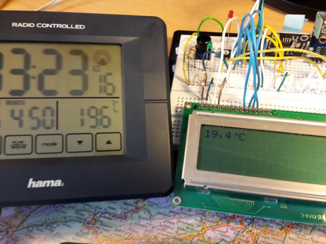

    Hi,
    It's my first time using a MAX6675 k-type thermocouple converter and got it to work thanks to (99%) of the info in this thread .
    AAMOF, I had to modify one info found above and it is about bit shifting.
    First, my working code (and hopefully correct) is:

    According to the MAX6675 datasheet: "Read the 16 output bits on the falling edge of the clock. The first bit, D15, is a dummy sign bit and is always zero. Bits D14–D3 contain the converted temperature in the order of MSB to LSB".
    If I get it well, when reading the termocouple, I get 16 bits and I need to "keep" bits 14 to 3.
    Name:  2017-04-15 21_53_35-MAX6675K-Type Thermocouple IC.pdf - SumatraPDF.jpg
    So, to get the (what I hope is correct) right value, why do I have to shift by "2" instead of what has been said above (shift by 3) or even shift by 1 since bit 14 is the second bit to start with?
    Roger

    Default Re: Having trouble with SERIN command and MAX6675
    the data can be read in msb first by shiftin but it is then translated to a normal binary representation so bit 14 is read as bit 14.
    shifting by 2 is incorrect , as dave indicated
    Temp = RawTemp >> 5
    will get the high 10 bits of the 12bit reading ,resulting in the integer component of the reading
    or
    Temp = RawTemp >> 3
    int_part=temp/4
    fract_part=(temp//4)*25
    lcdout $FE, $C0,"Tmp ", #int_part,".",dec2 fract_part," C"

    This is confusing to me.
    My code gives me almost exactly what my home thermometer shows:
    This code
    Temp = RawTemp >> 3
    int_part=temp/4
    display this:
    Where is the truth?

    for a start your temp var is a declared as byte , how can 12 bit reading fit in that ?

    Anyway, I understand the calculation to get the temperature value BUT why do I have around 5°C diffrence between the thermocouple and my home thermometer?
    Must a thermocouple be kind of "adjusted" (correct the result in the code) or something like that?

    if you have cheap ebay sourced k type probes a reading of 5 -+ is typical , they seem more accurate [precise anyway] at higher temps >200c
    but there is still a fair spread of variation in the readings
    how to interpret reading
