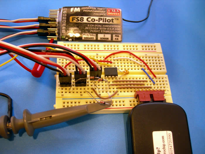

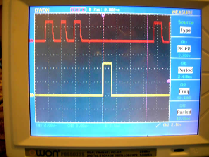

    This code decodes 5 channels from an RC receiver, and ouputs 4 servo channels on GPIO pins 0,1,4 and 5. It uses hardware capture on the CCP1 pin, and Darrel Taylor interrupts to measure the pulse widths, and also uses DT_INTS to build the pulse widths out. The Main: is where you could perform more math on the pulse widths before they are pulsed out.
    For getting the 5 channels in, the signal wire on channels 1, 3 and 5 must be connected to diodes (I used 1n914's) and the diodes must all be connected to the CCP1 pin. Channels 2 and 4 are measured using end and start of channels 1, 3 and 5.
    Currently 313 words long.

    Quote Originally Posted by rmteo View Post
    What is the purpose/function of this?
    Good question. Think of it as a platform. Most applications I can dream up for it are RC based.
    Say you have a simple minded receiver and transmitter, but you want to do your own aileron/rudder/elevator mixing - go ahead, just write some code. Even do some IR leveling of your plane ... go ahead...
    Say your receiver gives some bogus pulses out when it looses your transmitter signal for a second or two - you can filter these out, go to last good signal, or a default setting for that servo.
    Say you want to build an autonomous vehicle, but still have the option of controlling it with your transmitter. Set autopilot on/off using channel 5.
    Say you want to build an altitude hold circuit. This is a perfect platform. (Ok, maybe not quite perfect yet, but should be close once I sync to ch1)
    Since all the pulses are done using interrupts (and no blocking loops like pause, pulsin, pulsout), there is a lot of time in between to do what ever you want it to do.
    What's the use of the PIC, why not simply connect 4 servos direct to the RC receiver and get the same result ?
    Because then you could not do any of the above.

    Feb 2006
    Gilroy, CA
    1,530
    Default Schematic and picture
    Here is the schematic and picture of the project.
    Above are the three input pulses in red, and servo4 output in yellow
    Project page: http://www.scalerobotics.com/stamps/...ssthrough.html
