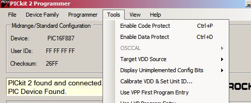

    Angry Not a happy camper....
    Suddenly and without warning my PICkit2 programmer is not doing its job. See this picture. Any ideas? I can get rid of the Code Protect by erasing. Then it comes back. The memory error just starts happening...
    NUTS! Or am I repeating myself.
    Ken
  11. #171
    Maybe it got turned on here?

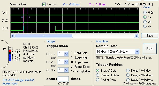

  17. #177
    Nov 2009
    Fitchburg, Mass
    483
    Default Last picture for tonight
    Channel 2 is PULSOUT.
    Channel 3 is the corresponding PULSIN.
    PULSOUT is waaayyy to long. It is supposed to be 20 microseconds since I am using the 4meg oscillator and my command is
    PULSOUT trigfront 2
    PULSOUT is about 14 millisec according to the LOGIC TOOL. See picture. Oops. The forum won't honor my request to upload the picture. You'll have to take my word for it.
    Any ideas?

  19. #179
    2,817
    Hi Ken, Are you still using 16F887. If so PortB is lousy with analog functions, just waiting to be disabled.
  20. #180
    Nov 2009
    Fitchburg, Mass
    483
    Default I don't understand
    Joe,
    Are you saying that all I need to do to use PORTB is figure out how to appropriately configure it?
    If so, please give me a hint? I am soooo close.
    Ken

    Default I think I've got it. By George I've got it.
    My problem was that the length of the PULSOUT pulse was way toooo long. This was true even if I did a PULSOUT trigfront, 1.
    So I changed it to:
    HIGH trigfront
    PAUSE 1
    LOW trigfront.
    It seems to respond correctly on its blocks with me moving a oak cutting board in front and on the right side to simulate inside a room with no furniture.
    The battery needs charging and I need to neaten up the bundle of wires. I feel a video might not be long in coming.
    Thanks, gang. Whomever you are.

    I took the car to R/C Excitement yesterday and gave it a try. It worked quite well. It followed the wall then negotiated the left turns to go completely around the room. It was fast. I had to run to keep up. The wall following was too zigzag. Classic case of over compensation.
    Took it to R/C again today. It did not work at all well. I screwed something up!!
    Question: What makes the 16F887 reset or restart. I know a power glitch will do it, but I don't see how that can be. Possibly an inductive surge from telling the motor to reverse itself without first telling it to stop. That might do it. I am changing my code so that can not happen. What else? Anything?
    Another question. Have any of you seen a PBP command snippet that interprets an incoming PWM signal and puts it into a register so that I can do IF statements like, "IF signal < 110 THEN ....." There's some code in the Q&A article in this month's SERVO magazine that seems to do that, but not in PBP.
    Ken

    If it is just the pulse measurement that you need, a simple:
    (w = pulse width)
    PULSIN PWInputPin, 1, w
    will get you there. But you must call this quite regulary if you need updated values.

    Default Of course you are correct
    I was not thinking. I am already using PULSIN to measure the echo from the sonar pinging. My code goes round and round. All I want is the signal from channel 3 on the RC receiver that toggles from RC control to PIC control and visa versa.
    ken
