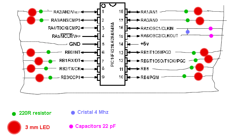

    Jerson, it's not working.
    Really, the last 15 lines of my sequence are crucial. I knew that before your message, but i also tried your solution and of course it did not want to take it, it gave 30 errors ! ... are crucial, don't know FOR WHAT, lol, but are crucial, haha. OMG i'm finished
    Here is my schematics;
    Thanks everybody.
    Let's see now, it's a very simple circuit. I need to solve problem 1, at least.

    If you're using an external oscillator, and the "A" version, you'll need the modified version.
    Note your original config had it set for internal osc.

    Bruce, chaser2.asm makes the MCLR pin ssso sensible it turn the A0 led ON by just hovering the hand over the pic at about 15 cm... The circuit has transformed into a kind of "human bioelectric field detector" effective up to 15 cm
    This happened after i attached a wire to MCLR pin. The wire is now "in the air" and was intended to connect the pin to a PCB switch, but only by soldering it to MCLR pin it made everything uncontrolable...
    Before soldering the wire, the sequence was able to be started by only touching the MCRL pin with a metal, without even being conected to the GND.
    I only have here now some variable resistors 0-3K... you said something about a pull-up resistor, which i don't even imagine its shape... and function.
    Can you help ?

       movlw   0x07
       movwf   CMCON    ;turn comparators off (make it like a 16F84)
       clrf    PORTB    ;clear all port latches before setting TRIS regs
       clrf    PORTA
       banksel TRISA    ;select bank 1
       movlw   b'00100000'
       movwf   TRISA    ;set PortA outputs, RA5 = /MCLR input
       clrf    TRISB    ;set PortB all outputs
       banksel PORTB    ;select bank 0
    Loop
       BSF    LEDPORTA0, LEDA0  ; RA0 ON
       movlw  d'4'    ; execute delay this number of times
       movwf  times
       call   Delay
       movlw  b'11111111'
       movwf  LEDPORT
       movwf  times
       call   Delay
       movlw  b'00000000'
       movwf  LEDPORT
       movlw  d'4'
       movwf  times
       call   Delay
       movlw  b'11111111'
       movwf  LEDPORT
       movlw  d'4'
       movwf  times
       call	  Delay
       movlw  b'00000000'
       movwf  LEDPORT
       movlw  d'4'
       movwf  times
       call	  Delay
       movlw  b'11111111'
       movwf  LEDPORT
       movlw  d'4'
       movwf  times
       call	  Delay
       movlw  b'00000000'
       movwf  LEDPORT
       movlw  d'4'
       movwf  times
       call	  Delay
       movlw  b'11111111'
       movwf  LEDPORT
       movlw  d'4'
       movwf  times
       call	  Delay
       movlw  b'00000000'
       movwf  LEDPORT
       movlw  d'4'
       movwf  times
       call	  Delay
       movlw  b'00010000'
       movwf  LEDPORT
       movlw  d'1'
       movwf  times
       call	  Delay
       movlw  b'00001000'
       movwf  LEDPORT
       movlw  d'10'
       movwf  times
       call	  Delay
       movlw  b'00010000'
       movwf  LEDPORT
       movlw  d'1'
       movwf  times
       call	  Delay
       movlw  b'00000000'
       movwf  LEDPORT
       movlw  d'4'
       movwf  times
       call   Delay
       bcf    LEDPORTA0,LEDA0  ; RA0 off
       ; code above executes once, then PIC enters low-power sleep mode until /MCLR reset.
    SleepLoop
       SLEEP            ; enter low power sleep
       GOTO   SleepLoop ; go back to sleep if it wakes up
    Delay
       movlw   d'250'    ;delay 250 ms (4 MHz clock)
       movwf   count1
    d1
       movlw   0xC7
       movwf   counta
       movlw   0x01
       movwf   countb
    Delay_0
       decfsz  counta,f
       goto    $+2
       decfsz  countb,f
       goto    Delay_0
       decfsz  count1,f
       goto    d1
       decfsz  times    ; execute delay this number of times
       goto    Delay
       retlw   0x00

    It's totally uncontrollable, even with the pull-up resistor.
    Then, I don't want 2 switches, there is nobody there to reset the pin.
    The sequence must start and play with just a push&release, very short and then must standby and wait another push-start instead reseting.
    Too bad,
    We had a working solution ... but with PBP.
    Really sorry not to be able to help you further.
    Feb 2009
    7
    Default Ace
    Too bad,
    Alain, omg. I went back to your post with the working solution and i finally understood what you said... That post was posted before Bruce gave me the codes #1&#2 and at that time i was unable to think clearly.
    Ace, thanks for coming back, this time i did it; a NC push button on Vdd powering the chip and that was it. omg it was easy.
    Merci, Alain, thanks for coming back, omg.
    Thanks everybody subject closed; this configuration is good for a half million applications, even for tech processes which are not so complex.
