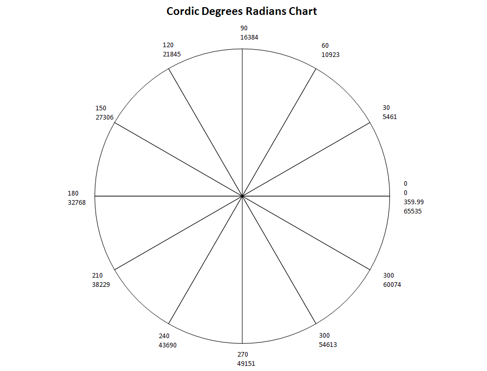

    Resolution is pretty good!
    180 degrees is covered by 0 to 32,767.
    So thats .00549 degrees per unit. Now I have not tested the total error, but I have seen it vary from expected by .015 degrees or so, but that is pretty close!
    Sin and cos return between -30,000 and +30,000 for -1 and 1. One of the cool things about the cordic, is that it returns cos AND sin at the same time. I have heard that it is 90 times faster than math.h.
    Also, this allows atan2 for a point x, y and accepts values from 0 to 32,767, and gives the hypotenuse to x,y which for me is the distance. It also gets these values at the same time!
    This way my distance values should be spot on. I am still limited to about 200 miles between waypoints, the way I am measuring the change in x, and the change in y. But I could do a divide function to break the units into something it could handle. I just have not needed to do this for my application.

    Now to make sense of your results, instead of using the strange radians from above, you get a result of -30,000 to 30,000. So converting the above results by dividing by 30,000, you get
    sin(60) = .8660333 and cos(60)= .5001333 . These results are pretty close to what I get on my calculator, .8660254 and .500000 respectively.
    For instance
    x = 25980
    y = 15000
    .....and that is 30 degrees
    My perspective was all wrong in the above post. I was supposed to be lying down and facing East, that is the radian way.
    to convert to degrees ......
    Imagine a circle with degree headings, but instead of starting at the top, and going clockwise, as the numbers get higher, we are going to do something completely different. Starting at 90 degrees, we are going to go counterclockwise while our radians rise. From zero to 32,767 is the arc from 90 degrees (through 0) to 270 degrees. To complete the circle, our arc continues from 32,768 to 65,535 as it travels from 270 degrees to 90 degrees in a counter clockwise rotation.
    So, as you can see there is just a little bit of manipulation to get the result in angle, but it really isn't too bad.
    Thanks Joe.
    For anyone else like me that forgot all they learned about radians.... This should help. These go from 0 to 65,535.

    That is the hardest part. Darn radians are 90 degrees off from the start.
    For example
    0 = 90 degrees
    5461 = 60 degrees
    10922 = 30 degrees
    16383 = 0 degrees (or North)
    21844 = 330 degrees
    32767 = 270 degrees
    38228 = 240 degrees
    and so on.....

    Moving counter clockwise from the 3 o'clock position . . .I see for every 30 degrees the numbers change 5461 or 182.03333333333333333333333333333 per degree or 65532 for a full circle which is a number that fits nicely in a word variable.
    Quote Originally Posted by Joe S. View Post
    Well now, that's better than all my blabbering! Looks like you got it down.
