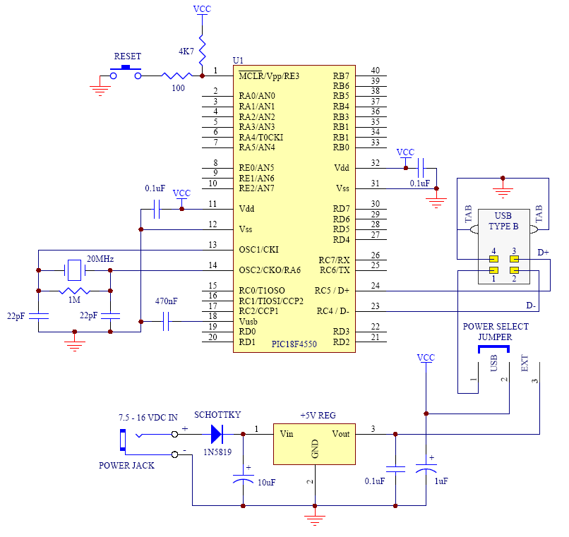

    Default USB CDC_DEMO with DT_INTS
    Here is some PBP 2.60 code (cut and pasted) from Darrel, with the "Hello World" example added in. Darrel's main code is taken from another thread, located here: http://www.picbasic.co.uk/forum/show...4292#post94292 . It uses DT_INTS ( instant interrupts ) to service the USB. As always, DT_INTS can then also be used for all types of other things, while the USB connection is kept alive.

    In case any one wants to look, here is the schematic and "manual" seeing how I am having trouble with anything tonight, (the pullups do not exist on the board), Maybe I should give this one a break for a bit.
    No, I don't have any of those chips. I was hoping to be able to get this to work on a premade board. Seems like it should be possible. One thing I don't like, with the ready made code provided by melab, It takes more time to chase down what is ( or is not) going on.
    Does it make sense that if I can use microchips USB bootloader, the hardware side of things are ok?
    -Bert

    Looks like that board can be powered from the USB port. Is that what you are doing? If so, try powering it from another source.
    Are you connecting the board for testing to the same machine PBP is on? If not, did you copy mchpcdc.inf to the PC?
  35. #75
