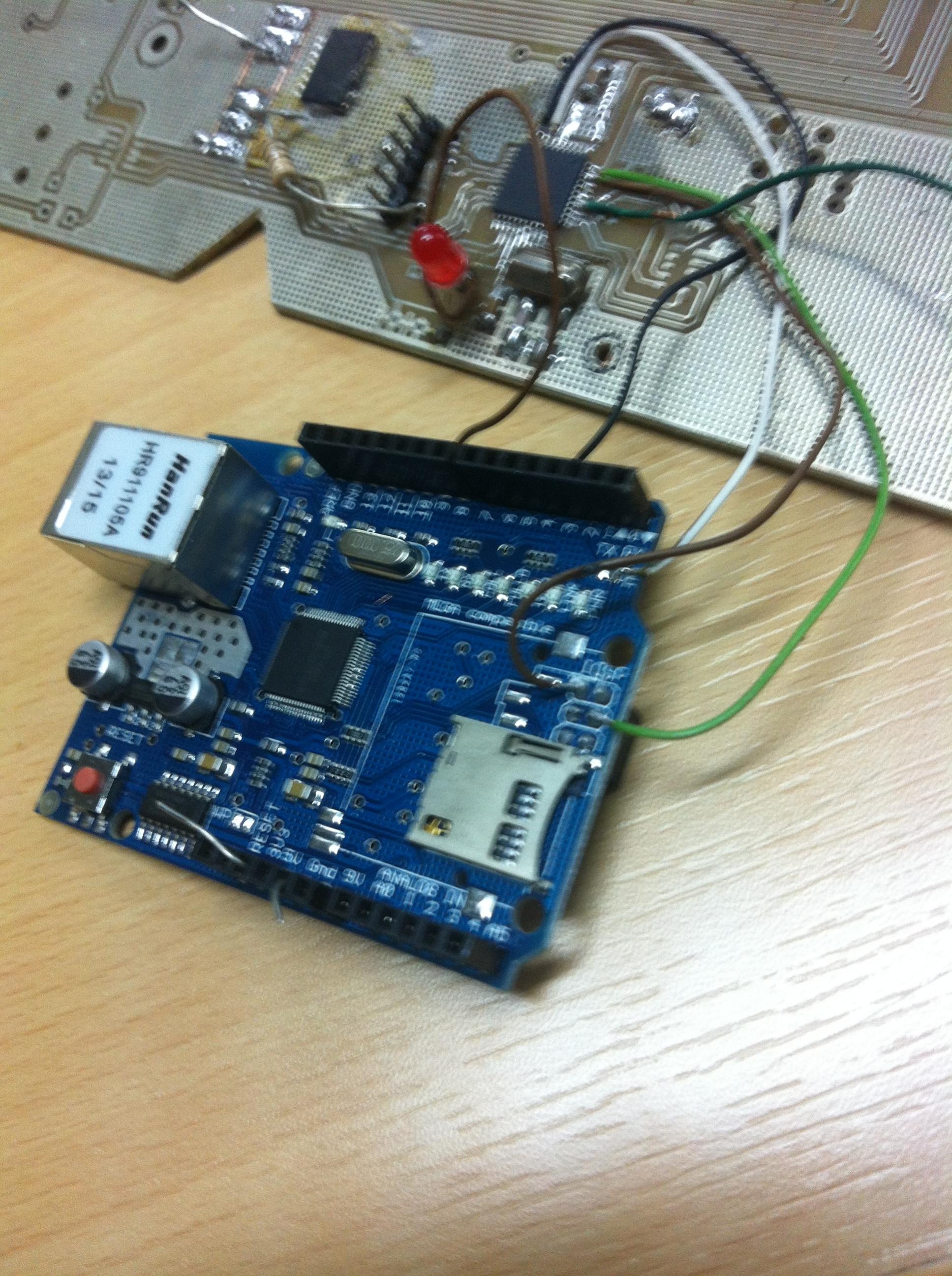

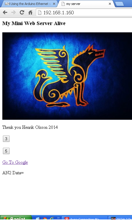

    Mar 2014
    5
    Default Re: Using the Arduino Ethernet shield with AMICUS18 (Joint forum project?)
    I agree absolutely with you the same ...
    I did, the web page, UDP, TCP, with ENC28J60. but the W5100. liked very much.
    I'm done with ping 5100.
    I'm done with protons + 18F4620 software. I've revised your ping code for the proton.
    I must take a little more now.
    I bought a new module.
    http://www.elektrovadi.com/w5100-ethernet-modul, PR-1389.html
    then I'll continue with this module.
    I wrote you about my progress from time to time. maybe I can come to the smtp portion.
    You have to believe that I'm the one who worked very hard
    ty for help.. If there is a flow diagram with smtp me if he could be good enough for me.
    bye

    hello henrik
    thanks you for help and the pbp source code,
    i was modifie your code for proton basic , and i was use 18F4620 , now wprking very stabile.
    my web server
    - ping it is ok!
    - web server it is ok
    - send get ang command it is ok
    - response and data it is ok
    but i have any problem,
    it is my html code,
    how to use scrip in to do code?
    index:
    Buffer = "<html>" : GoSub PutStringInTXBuffer
    Buffer = "<body>" : GoSub PutStringInTXBuffer
    Buffer = "<title>my server</title>" : GoSub PutStringInTXBuffer
    Buffer = "<h3>My Mini Web Server Alive</h3>" : GoSub PutStringInTXBuffer
    Buffer = "<img src=http://www.enkatechnology.com/12.jpg >" : GoSub PutStringInTXBuffer
    Buffer = "<p>Thenk you Henrik Olsson 2014</p>" : GoSub PutStringInTXBuffer
    Buffer = "<form name=input action=/ method=get>" : GoSub PutStringInTXBuffer
    Buffer = "<input type=submit align=center name=tst1 value=3 />" : GoSub PutStringInTXBuffer
    Buffer = "</form>" : GoSub PutStringInTXBuffer
    Buffer = "<input type=submit align=center name=tst2 value=5 />" : GoSub PutStringInTXBuffer
    Buffer = "<a href=http://www.google.com>Go To Google</a>" : GoSub PutStringInTXBuffer
    'Buffer = "<p> toplam request = " + Str$(Dec RequestCount) + "</p>" : GoSub PutStringInTXBuffer
    Buffer ="<p>AN2 Data= </p>" : GoSub PutStringInTXBuffer
    Buffer ="<script src=/s></script>" : GoSub PutStringInTXBuffer
    Buffer ="<p><script>document.write(AN2)</script></p>" : GoSub PutStringInTXBuffer
    Buffer = "</body></html>" : GoSub PutStringInTXBuffer
    i wat to use <script src=/s></script> and turn the back "<p><script>document.write(AN2)</script></p>" AN2 = 27 for exp. what you thing about?
    i was receive "s" and portc.2 led is blinking but, i dont send the AN2 data to back.

  20. #60
    3,624
    Nice work! I'm glad the code is getting some use!
    I know very little about HTML and even less about JAVA Script (which I suspect is what Document.Write() is?
    However, doing document.write(AN2) where I'm guessing AN2 is a variable in you PBP (Proton) program probably isn't working the way you expect. For it to work the way you've coded it the PutStringInTxBuffer routine would need to be able to decode and understand Java Script, find AN2 and put its content, as a string into the buffer - that's obviously NOT how it works or is intended to work.
    Again, I'm very green on this HTML and JAVA stuff so I may be wrong but that's how I think it works.
    In PBP, to load a "value" from a variable into an array as a string you could use ArrayWrite, I'm not sure how to do that in Proton but I'm sure there's some ToStr or whatever.
    Does that make sense?
  21. #61
    Mar 2014
    5
    it is ok, is ok! work fine...
    i will new stage , w5100 use with sd card, and screen any picture or complicate html pages. ty .. bye.
