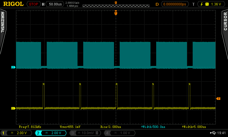

    With this post I'd like to visually demonstrate what kind of latency and overhead to expect when using DT-Ints. I'd like to point out that I am i no way criticising DT-ints, they are wonderful to work with and I could not imagine PBP without them but when you need to interrupt at high speed they are not that great and I wanted to put some numbers on it.
    To measure this I wrote a very simple piece of code, all it does is toggle an output as fast as it can. Then a periodic timer interrupt was introduced and in the actual interrupt service routine a short pulse on another output was created. Here's what that looks like on a scope:
    Name:  Overhead test 1.png

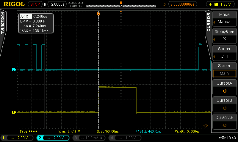

    The top (blue) trace shows the output normally toggling at a fast rate. The bottom (yellow) trace shows the pulse generated by the code in the interrupt service routine. If we zoom in a little bit we can put some cursors on the screen and measure the latency:
    Name:  Overhead test 2.png
    As soon as the interrupt trips the main code stops executing (output stops toggling) but OUR code in the interrupt service routine (which is what generates the pulse on the yellow trace) doesn't start to exectute until around DT-Ints have had to time to store a copy of the system variables which in this case takes around 7us. This PIC is running at 64MHz which means the latency on entry is roughly 112 instruction cycles.

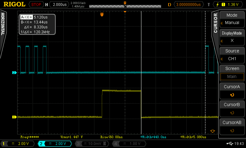

    As soon as the falling edge of the pulse occurs we're done in the ISR and DT-Ints now has to restore all the system variables, clearing the interrupt flag and so on which takes slightly longer than on entry, around 8us or 128 instruction cycles:
    Name:  Overhead test 3.png
    So, even though we're only spending 5us in the actual interrupt service routine the main routine is suspended for almost 21us - at 64MHz clock frequency. Even if no code at all was actually executed in the ISR the save and restore process that DT-Ints needs to perform takes, at the very least, somewhere around 240 instruction cycles. Now, 240 instruction cycles at 64MHz is "only" 15us which may no seem like much but if you're trying to interrupt at, lets say 25kHz you only got 40us between each interrupt. Spending 15 of those traveling to and from the interrupt plus, lets say, 5us in the ISR makes the 64MHz PIC "feel" like a 32MHz PIC. Any software timed commands in the main code (like PAUSE, SERIN, PULSIN etc) will off by a factor of 2.
    The above tests were done on an 18F25K20 running at 64MHz, using PBP 3.0.8.0 with support for LONGs disabled. With LONGs enabled the 15us overhead increases to roughly 18us or around 290 instruction cycles.

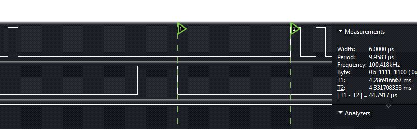

    Finally I did the test on a 16F887 at 8MHz, and came up with a 49 usec to enter ISR and around 45 to exit.

    It seems that comparing to 25K20, the 887 executes less instructions...? Is it possible?
    3,523
    Default Re: What's the interrupt latency and/or overhead when using DT-Ints?
    Apparently....
    First of all, as pedja pointed out, the number of instructions will vary slightly depending on what commands are being used by the actual code. DT-Ints saves many variables by default and some more if they're being defined. DT-Ints 14 seems to allocate 41 bytes for storing context (including W, STATUS, PCLATH and FSR) while DT-Ints 18 allocates 68 bytes.
    Out of the 68 bytes allocated 22 is never used if LONGs are NOT enabled. So if I'm not mistaken worst case for 14bit devices is 41 bytes and for 16bit devices (without LONGs) it's 46 bytes so yeah...I don't think there's anything wrong with your test.
    What surprised me a bit though is that the entry is slower than the exit, while on the 18F it's the other way around. Also, in order to be truly accurate you really need to count instructions in the listing since measuring it like this can cause it to differ a couple of instructions. But visualizing it like this is easier :-)
    3,825
    I tested and measured it many times and it was consistent exactly as you observed. Entry always takes longer.
