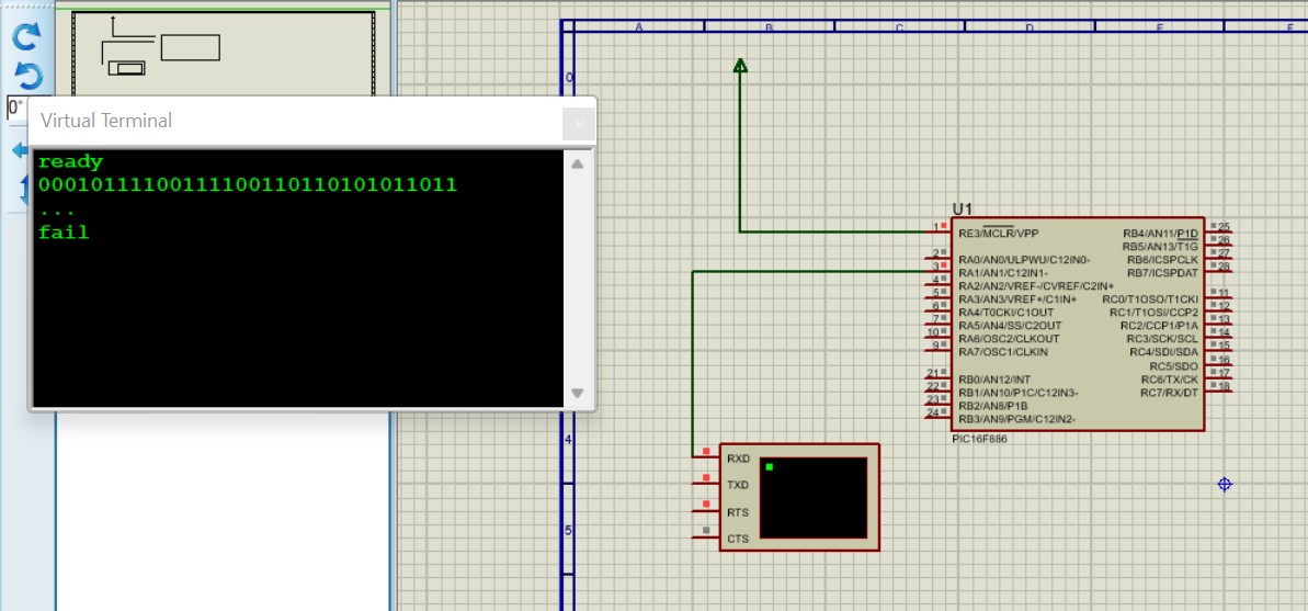

    Default Re: Data processing in array
    kinda heavy in respect of calculations.
    maybe but it has positive indication of failure , it ceases testing on failure and it actually detects failures.
    i would not be quibbling over a few words of code space when the entire process of encoding the bit stream into an unnecessary byte array
    of times instead of directly into a bit array on detection would be heaps more efficient.
    if the correct conditions can be met the pbp abs command can substituted for byte results like below

    2,719
    result of sim
    Name:  Screenshot 2022-06-04 110905.jpg
