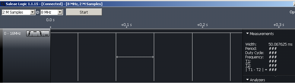

    Has anyone else had problems using DT's Elapsed Timer at 64MHz?
    When I run a 18F44K22 at 64MHz, 99 TICKS = .247 second.
    Name:  Saleae 99 TICKS 64MHz.PNG
    When I run at 16MHz, 99 TICKS = .988 second.
    Name:  Saleae 99 TICKS 16MHz.PNG
    It's as if the timer runs at a default 16MHz when the PIC is at 64MHz (exactly 1/4 speed).

    I bet this is my Saleae probe biting me in the nose again; not being able to run it fast enough.
    The interrupt is working faster, I'm probably missing signals.
    Name:  Saleae 64MHz VS 16MHz.PNG
    EDIT: And I notice I didn't align the marker the same way on Probe 1 - Port = 1 / 0, but it's the same interval as described in the WIDTH; 0.250uS, I just rechecked.

    Default Re: Elapsed timer not working as expected at 64MHz
    Roger, oveur.

    Quote Originally Posted by richard View Post
    debug T1PS and TimerConst to see what's going on would be a good start
    I started by making my version of the Elapsed include and adding 2 variables at the end of the timer calc:
    ' -------------- calc timer reload Constants -------------------------------
    T1PS = 1                             ; start with 1:1 postscaler
    TimerConst = ((OSC*1000000)/4/100)   ; how many timer ticks will it take
      while TimerConst > 65400           ; if it's more than the timer can count
    T1PS = T1PS * 2                      ;   double the postscaler
    TimerConst = TimerConst / 2          ;   halve the count
      endw
    TimerConst = 65536 - TimerConst + 8  ; final reload value
    ; ---------------------------- DEBUG SCALER --------------------------------
    DebugT1PS = T1PS
    DebugTC = TimerConst
    ; xxxxxxxxxxxxxxxxxxxxxxxxxxxxxxxxxxxxxxxxxxxxxxxxxxxxxxxxxxxxxxxxxxxxxxxxxx
    Before Main of my program I added:
    DebugT1PS CON EXT
    DebugTC   CON EXT
    Right now I'm wiring up a LCD to display the 2 variables.
    Am I on the right track to look at them?
    I've never tried to display something from inside Darryl's includes before. My plan was to copy them into 2 words and then displaying the lower and upper bytes on the LCD.
    My Creality Ender 3 S1 Plus is a giant paperweight that can't even be used as a boat anchor, cause I'd be fined for polluting our waterways with electronic devices.
    Not as dumb as yesterday, but stupider than tomorrow!
    Actually, it worked.
    I deleted my debug include 'cause I can work without it.
    ;T1PS        CON EXT    ' Already defined in include
    TimerConst  CON EXT
    varT1PS   var word
    varTC     var word
        varT1PS = T1PS
        varTC   = TimerConst
        Lcdout $fe, 1, "Timer 1"
        Lcdout $fe, $94, "PS:", BIN8 varT1PS.byte1, " ", BIN8 varT1PS.byte0
        Lcdout $fe, $D4, "TC:", BIN8 varTC.byte1, " ", BIN8 varTC.byte0
    MainProgram:
    And I get:
    PS:00000000 00000001
    TC:01100011 11001000 <--- Dec=25544
    EDIT: Woooops, still using OSC 16, BRB.
    OSC 64 (16 + PLL)
    PS:00000000 00000100 <--- Dec=4
    I had same results manually this afternoon.

    2,390
    ITS NOT using the prescaler those bits need to be 00 ie 1:1
    @64mhz with a preload of 25544 you get a tmr1 int every 2.5mS dt's int routine inc's the tips counter till its 4 then inc's the elapsed time clock I count ie once every 10mS
    next step after confirming t1con is ok is to toggle a pin in the int routine as per what Sheldon suggested and verify 2.5mS ints are occurring
    Quote Originally Posted by longpole001 View Post
    each 100th is 10ms on the i/o debug section btw
    My output pin changes state every 2.5ms at 64MHz.

    It's not perfect, I'm missing some pulses on the Saleae probe, but it's sticking to a 2.5ms tick as you describe in your Elapsed include comment.
    Name:  Saleae 64MHz 2-5ms.PNG
    EDIT: I just noticed that the skipped pulse happens at every 4 ticks.
    And that skipped pulse is between 20-21uS.
    EDIT SOME MORE: Got it, it's that 2nd LED toggle. I commented it out and now I have a regular 2.5ms pulse.

    you may like to re-examine that I just tried it on a pic1845k20 @64 MHz and the int is @2.5mS as expected , sheldons mod just adds 100th capability doesn't it ?
    the seconds inc on every 400th interrupt the ticks are not meant to be 10mS
  35. #35
    Jan 2005
    Montreal, Quebec, Canada
    2,603
    From http://web.archive.org/web/201206151...8/elapsed.html
    The time is kept in the variables:
    Ticks var byte ' 1/100th of a second
    Seconds var byte ' 0-59
    Minutes var byte ' 0-59
    Hours var byte ' 0-23
    Days var word ' 0-65535
    But a tick is not 2.5ms.
  36. #36
    Jan 2005
    2,603
    you may like to re-examine that I just tried it on a pic1845k20 @64 MHz and the int is 2.5mS as expected , sheldons mod just adds 100th doesn't it
    the ticks only inc on every 4th interrupt
    What happens when you start/stop the timer after 5 ticks using the original include?
    I get this using the new include:
    Name:  Saleae 64MHz 5 ticks.PNG
    MainProgram:
        if T1CON.0 = 0 then
            PortD.3 = 1
            GOSUB StartTimer
        endif
        if OneHundreth = 5 then
            PortD.3 = 0
            GOSUB StopTimer                    ' Stop the Elapsed Timer
            GOSUB ResetTime                     ' Reset Time to  0d-00:00:00.00
        endif
        goto MainProgram
  37. #37
    2,390
    its a clock not a stopwatch , if you really need to measure wee small times like that there are better ways.
    to get the fractional part of the seconds multiply t1post with ticks and / 4
  38. #38
    Feb 2012
    PERTH AUSTRALIA
    838
    ticks should be 2.5ms , 1/100 is 4 x tick = 10ms , 1 sec should be 100 x 1/100th or 400 tick = 1sec
