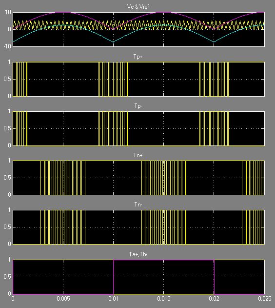

    i'am doing project on multilevel inverter using 8 switches to b gated according to switches sequence.m unable to select pIC controller as i have 4 PWM signals to b generated.there are 4 switches in DC link ( 2 pwm required and other 2 r opposite of generated pwm )and a H-bridge

    bt the prob is der r gating signals with varying duty cycles evrytim the carrier cuts with the reference signal so how its possible to measure the duty cycle of the signals ,to program accordingly .m attaching snapshot of the matlab simulation result.Name:  gating signals.JPG

    May I suggest the PIC16F1824 (14-pin) or PIC16F1828 (20-pin) enhanced processors. Get the data sheet, these chips are awesome for what you're wanting to do! First, they include 4 ECCP channels, allow you to invert outputs, PLUS include a cool feature called Data Signal Modulator (DSM) that would allow you to embed your higher frequency within the slow clock, and even PWM that higher frequency while PWM the slow clock.

    bt the prob is der r gating signals with varying duty cycles evrytim the carrier cuts with the reference signal so how its possible to measure the duty cycle of the signals ,to program accordingly,hardware point of view .m attaching snapshot of the matlab simulation result.Name:  gating signals.JPG

    If you have a fixed period (as shown in the above pic), then measure either on-time or off-time with T1G (or T2G, T3G, etc) and subtract it from the total period. Simple math & you have your DC%.
    If you have a varying period, use "Toggle Mode" to measure a period, then disable Toggle Mode and set up Single-Shot Mode to measure either on or off time. From there it is once again simple math.

    gt ur point,so ur saying taking the reference and carrier signal (20khz) frm ADC n checking for its on and off time??
    cos if you c ma reference its a absolute and i dnt have my negative cycle.so how do i generate my ref n carrier 1st??
    i'am thinking of taking in signals from ADC and den comparing...

    CCPxM3:CCPxM0 (CCPxCON<3:0>) to capture every rising edge of the waveform ??if m considering 18f4431 ...

    actually what i have in my mind is carrier if 20khz il generate tru microcontroller itself by using the up-dwn counters.my oli problem is hw do i generate 50hz ref to compare it with my carrier .

    There are 3 signals that can be modulated; CarrierH, CarrierL, and Modulator. Configuring COMP1 as your modulator signal. Create the 20khz from CCP1, and your 50hz from CCP2. Make one your CARL and the other your CARH. From there look at Figs 23-2 through 23-5 on pages 207-8 of the PIC16F1824_28 data sheet.
