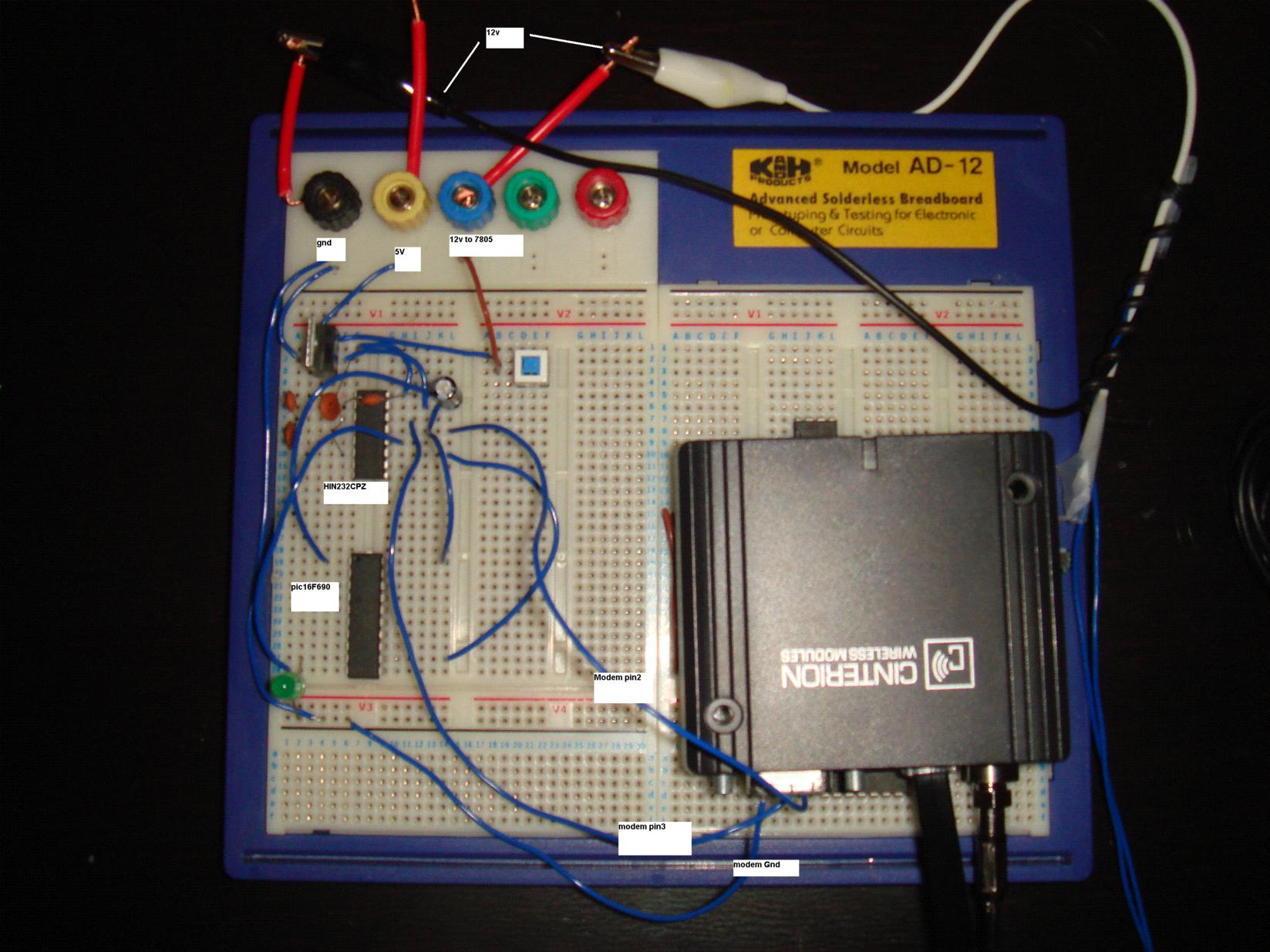

    Thanks. I am trying to send an SMS using TC35i & 16F690. I tried to replicate the schematic at this link: http://techni.caliti.es/blog/2008/12...ontroller.html
    I used the pins 10 & 12 of 16f690 instead of 17 & 18 of 16F873. Hope it will work

    Done it to 84, so now it is transmitting in True mode. NOW the code is entering gosub one as expected BUT not gosub two.
    Changed the code to the following:
    main:
    gosub one
    Serout2 tx,baud,["AT+CMGF=1",13]
    Serin2 rx,baud,5000,main,[wait("OK"),i]
    gosub two
    goto main
    As always code never enters label two which means it is not getting the required response. I attach my setup photo, though not very clear but the schematic is the same except the pin change to 10 & 12 instead of your 17 & 18.
    Last edited by financecatalyst; - 29th September 2009 at 18:15. Reason: Adding more info

    tc35i factory settings for bounrate is 2400 not 9600!
    Becouse you use max its not inverted signal.
    on 2400 and true settings should be 396 if you use 4mhz crystal.

    Tried you way as well. I am using internal oscillator and I put it to 4MHz this time. After that I tried your instructions above but results are the same. Two questions I want to ask you
    First: Why have you used "0" in the instruction serout tx,0,...
    Second: why have you not used serout2 and used just serout & serin2 instead of serin?
    Exclamation

    No Luck still. In the datasheet, portb.5 is Rx & portb.7 is Tx! Why you advised to mark it the other way. Though it's still not working.
    Also 9600 Inverted is NOT 84 (just looked into the PBP manual) it is 16468
    Program is the same as above (With your modifications) i.e. Baud 84 & ports interchanged.

    I think you need to check your modem with hyperterminal to check if it works correctly. If your computer doesn't have a serial port, you can obtain a serial to USB converter (check if compatible with your operating system)
    Al.
    All progress began with an idea
    Red face
    Quote Originally Posted by aratti View Post
    Al.
    I will try that hopefully tomm, and will post my findings. Thank you all for your help upto now.
    Red face
    By the way, can someone tell me the expected voltages across 232 pins and modem Rx & Tx pin. I just have a funny feeling that problem is with the hardware part instead of software.
    Sep 2009
    737
    Default
    Voltages shoul be about +/-10V.

    After all day breaking my head - I have to say Many Thanks to all who have tried to help me and especially you for the code and Aratti (for hardware correction).
    It is working now.

    serout2 tx,baud,["AT+CMGF=1",13]
    Serin2 rx,baud,5000,main,[WAIT("OK")]
    gosub two
    gosub two
    gosub two
    serout2 tx,baud,["AT+CMGS=",34,"+44798XXXXXXXX",34,13]
    Serin2 rx,baud,5000,main,[WAIT(">")]
    PAUSE 500
    SEROUT2 tx,baud,["done",26]
    goto rea
