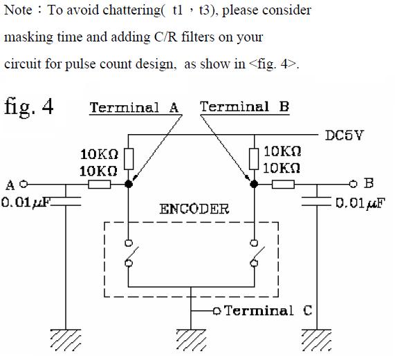

    Hi to all. I want to use a rotary encoder with a 18f252, and i have a lot of troubles. I want to use interupts, so my only solution PORTB or I can use Portc also?
    I made a pcb and I made the connections to PORTC, and I also use a debounce circuit, which I think causes problems. Anyone has a snipset code cause I do not have any expieriance with encoders?
    5v
    __|__
    /10k / 10K
    | A | B ENC
    /10K \
    \ /10K
    PORTC.2 | PORTC.3 |
    ---- ----- 100nF
  39. #79
    3,521
    Default Re: New approach to Rotary Encoder
    Hello,
    On the 18F252 there's no interrupt capabillity on PortC.
    Your schematic really doesn't show up that good here but it LOOKS like you have a 10k from 5V to the "top" of each of the switches in the encoders, then the other side of each switch thru another 10k to the input with a 100nF cap to GND, is that correct?
    If the above is not correct please post a proper schematic for us to see.
    If the above IS correct then it's not a very good hardware design IMHO. When the switch in the ecoder is closed you have 2*10k in series to the input, decoupled by a 100nF cap, this may be fine. But when the switch is open there's no path for the capacitor to discharge except thru the fairly high input impedance of the pin. In effect the pin floats which is not a good thing for inputs.
  40. #80

    I used both 0.01uF and 0.1uF caps to improve debounce and wired the C pin straight to Vss (only check wiper A and B). This is the recommended circuit by the manufacturer:
    Name:  Encoder debounce.JPG
