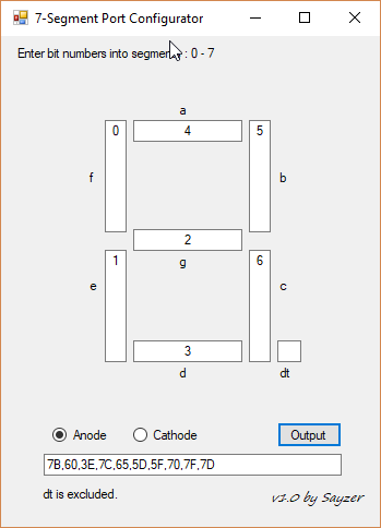

I had made something like this a few years ago.
This is V1.0.
V2.0 makes detailed output.
