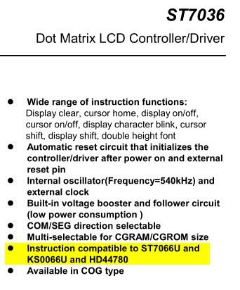

According to the controller's datasheet, ST7036 is instruction compatible with HD44780. But if I try to use values like $C0 (beginning of second line) or $94 (beginning of third line), it won't work.

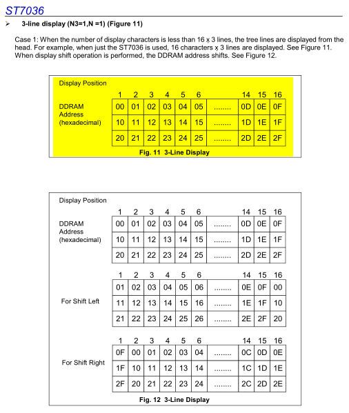

Attachment 8284
Looking again in the ST7036's datasheet, page 20, one can read this:
Attachment 8287
So, as it is now in my code, I used $10 and $20 values...but it still doesn't work.
Anyone an idea where I'm wrong?

Set DDRAMAddress 1 AC6 AC5 AC4 AC3 AC2 AC1 AC0
try this , looks like you need to set bit 7 and add dram ADDRESS
LCDOUT $FE, 1 ' clear display
LCDOUT $FE, 130,"1" ' beginning of line 1
LCDOUT $FE,$90,"2" ' beginning of line 2
LCDOUT $FE,$a0,"3" ' beginning of line 3
EA-DOGM-163 with ST7036 LCD controller - can't find address for line 2 and 3
Thanks a lot Richard,
It works now as expected with this code:
LCDOUT $FE, 2,"1" ' beginning of line 1
LCDOUT $FE,$A0,"3" ' beginning of line 3
May I kindly ask you to explain how you found out those values please?
Hum...I don't get this; what do you mean?
Re: EA-DOGM-163 with ST7036 LCD controller - can't find address for line 2 and 3
bit 7 = 128 =$80
hex dec
row1 dram address = 0 0 128 + 0 = 128 = $80
row2 dram address = $10 16 128 +16 = 144 = $90
row3 dram address = $20 32 128 +32 = 160 = $A0
Thank you Richard.
Obviously, I have some lacks in basic knowledge of "display's controller" science since I can't still correlate your information and how I should understand it affects the cursor's position on the display :frown:
I stop bothering you now; you gave me the solution and I thank you very much again for it ;)
"DDRAM" corresponds to a character position on display (but...)
Quote:
The controller contains n bytes of Display Data Random Access Memory which is usually referred to as DDRAM.
Each of these DDRAM memory addresses corresponds to a character position on an attached display, but the specific position varies depending on the configuration of that display.
This is what I was missing and this info can be found here :smile:
