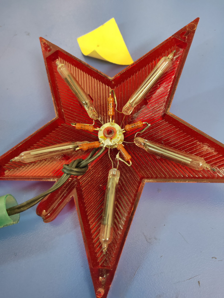

This circuit will be used to upgrade old Christmas tree decoration, shaped like a red star :)
Attachment 9102
