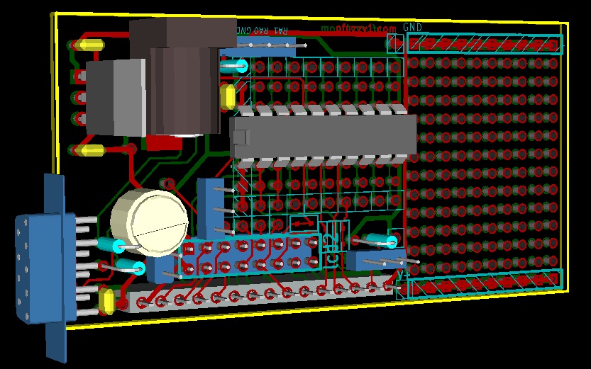

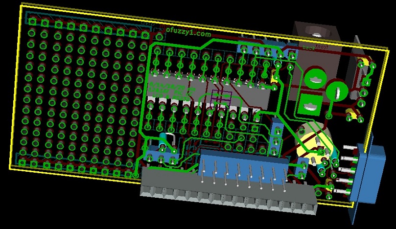

Okay, so now I can use the layout for my PCB without cutting.
PWM on the Backlight led will now work. mr green
Board specs:
1.5" x 1" prototyping area with a V+ & GND bus on the ends
RS-232 both 5v & full +/-12v via DB9
Use the PICkIT "PROG" connector to also talk to it via rs232-TTL uses RA3 (in) and RA0 (out)
LCD connectors for both styles of HD44780 Modules -- 1x16 & 2x8 on 0.1 centers
Laid out for the 14pin PIC to control the LCD so the remaining pins can be used for fun things. Even the 14pin Pic has 2 pins open.
Thanks for the help! :)
pcb schematic, layout and 3d by KICAD [free]
top view
PCB (c)2011 Ofuzzy1.com
http://www.picbasic.co.uk/forum/atta...0&d=1302421397
http://www.picbasic.co.uk/forum/atta...1&d=1302421397
Re: PWM on pic16f1825 issues - 1.pbp v2.60c bug found, fix shown, 2.CCP2 on ALT pin p
ofuzzy1 , Your layout look pretty good but I notice one thing. You would have to use a cable for the ICSP because it is too close to the coaxial power connector. I always lay my boards out so that you can plug the PicKit2 into them directly. Just my preference I pupose. I less cable to loose....
