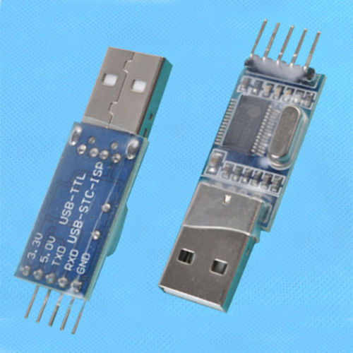

Which PIC are you using? I measured a PL2303 module and the RXD pin (4 in your drawing) is floating at 1.8V idle, and not able to supply much current. As an input, it shouldn't be able to supply any, but some input designs allow a little in unusual conditions. To power the PIC through the protection diode, the PIC would need to operate down to 1.2 V or less, and would need to draw very little current. So I want to check the spec sheet for you. Maybe you actually have an out of spec device. The TXD pin (3 on your drawing) sits at 4.5 V and is designed to supply current, so it should be the only culprit. D2 fixes that.
The circuit you have on the USB_ON pin will work, but might be a bit more traditional if the gate went to the module and the drain went to the PIC VDD. This would allow you to use it with VDD at any (reasonable) voltage without having to change the circuit.
Re: Usb to ttl modules - connection to pics at 3.3v
Hi charthe pl2303 ttl module has TX, RX led with a 1.5k resistor on each signal , which is pulling the line high , looking at the pcb
the module is one of these
Attachment 7737
there are 3 pic chips i am testing this usb modules on - 18f67k22 ,18f87k22, 18f46k80 , the measurments so far are using the 18f67k22
there are 3 usb - ttl modules to be tested and checked cp2102 module , pl2303 module , ch340G module
i am still trying to get the correct cct for each of ttl modules / boards i am using for the test
But from a quick look on the net and the boards them selves , there is wide number variations and ways they make the boards , some have leds on the TX,RX line , with different values of resistors inline on those lines others do not
i want to ensure that no mater what ttl usb module of the 3 i am testing , the PIC is not powered or effected by the different possible TTL modules
