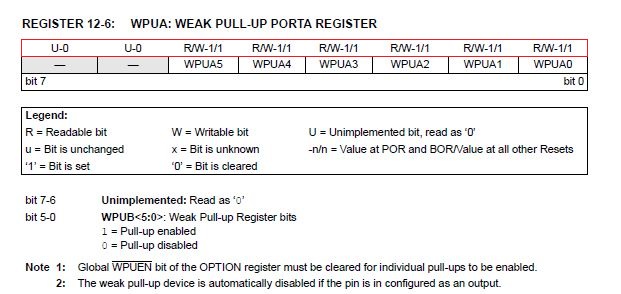

Nothing whacky there.
The WPUA register defaults to %00111111 on power-up.
If you do WPUA.3 = 1
nothing changes, because that bit is already a 1.
You have to disable pull-ups on the pins you don't want pulled-up.
The numbers over each bit show the POR/BOR defaults.

For once you' re wrong (& I've got you on a minor technicality!) - there was something whacky - ME! :)
I guess (me aside) the other whacky thing was even with weak pullups enabled ...my ADC pin still functioned.....albeit only down to a reading of 008 (whenever I've set an ADC pin wrong prior...I've had very "something oviously wrong with my config" type results ...this one was more obscure!)
