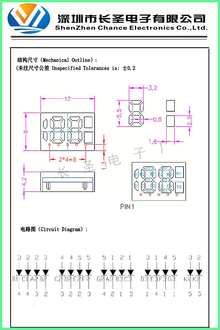

Here is the pinout of the LED matrix.
Attachment 9210
